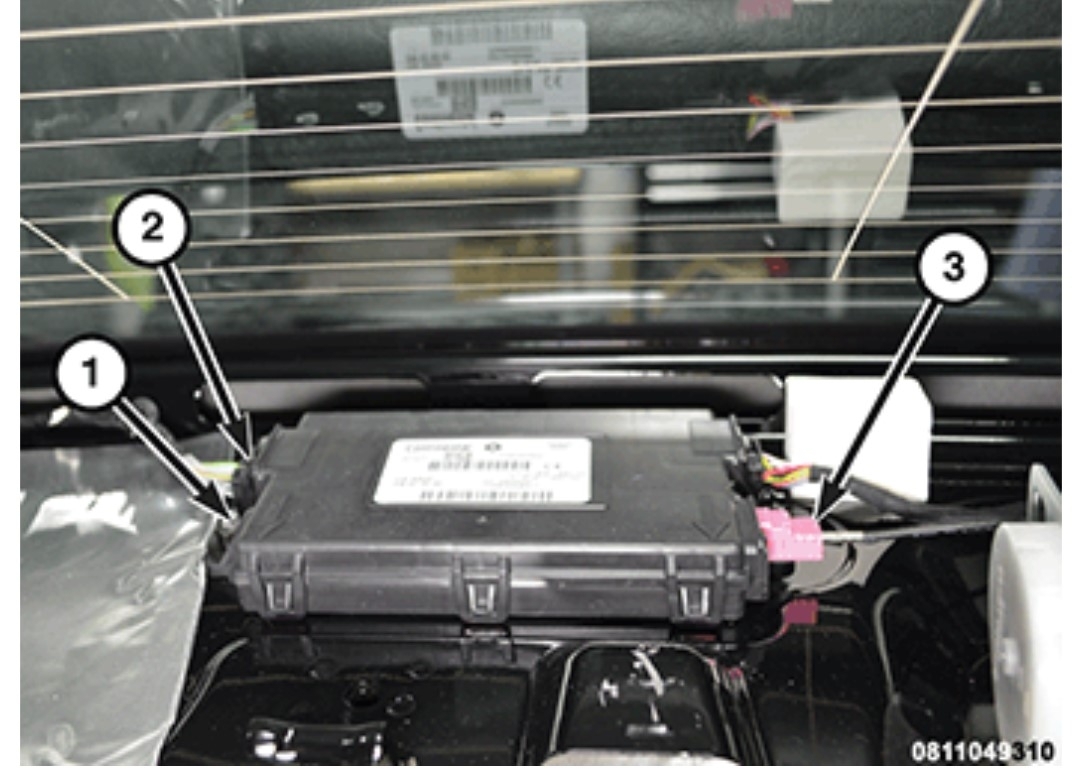

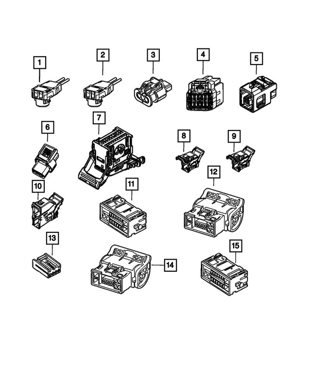

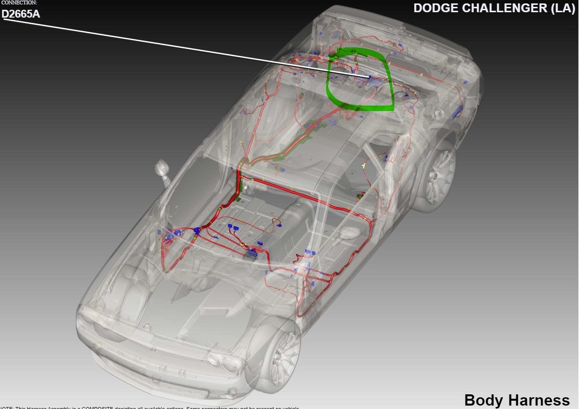

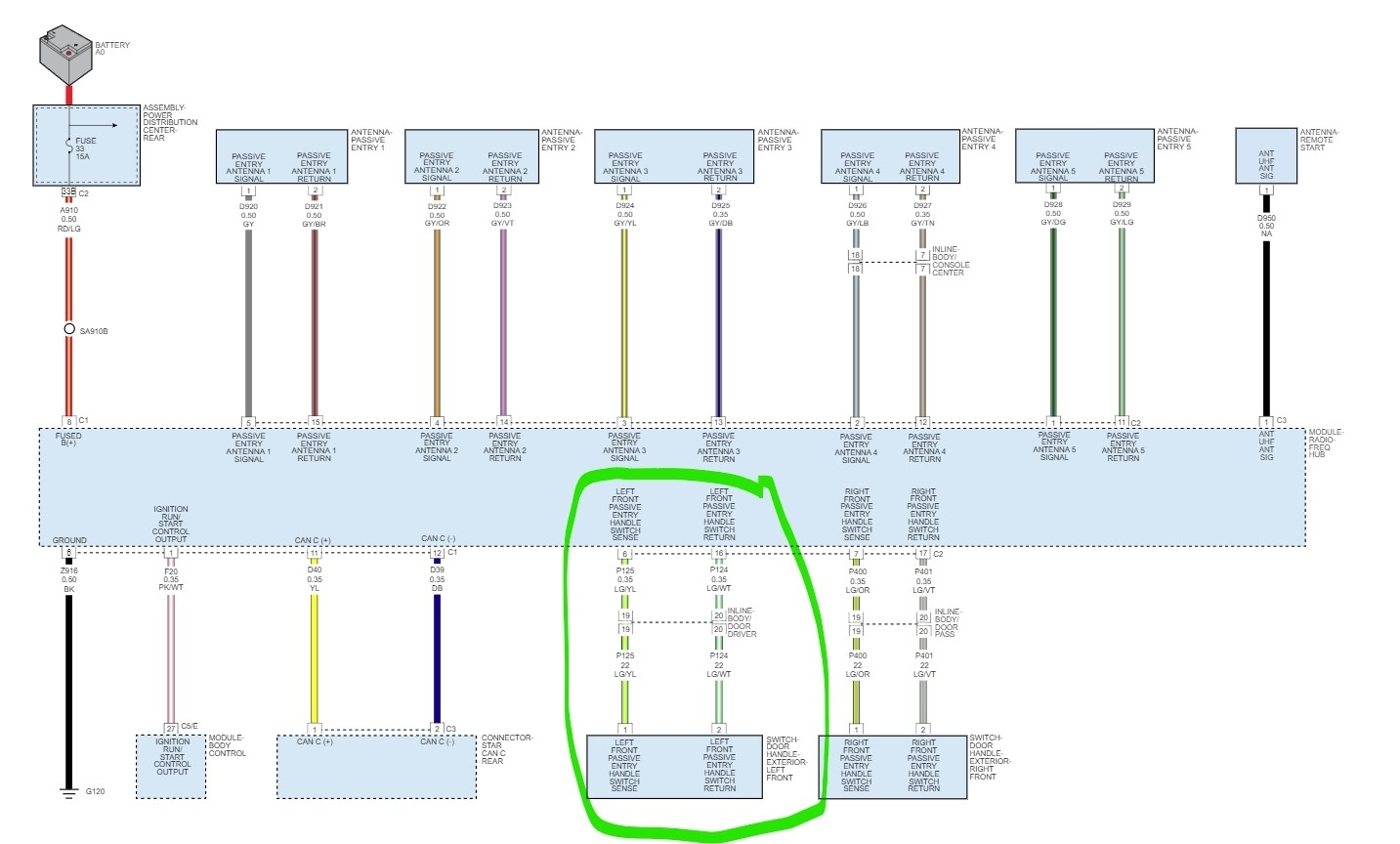

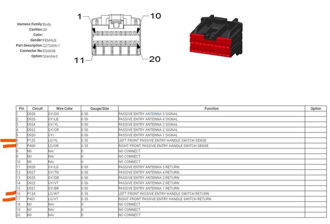

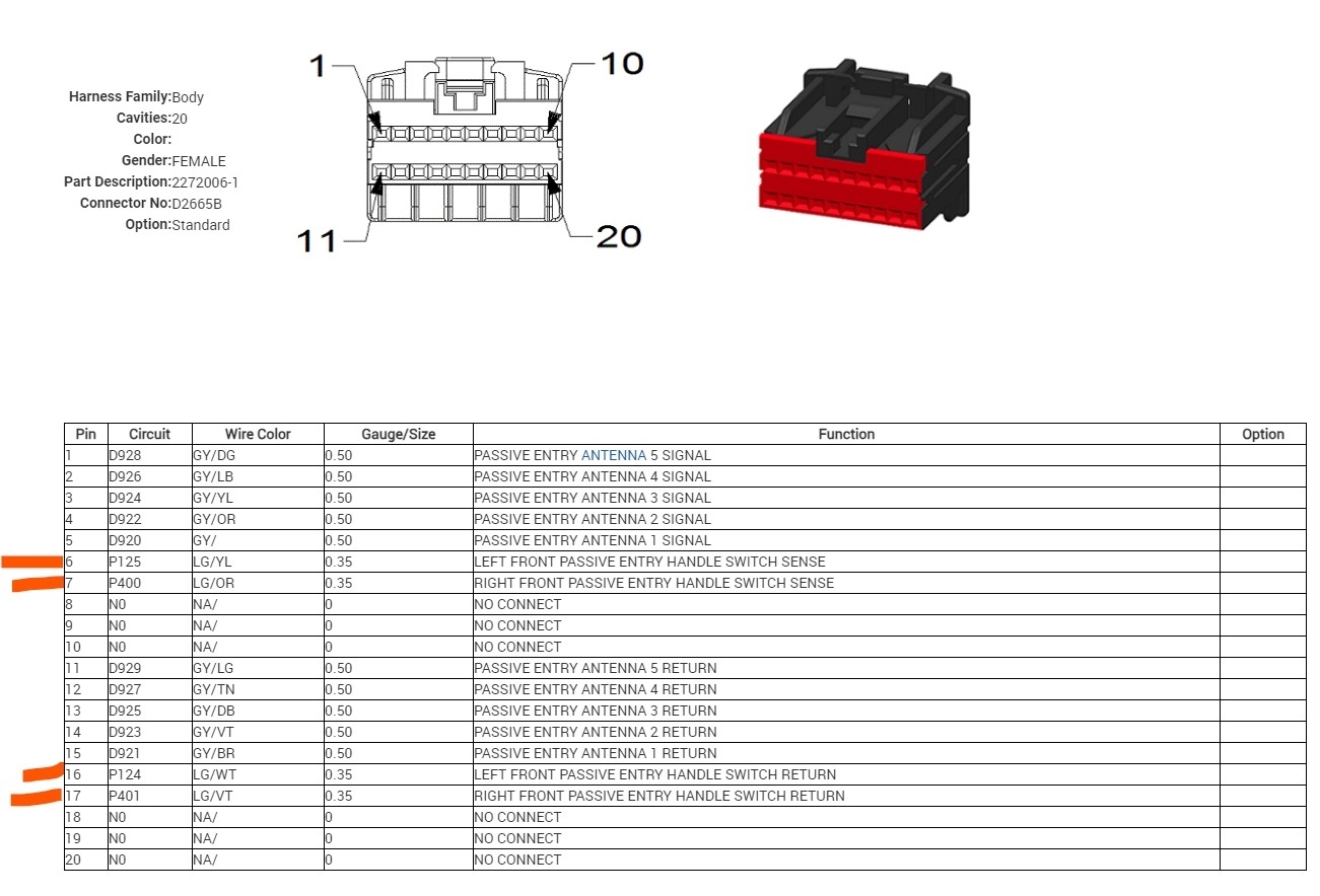

so, I ripped out the wiring on my exterior front door handle. It’s the wire that makes the keyless entry work. It’s that button on the door handle that makes it where you can lock it basically. I got a new door handle and wires for it but it’s still not locking by button. Locking it by the key fob it’s fine but the button still doesn’t work. I had my mechanic install it and everything. I have the diagnostic report Dodge said and I got those parts but still nothing.
