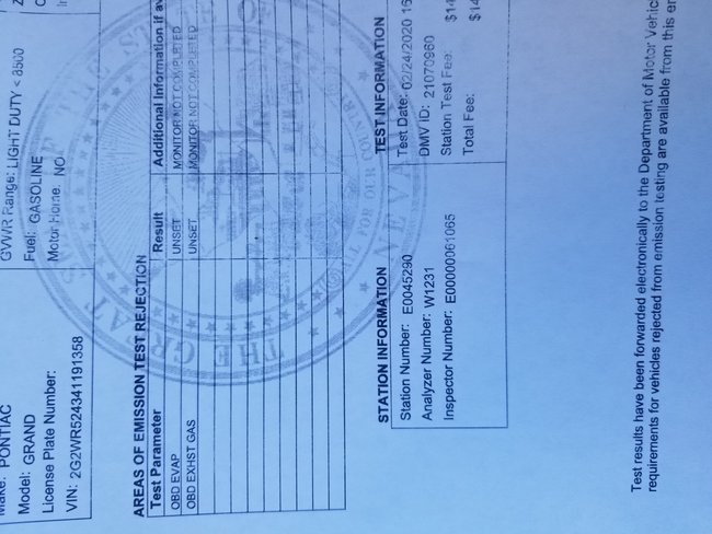

I have obd evap and obd exhaust gas monitor not completed.

Gas monitor? Can you post a picture of what you see? There is no gas monitor.

Here's the photo:

Okay, do the drive cycle I suggested. That should set the catalytic converter monitor.
The evap monitor will run after an 8-hour sit overnight. Start in the morning and drive it for about 5 miles and then recheck the monitor.
