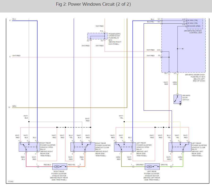

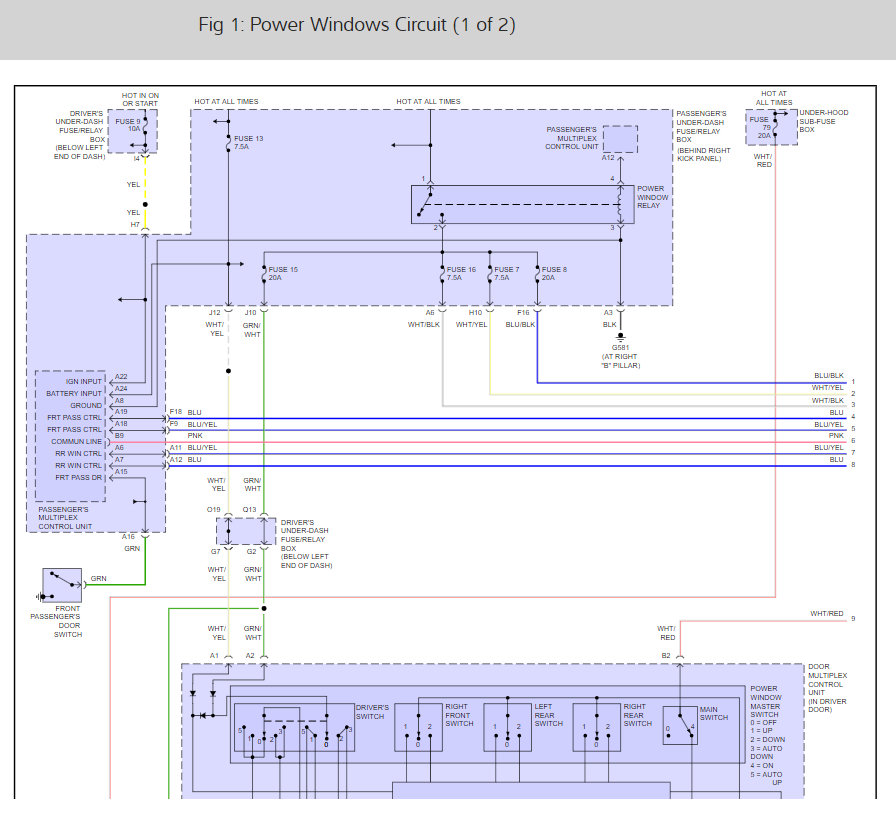

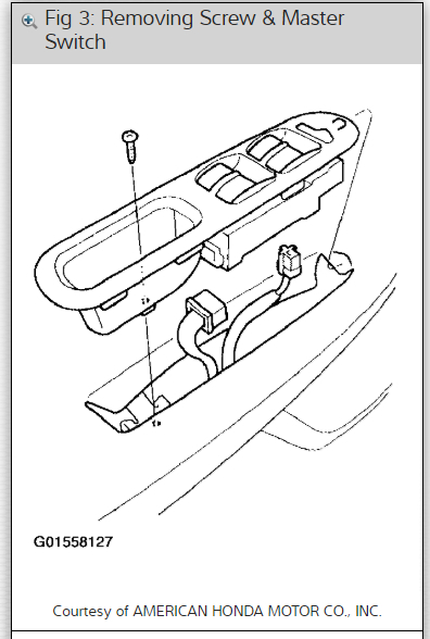

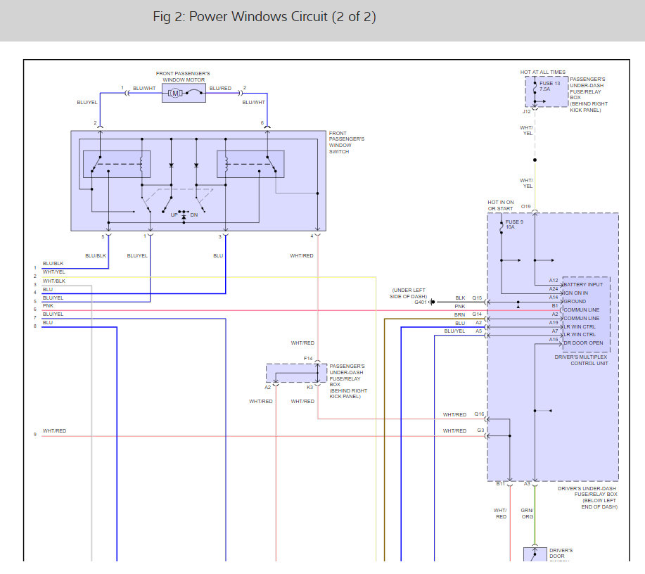

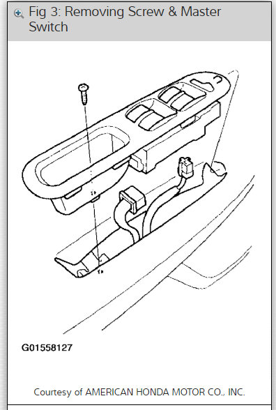

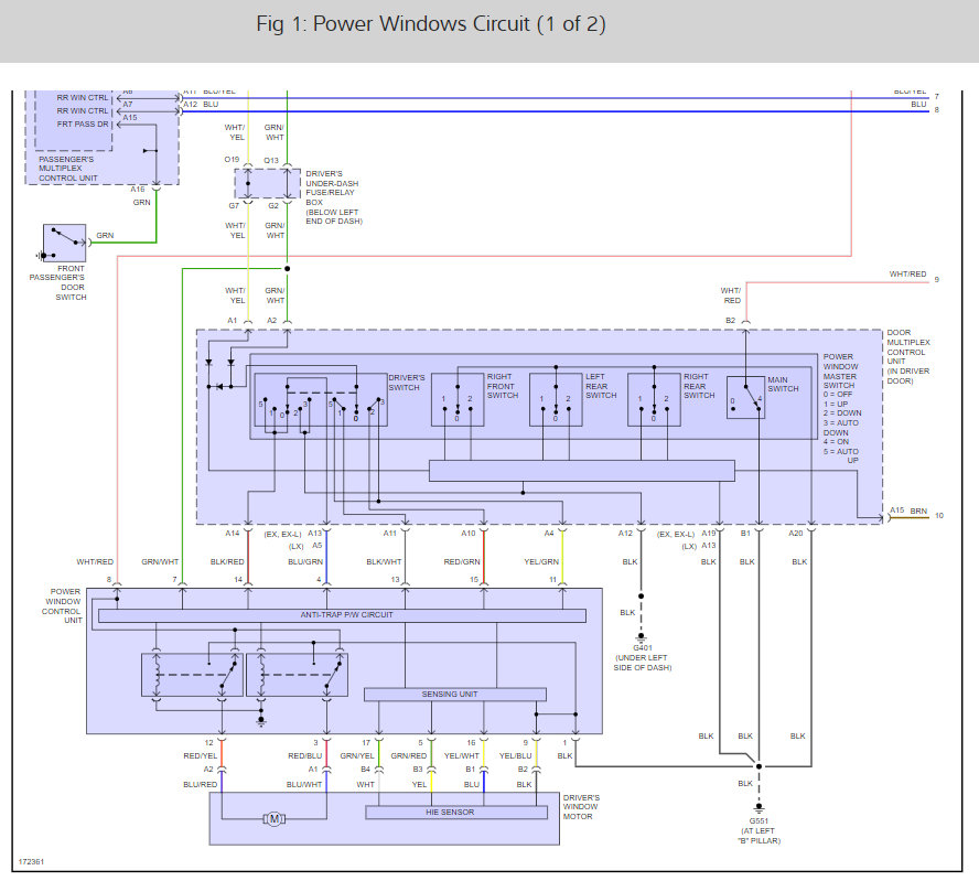

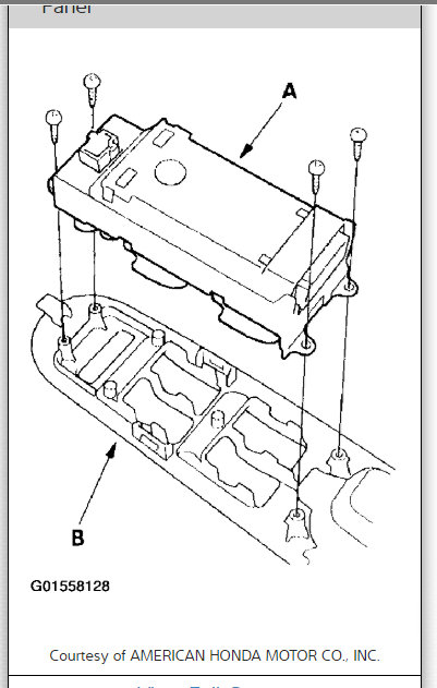

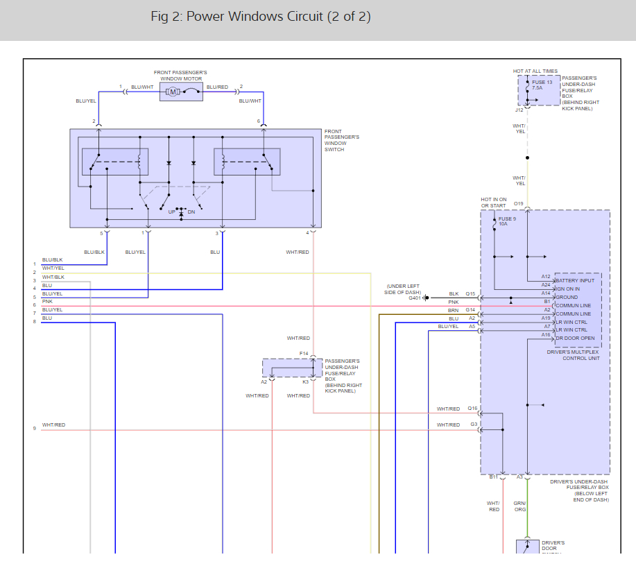

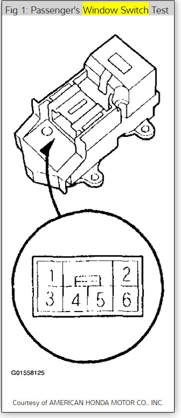

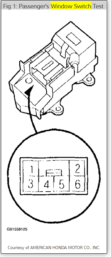

This sounds like the main window switch is out because the controls for the passengers side switch run through the main switch. To be sure here is a guide to help you test for power and the wiring diagrams so you can see how the system works:
https://www.2carpros.com/articles/electric-window-repair
Check out the diagrams (below). Please let us know what you find.
