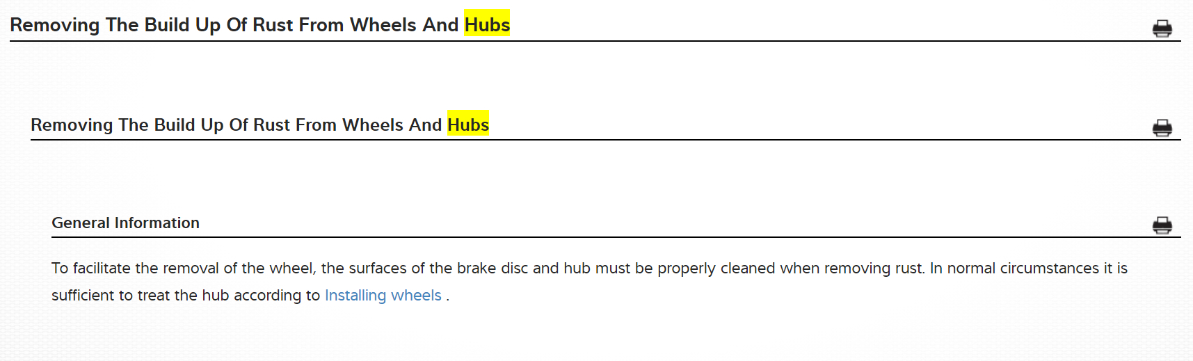

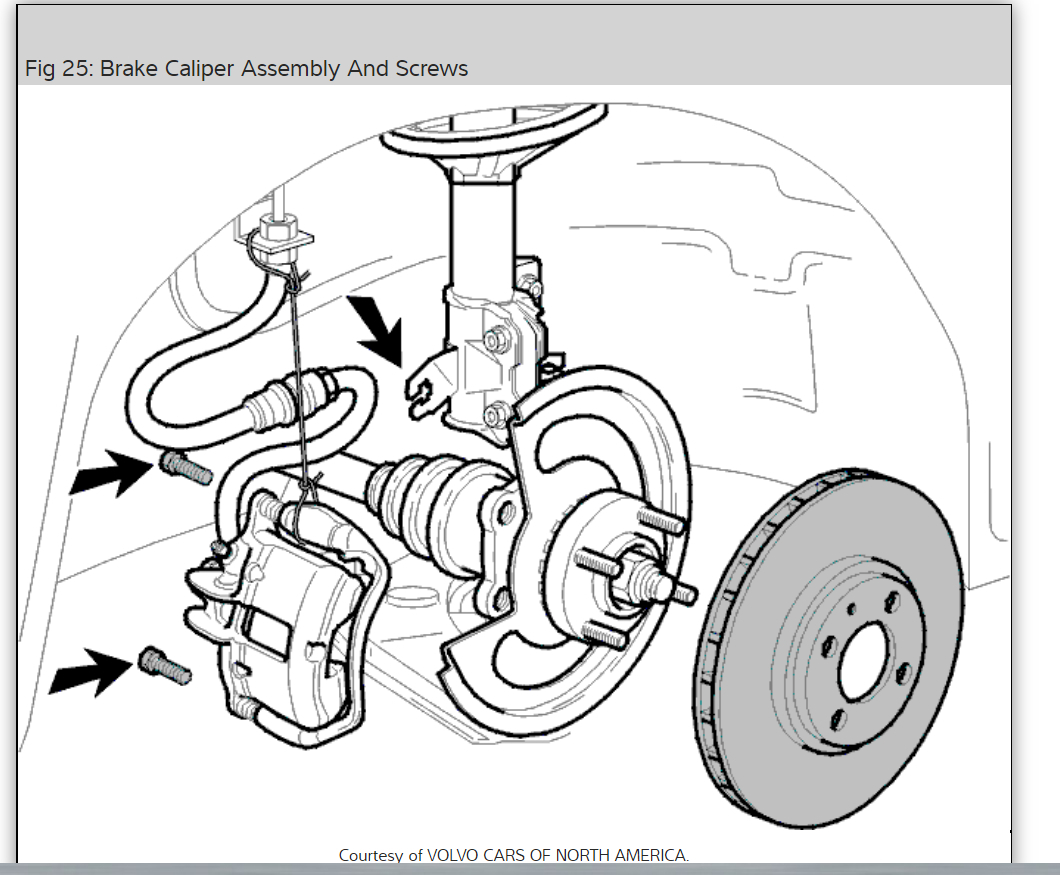

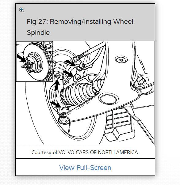

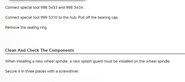

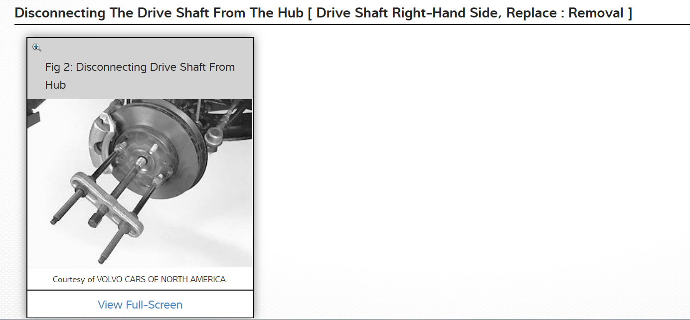

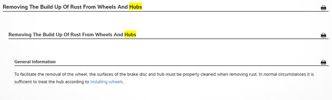

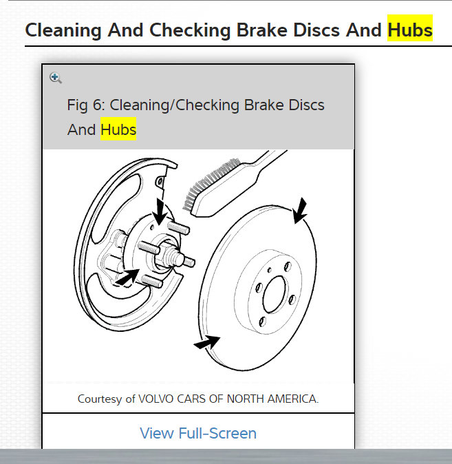

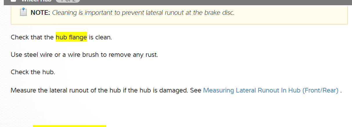

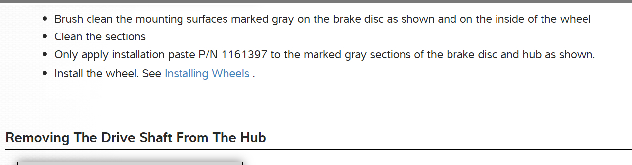

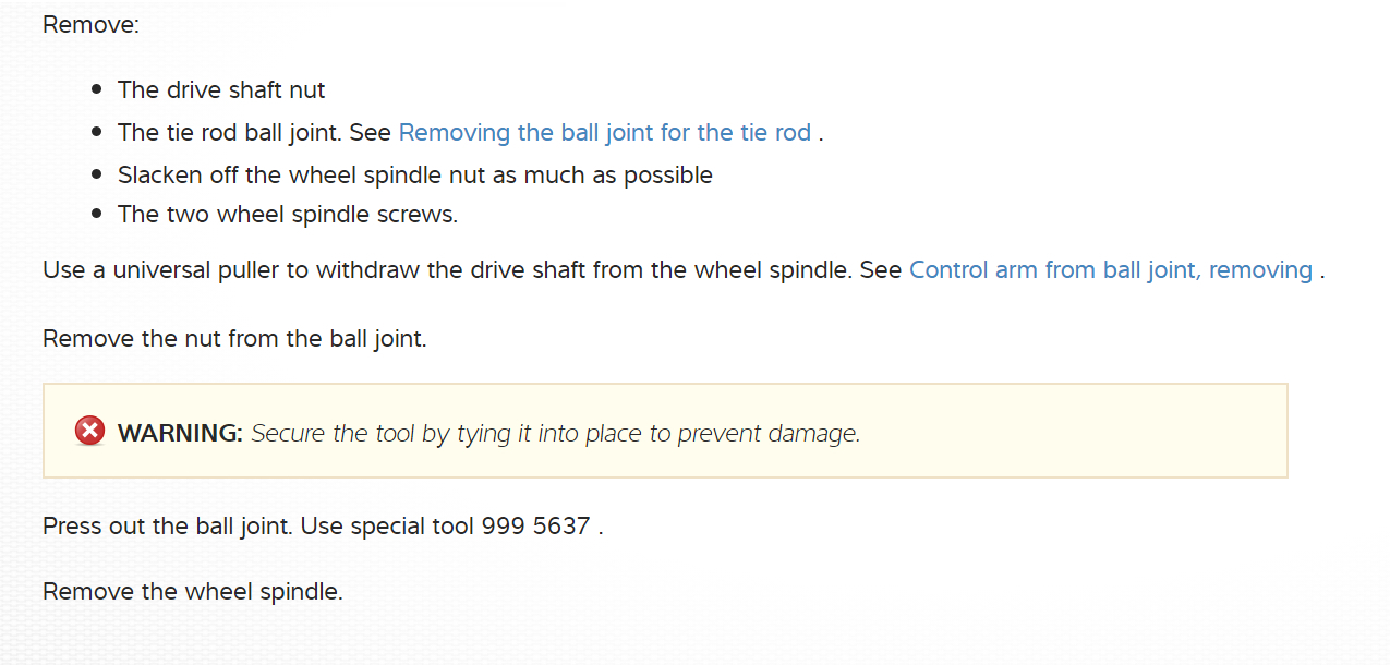

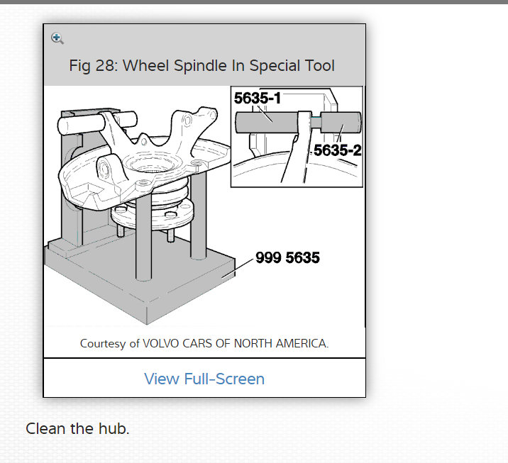

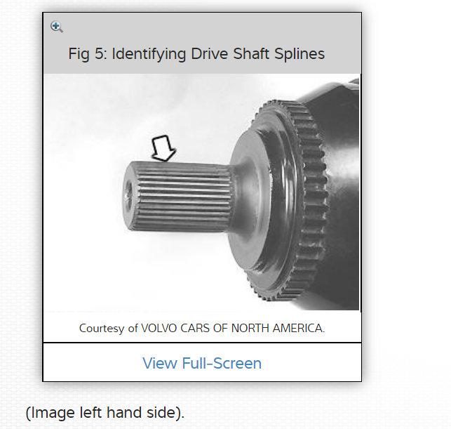

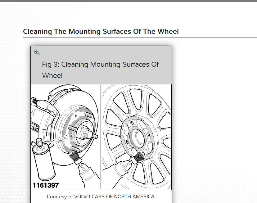

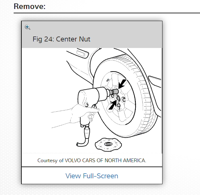

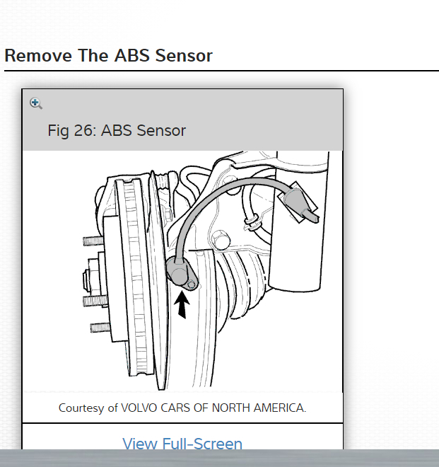

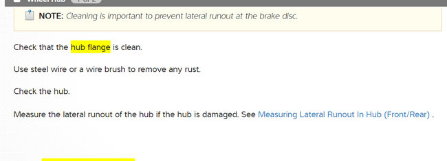

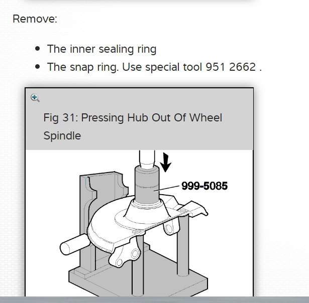

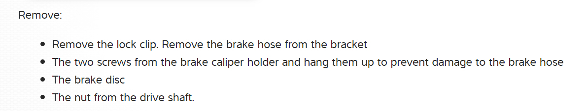

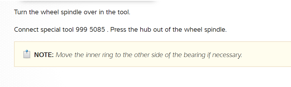

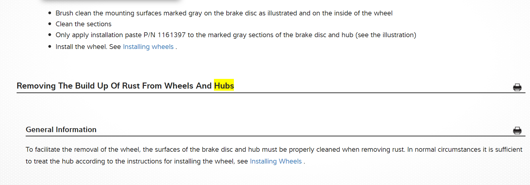

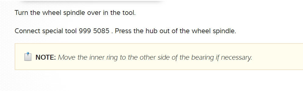

are the wheel hub bearings pressed in this model? Do I need to disassemble the front end to get it out?
Mar 9, 2019 at 9:35 AM
SCGRANTURISMO
  • 4,897 POSTS

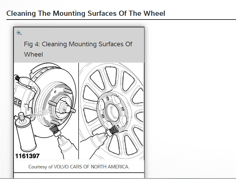

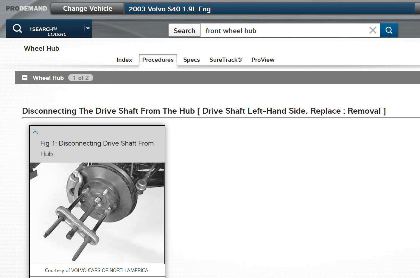

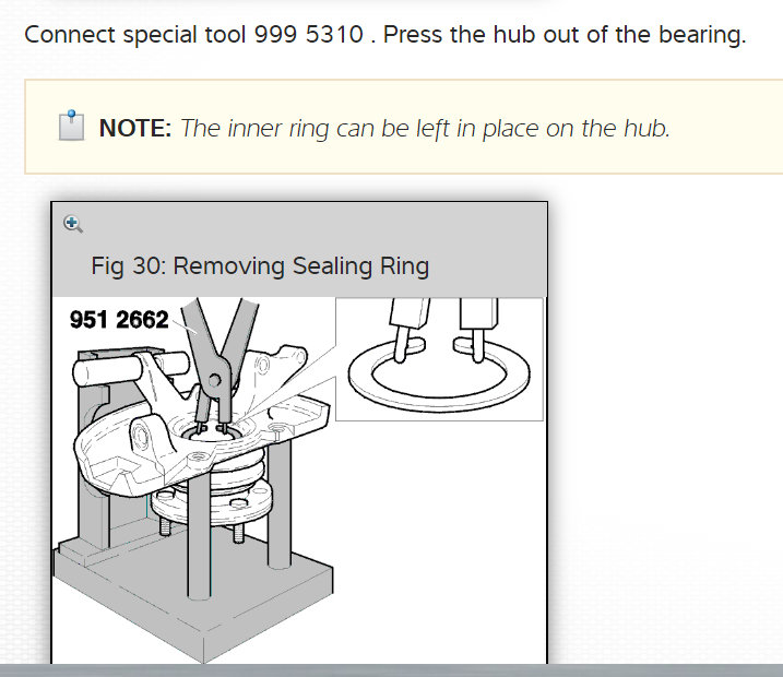

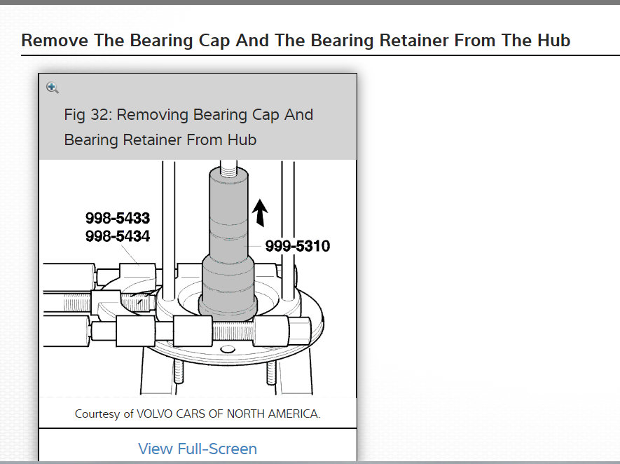

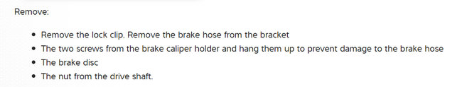

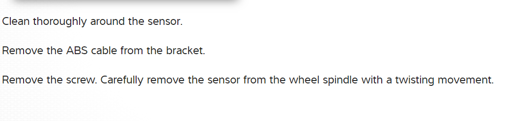

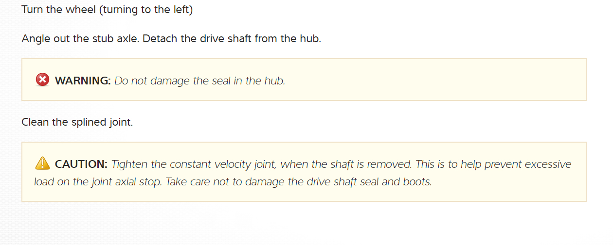

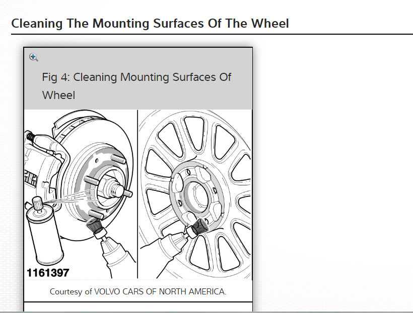

I have included the information you requested in the diagrams down below. I help that this helps.
Thanks,
Alex

Is this a pressed bearing?
Mar 9, 2019 at 3:18 PM (Merged)
SCGRANTURISMO
  • 4,897 POSTS
Yes, but you can buy the whole hub assembly very reasonably on line. I just replaced my two front hub assemblies on my Ford Mustang and got each one for about $20.00 online. The bearing already comes pressed in, all's you have to do is pack it with grease. Yours, being a division of Ford, should be in the same ballpark. Try Ebay or Amazon.
Thanks,
Alex
