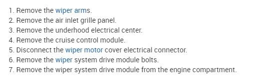

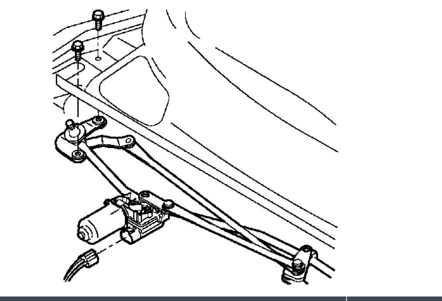

1. Remove wiper module.

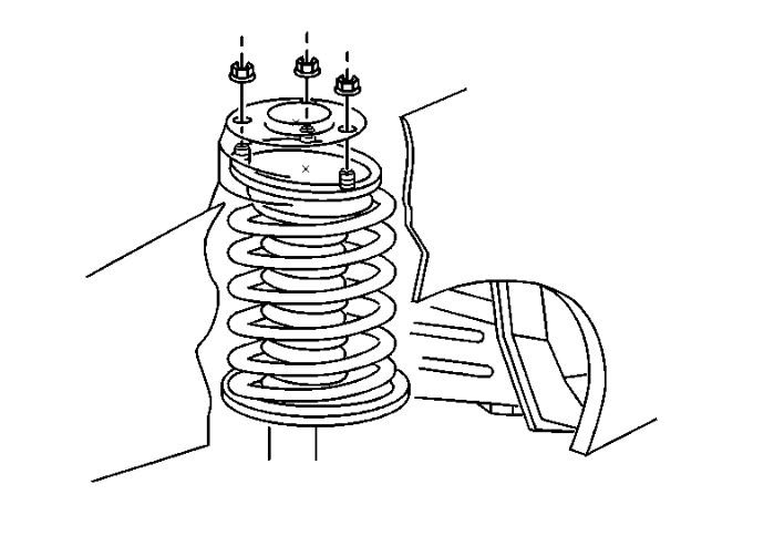

2. Remove the upper strut mounting nuts.

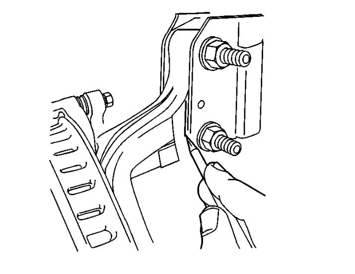

5. Scribe the strut to the steering knuckle.

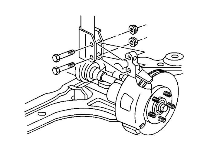

6. Remove the strut lower mounting bolts and nuts.
7. Remove the strut.

2. Install the strut upper nuts.
Tighten the strut upper nuts to 30 Nm (22 ft. lbs.).
3. Install the wiper module refer to Wiper Motor Module Replacement.

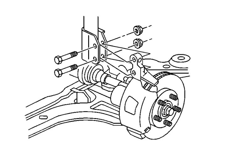

4. Install the strut lower bolts and nuts. Hand tighten only.
