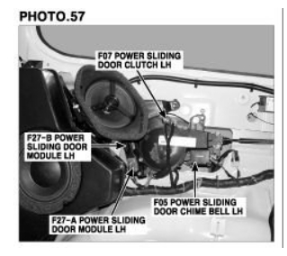

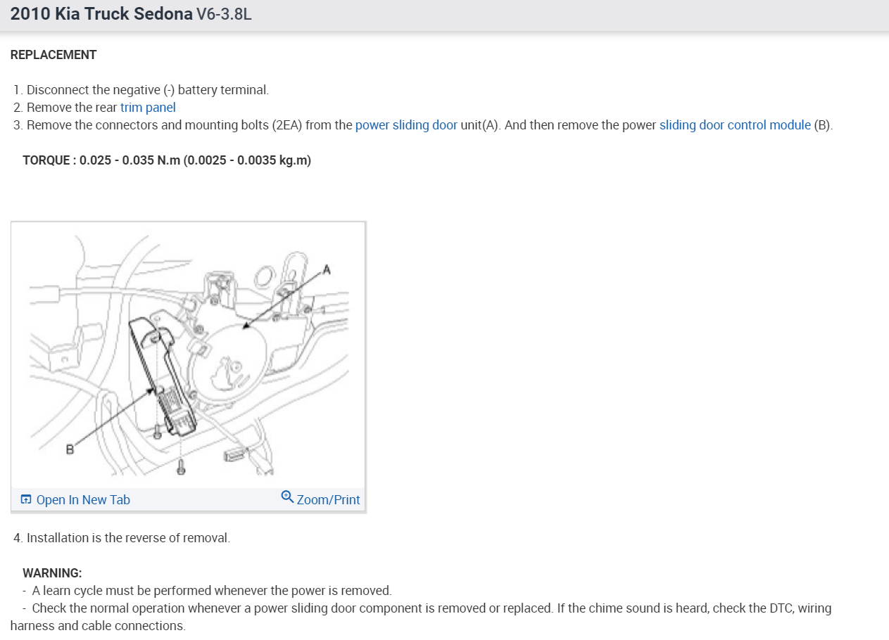

The door opens and closes properly using remote and from the console. It does not respond to signal from the outside door handle to open electrically, just manually. Kia service told me there are no fuses in that circuit and suggested a sensor reflecting the door state may be bad. Can you help?
