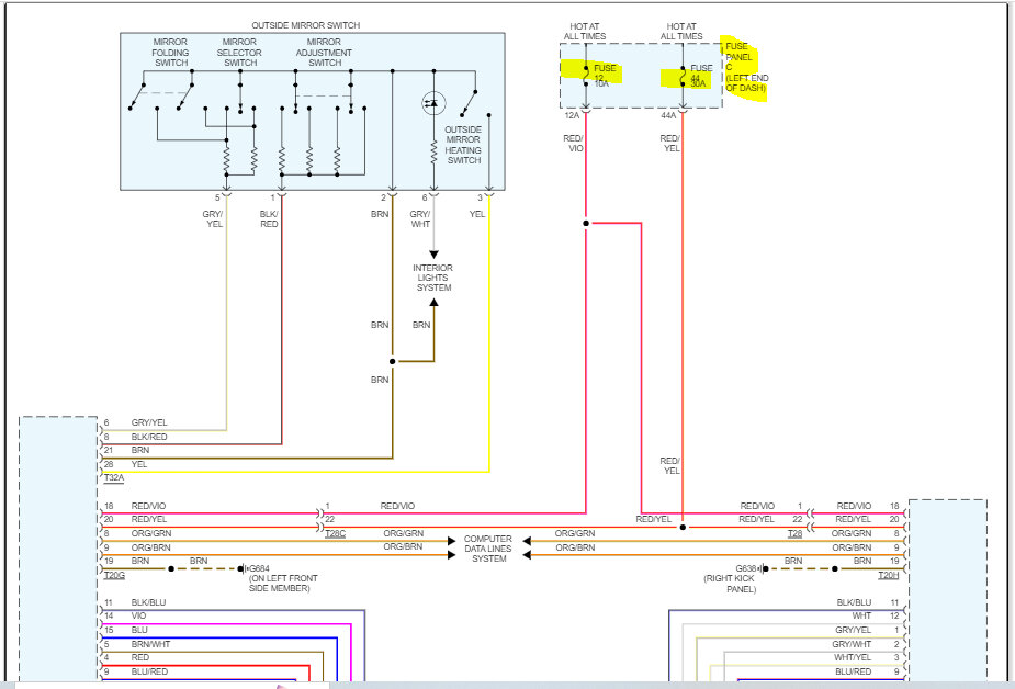

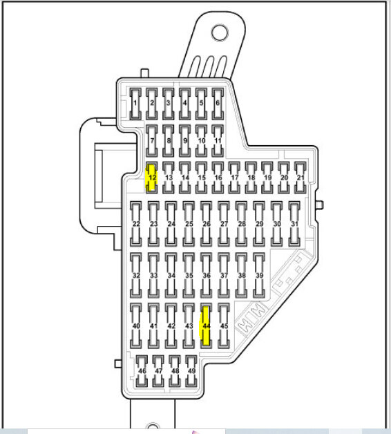

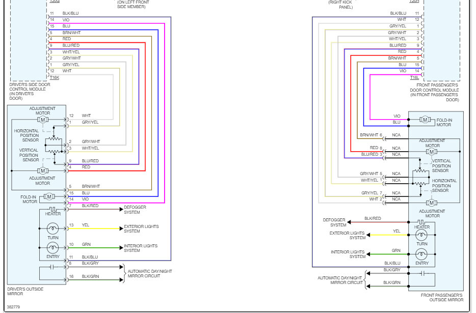

I'm not yet sure if the mirror is heated or not, and won't know until tomorrow when the woman will hopefully bring the car back in. However, i just got a call from her (twice on a Sunday after reassuring her we would be calling her in the morning) saying both mirrors are not operating from the controls at the driver's side panel.
We only used a hose to rinse off the soap, including after the mirror glass fell off. Could the water somehow have shorted out the electric motors?
Any ideas on how to trouble shoot without taking it to VW?
Thanks for any ideas.
