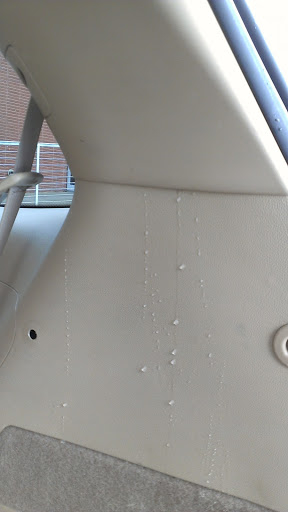

Passenger side front window pillar and seat belt pillar soaked
2008 BUICK ENCLAVE
120,000 MILES • 3.6L • 6 CYL • 4WD • AUTOMATIC
CORY2427
  • 293 POSTS
I’ve dropped headliner nothing wrong with drain tubes or anything not even the top rails .took it to the body shop they can’t figure out where the water is coming in at. I’m lost. any ideas?
