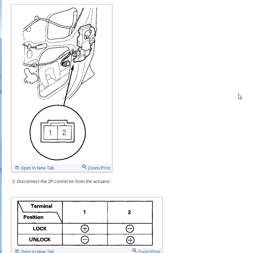

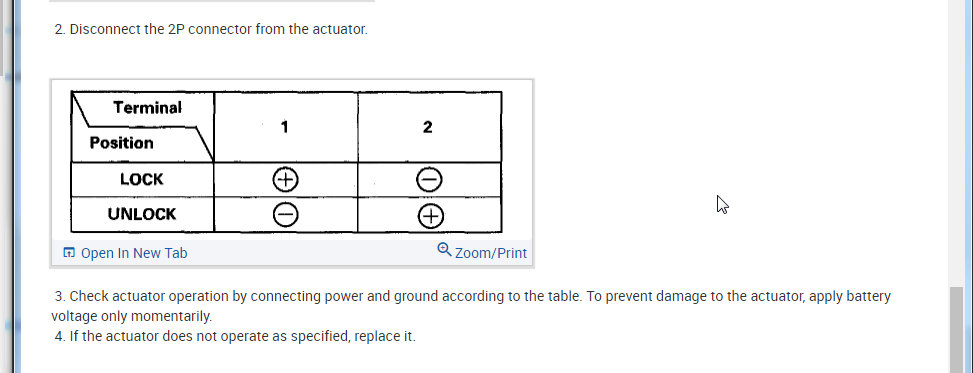

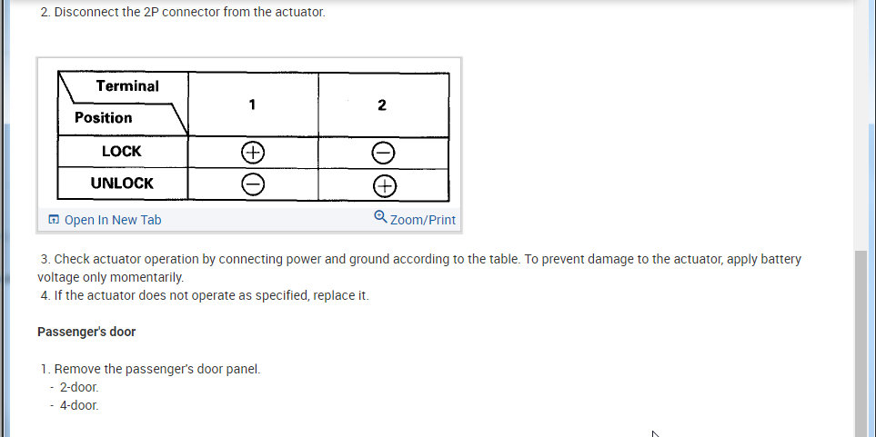

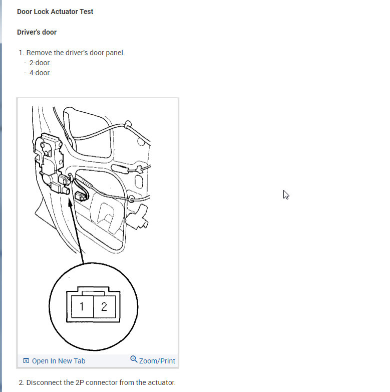

As for the lock not working then you are probably correct that the actuator is the issue.

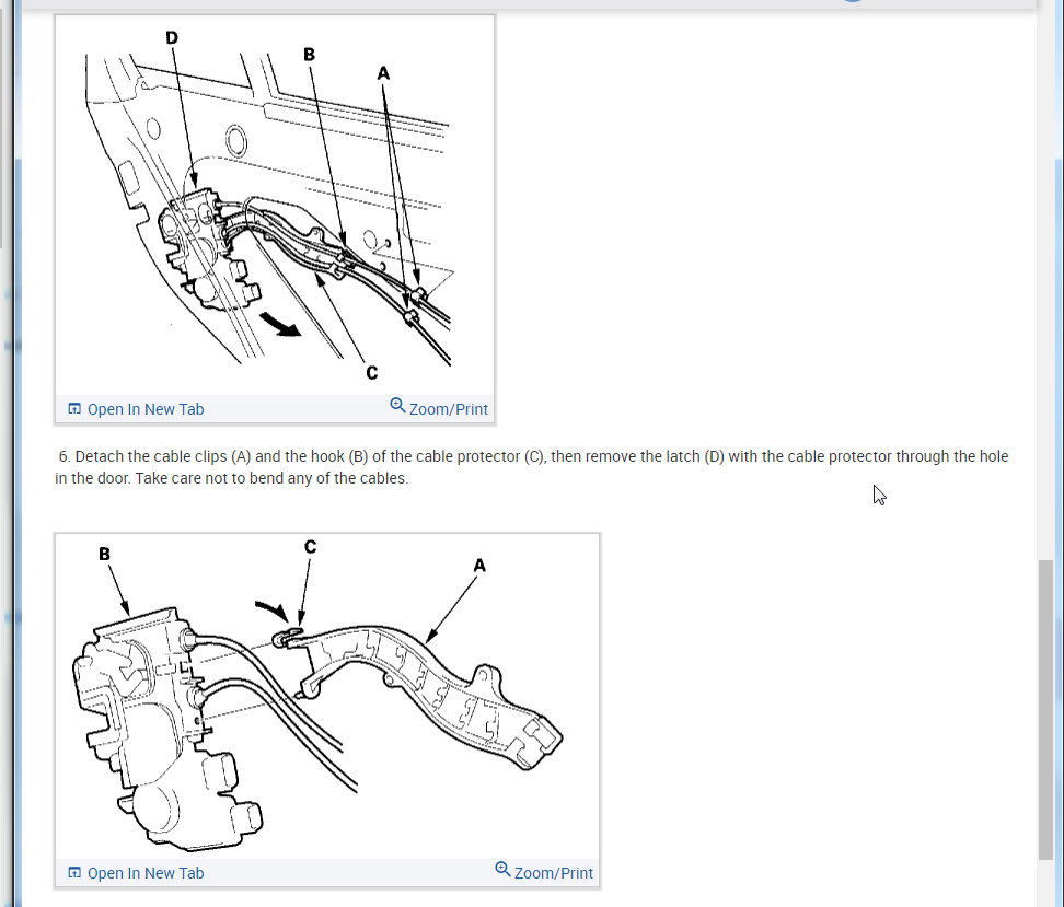

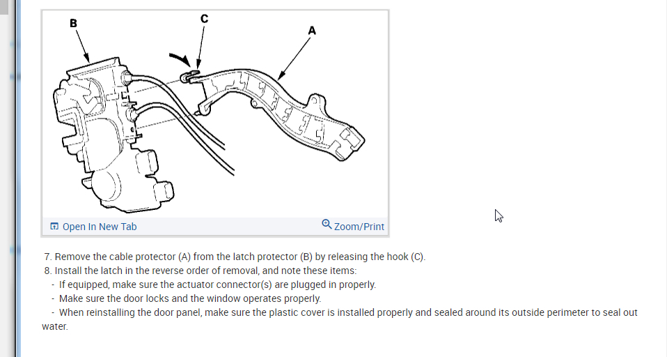

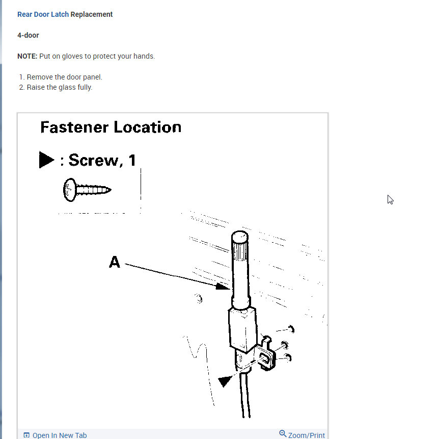

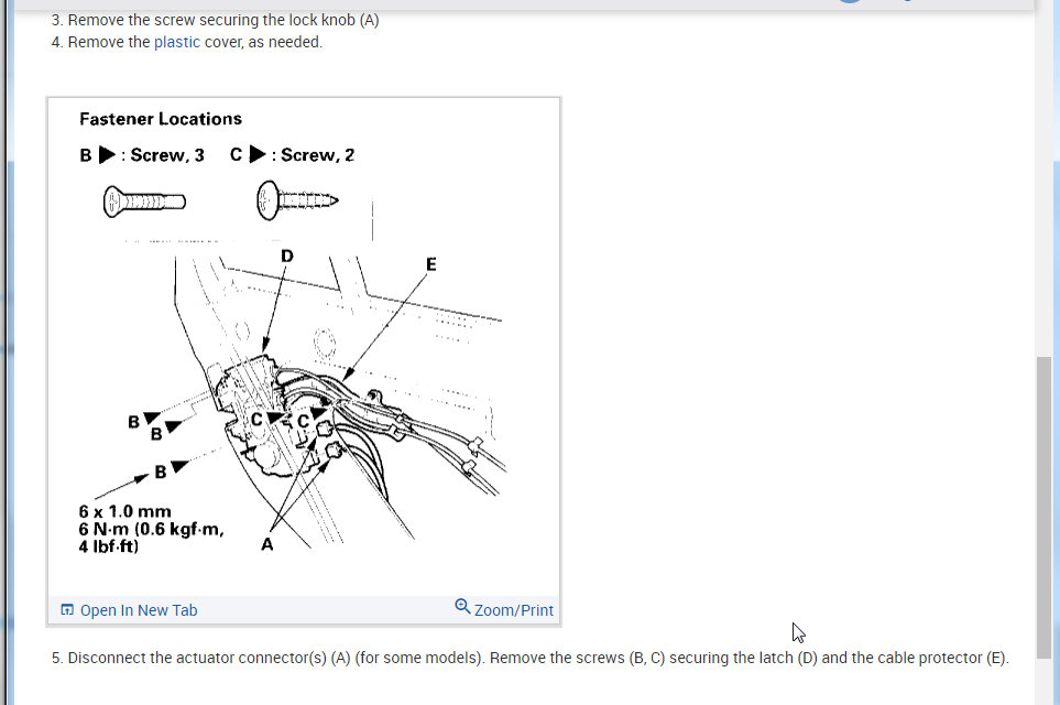

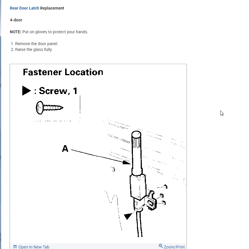

So I attached the info from the manual below on how to access the latch and test the actuator. Let's see if the handles (inside and outside) are moving the latch.
Let me know what you find. Thanks
