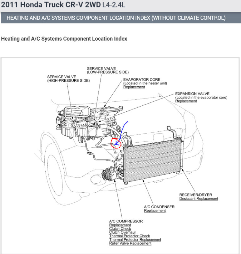

It sounds like the evaporator drain is clogged and the condensation is draining inside of the vehicle instead of to the outside.
That drain is located on the passenger side firewall (in the engine bay). It is located low on the firewall closer to the center. It should be a rubber hose that drains the water. Check for any dirt or debris blocking the drain.
I have attached a diagram that can help you locate the drain.
