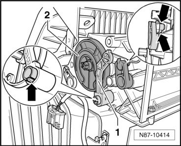

- The Fresh air/recirculating air/back pressure door motor (V425) with fresh air/recirculating air/back pressure door motor position sensor (G644) => [ Air Flow Door Motor V71 with Back Pressure Door Motor Position Sensor G113 ] See: Air Door Actuator / Motor, HVAC > Removal and Replacement > Air Flow Door Motor V71 with Back Pressure Door Motor Position Sensor G113.
- Open the retainers - arrows - on the adjusting lever - 1 -.
pic 1
- Remove the adjusting lever from the curved washer.
- Remove the curved washer - 2 - from the air intake housing.

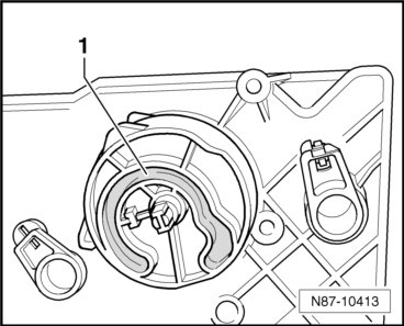

When installing the curved washer, make sure the guide pin for the air flow door adjusting lever is seated in the groove.
- Install the curved washer - 1 - on the air intake housing.
pic 2
Make sure the guide pin for the recirculation air door adjusting lever is seated in the curved washer groove.
- Mount and latch the recirculation air door adjusting lever.
