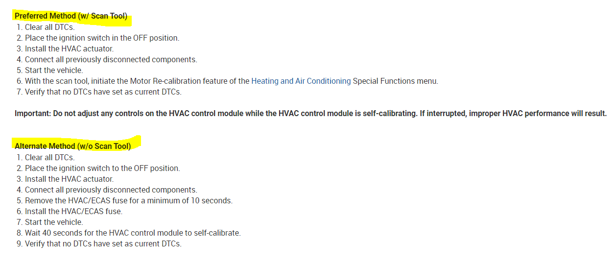

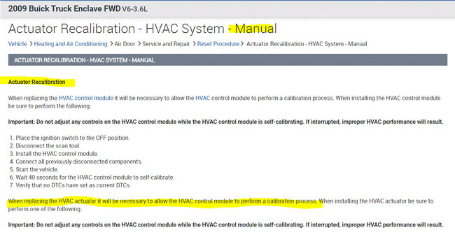

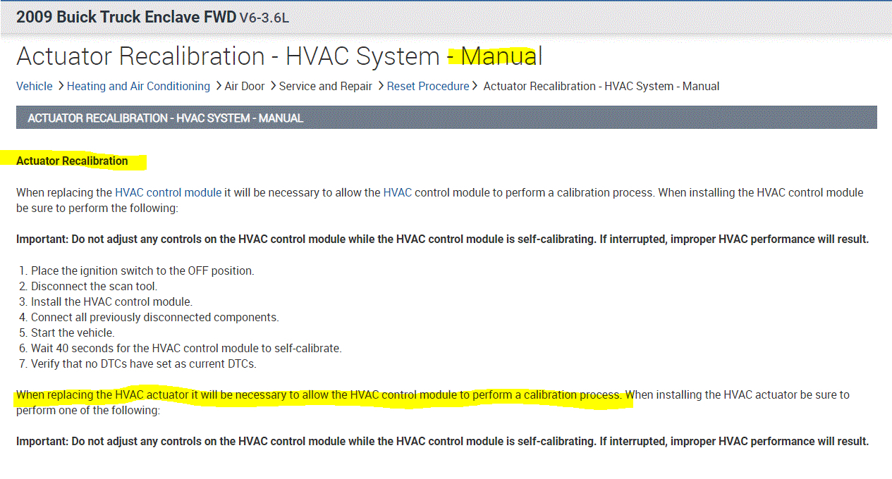

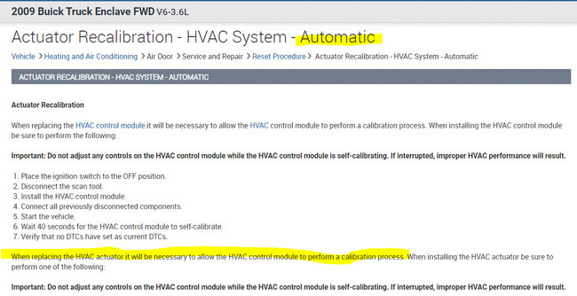

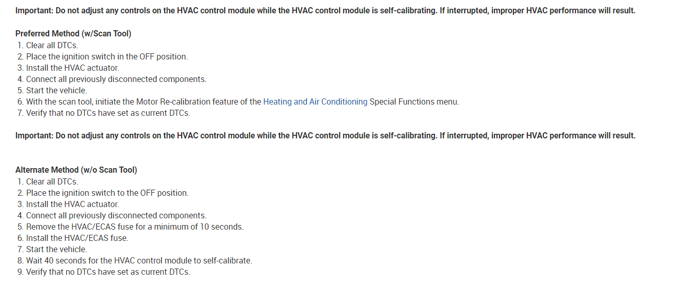

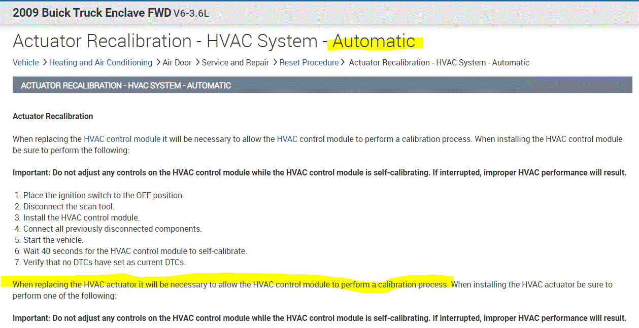

It should be movable. When you installed the new actuator, did you recalibrate the HVAC module? It shouldn't cause the door to stick, but anything is possible.
I don't know if this has a manual or automatic climate control system. So, I attached the recalibration directions below for both. Note: There are two ways of doing this. One requires a scanner and the other doesn't. Both are included.
Let me know if this helps.
See pics below.

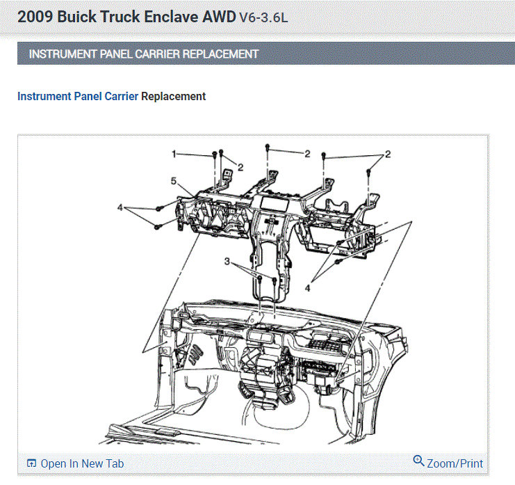

I just went through the manual and there is nothing specific to just replacing or repairing the door itself. However, let's see if we can figure out what is possible.

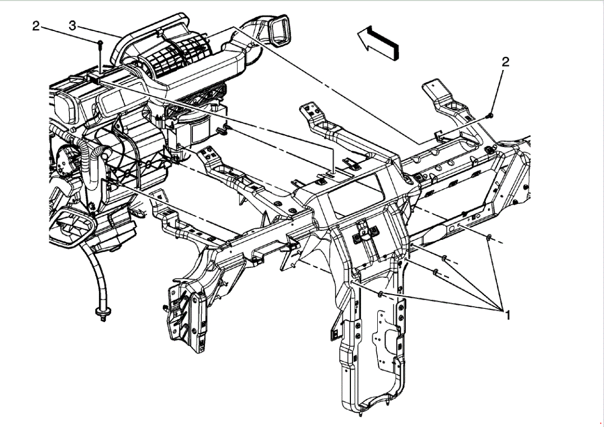

I can tell you that if we need to remove the HVAC module assembly, a good portion of the dash needs to be removed, the coolant will need to be drained, and the A/C will need to be vacuumed.
I need to know if this has manual or automatic climate control to know which to research for you. Just to give you an idea, I attached a pic below from the Automatic Climate Control unit so you can see what will need to be removed.

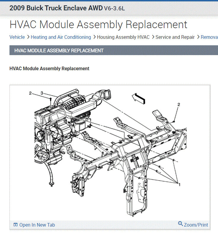

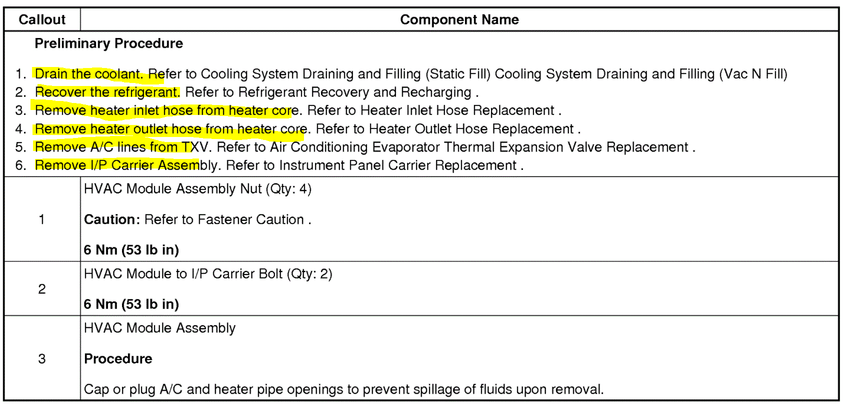

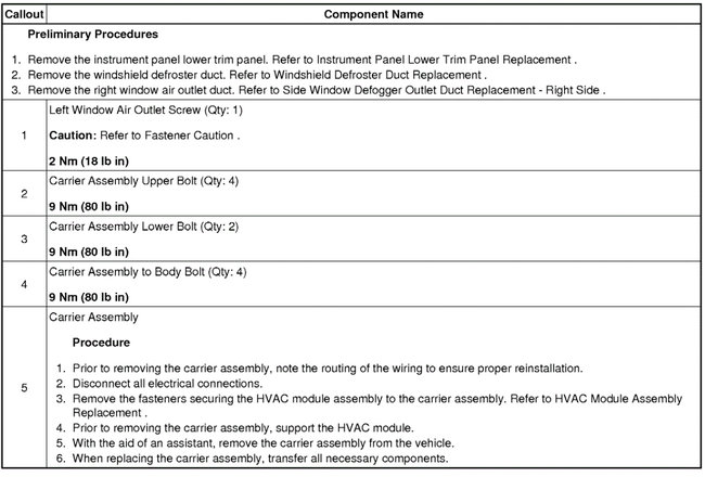

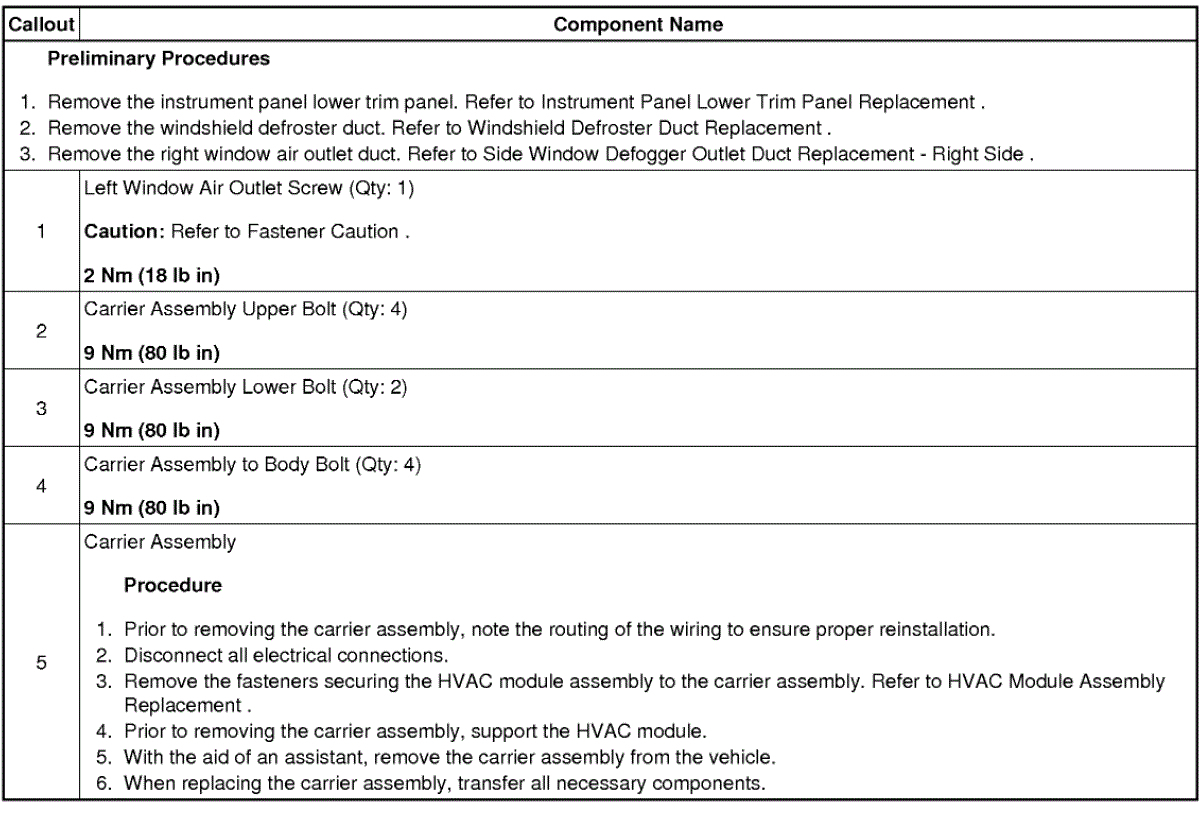

I wish we could get to it easier, but I suspect the best thing to do is remove the HVAC module to get better access.
There are several preliminary steps that need to be done before you can remove the module. However, if at any point, you find that you can get access to the door, by all means, do it.
You need to remove the instrument panel carrier. I started with those directions below (pics 1 and 2). Pics 3 and 4 explain how the module itself is removed.
I read through the directions before attaching them. They are somewhat vague, so let me know if you have questions.
Take care and let me know if this helps.
See pics below.
