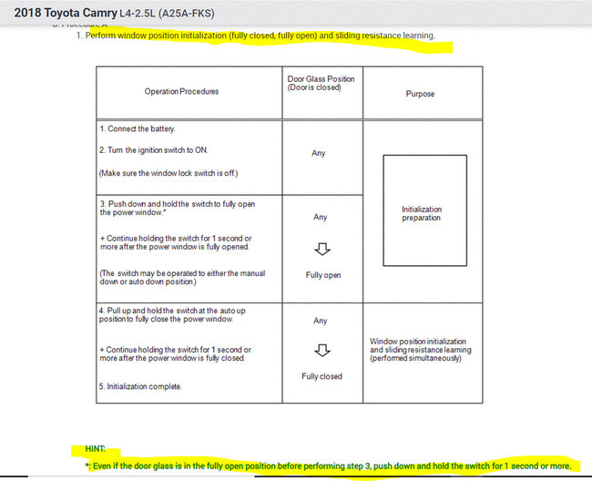

Whenever I try to close the power window for the passenger side window it goes up then goes down halfway. The rest of my windows works just fine it's just this one. Can someone tell me what it is?

I wouldn't think battery replacement would cause one of the windows to improperly operate, but anything is possible.
There is no "reset" when the battery is replaced. However, I want you to try resetting the affected window.
If you look below, I attached directions specific to resetting the fully open, fully closed positioning. At the bottom of the procedure is a Note. Make sure to follow it.
Let me know if this takes care of the issue.
See pic below.

Hey, I tried to reinitialize it and it still doesn't work.
