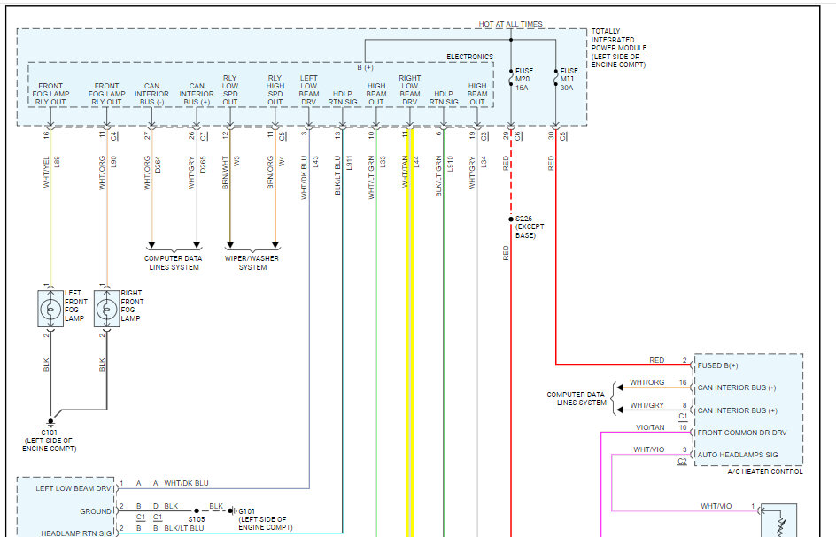

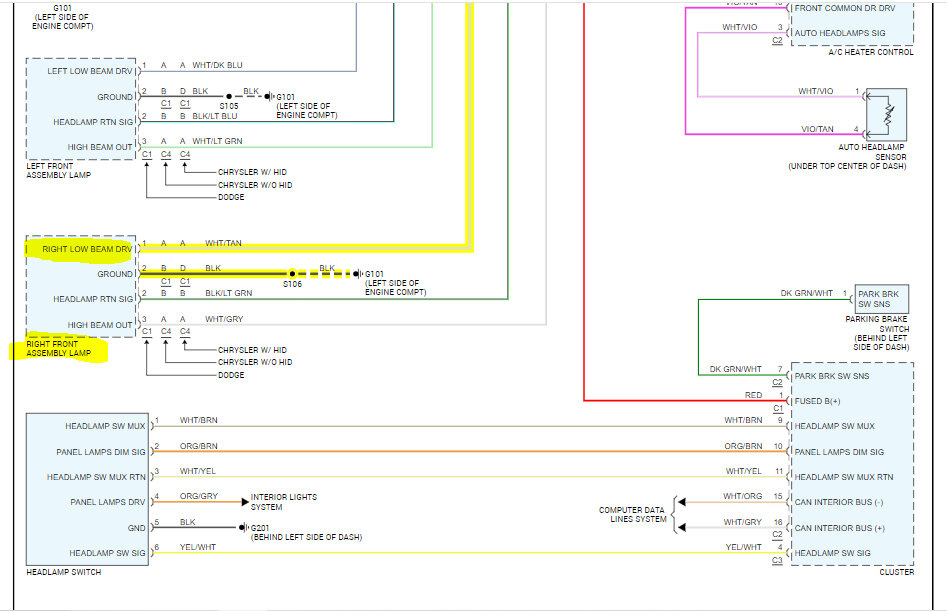

First, locate a white wire with a tan tracer. Check that wire to see if there is power present when the low beams are on.
If there is power, locate the black wire. The black wire is the ground wire, check to see if there is continuity to ground.

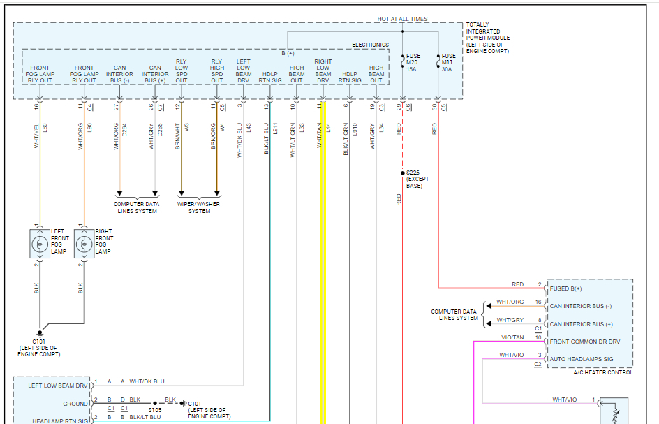

I attached the wiring schematic below, so you have a reference. Also, here is a link you may find helpful:
Let me know what you find.

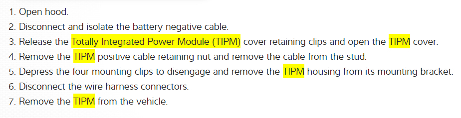

This guide can help you check for power more easily when the headlights are on:

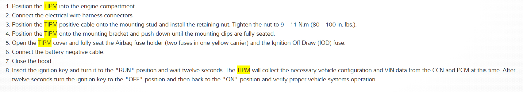

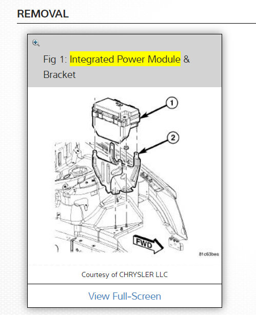

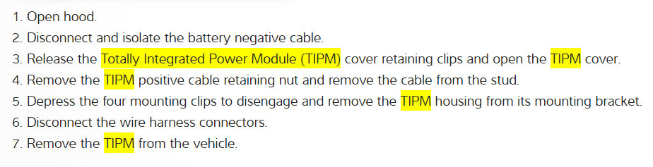

If no power is present, I have seen the TIPM go out which is common, you can get a used unit by searching Ebay which should fix the problem. Here is how to change the TIPM out. Check out the images (below). Please let us know what happens.
