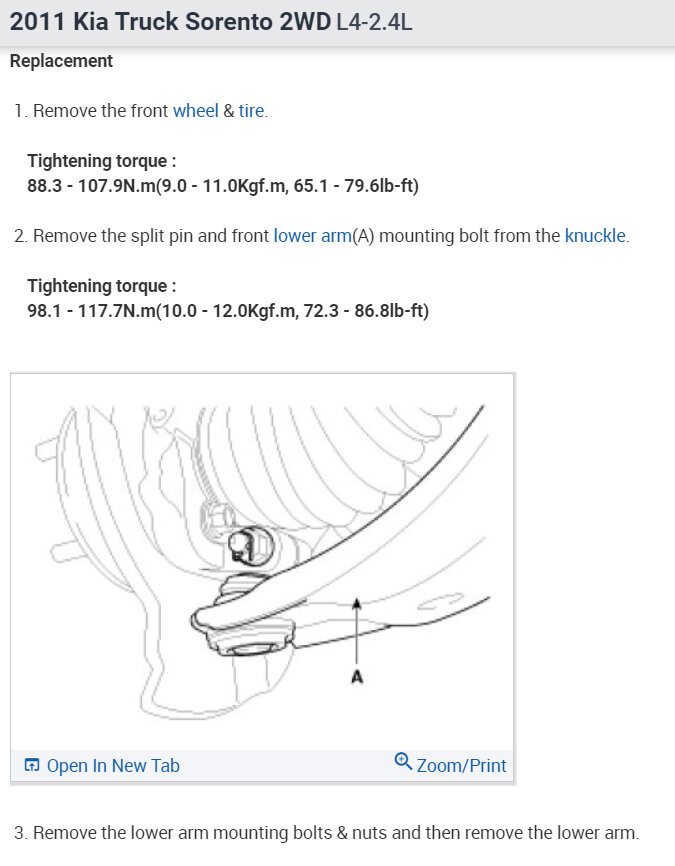

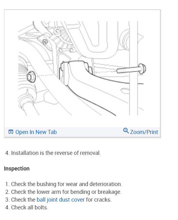

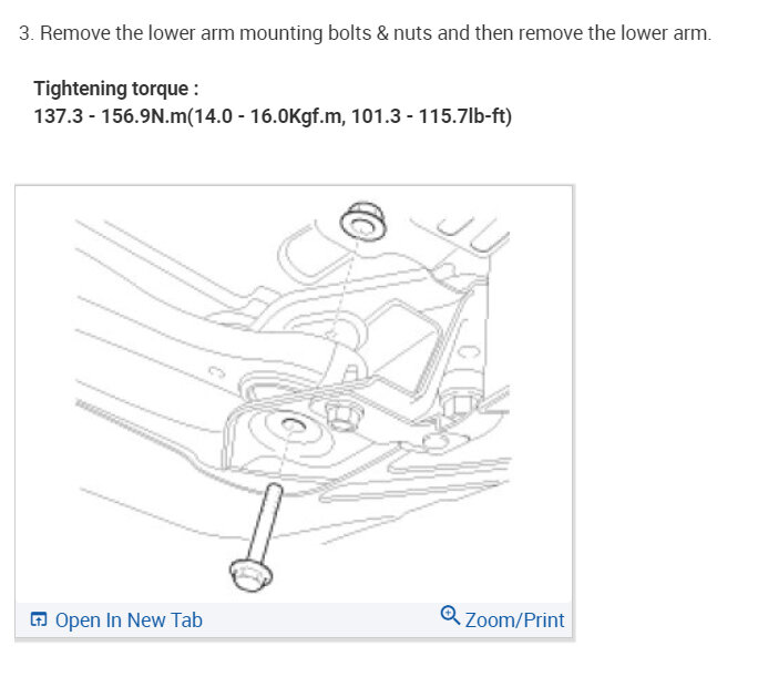

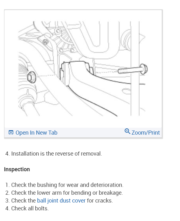

Here are the instructions on how to replace the arm, you can use a flashlight to inspect the bashings to confirm the issue.
This video shows the job being done on a similar car which the procedure is the same on, it shows the bushing but on your car, it might be available so you will need the arm.
https://youtu.be/g_hj1hRSNgg?si=bqIVn9yMM38UJa5c
Check out the images (below). Please let us know how it goes
