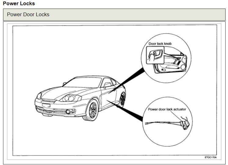

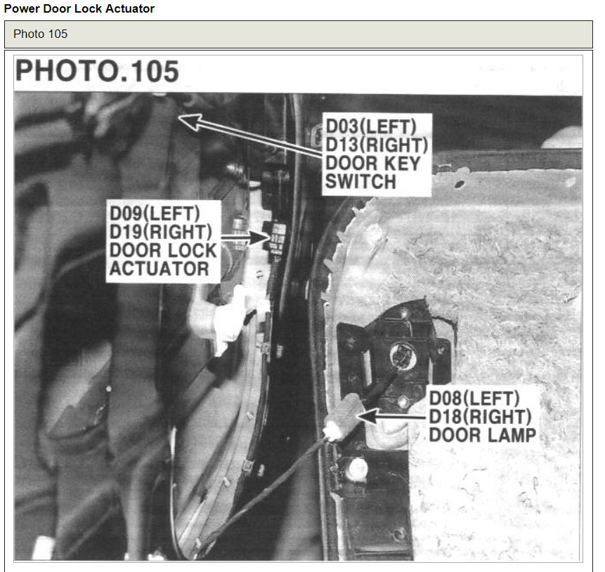

The door latch itself has gone bad just be thankful you can still open the door it gets messy when you cannot. Order a new latch from the dealer then install it by removing the three or four mounting bolts in the door jam. Below are some guides to help.
