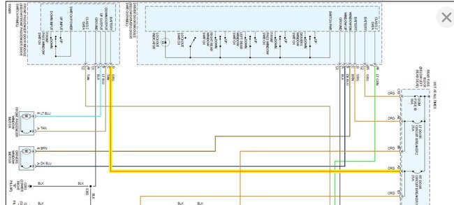

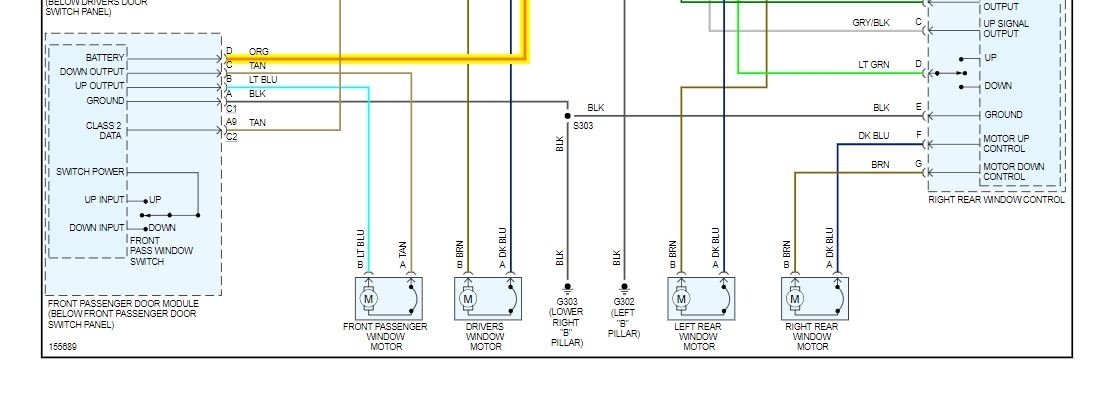

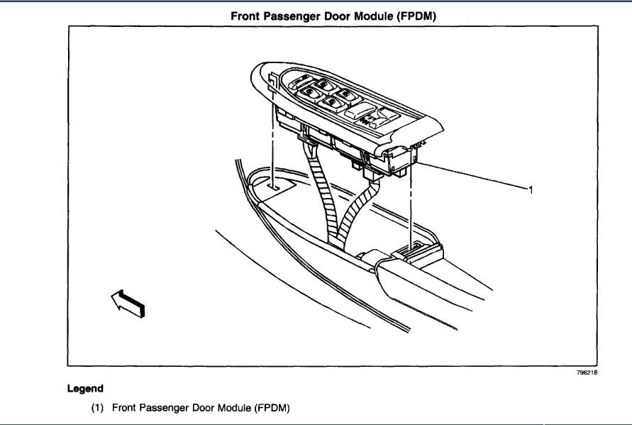

The passenger door is electrically dead. No dome lights when the door is open (the other 3 doors do), no power lock operation, no window operation even with drivers side window switch. No door ajar indication. This happened quite suddenly. The fuse is good, and the circuit breaker is good. Does anybody have the pinout of the Passenger Door Module?
