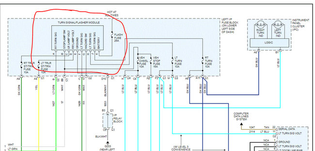

All three blinkers blink very fast about 3 times then quit. The front back and the mirror. I realize this usually means a bulb out but all three actually blink? Please help.

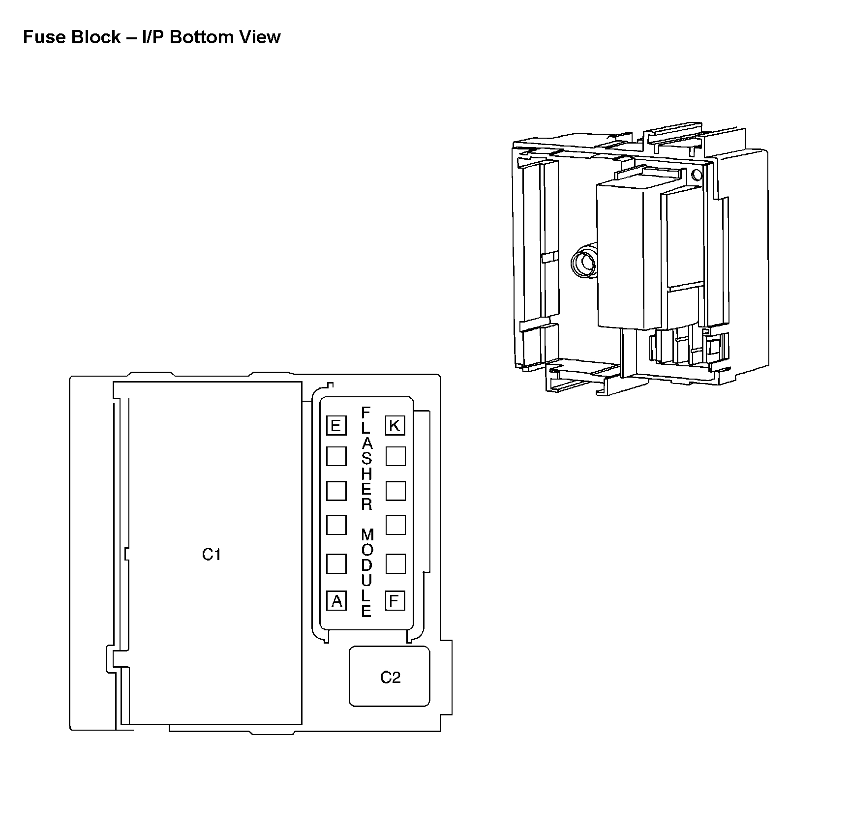

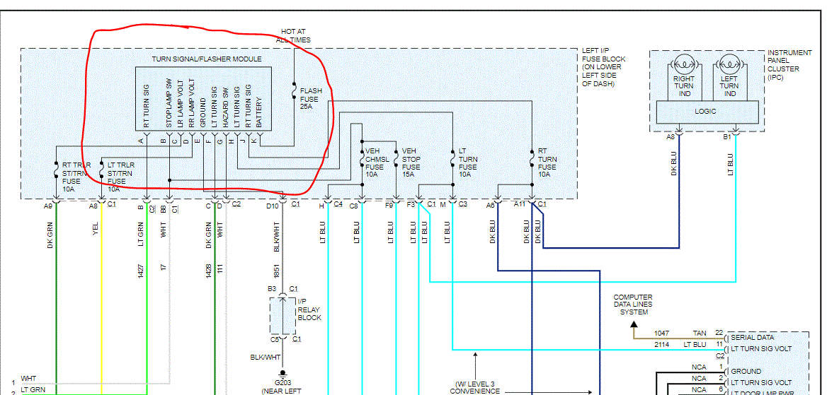

I suspect the turn signal flasher module is bad. I say that simply because they work (fast) and then totally stop. What happens when the hazard lights are turned on?
I attached a couple of pics below showing the wiring schematic and where the module is located.
