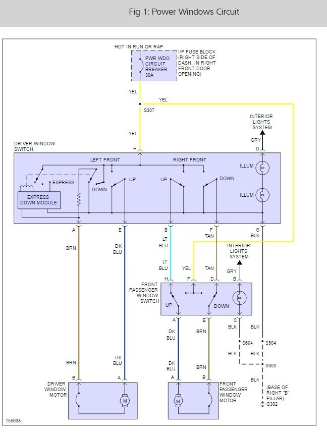

Switch was removed. how can I bypass switch so I can use my windows? had to a while back use battery charger to get my windows up. hanks

Bypassing the switch will be rough due to the polarity changes when the window goes up, and then down. But if its the only way here is a window wiring diagram (BELOW) for you so you can make it happen.

The best way is to simply replace the switch. Without it you would need do do multiple wiring changes to make the windows work. As a one time thing to test or roll them up moving a wire around is OK, but it's real easy to put power to the wrong terminal and cause damage.
