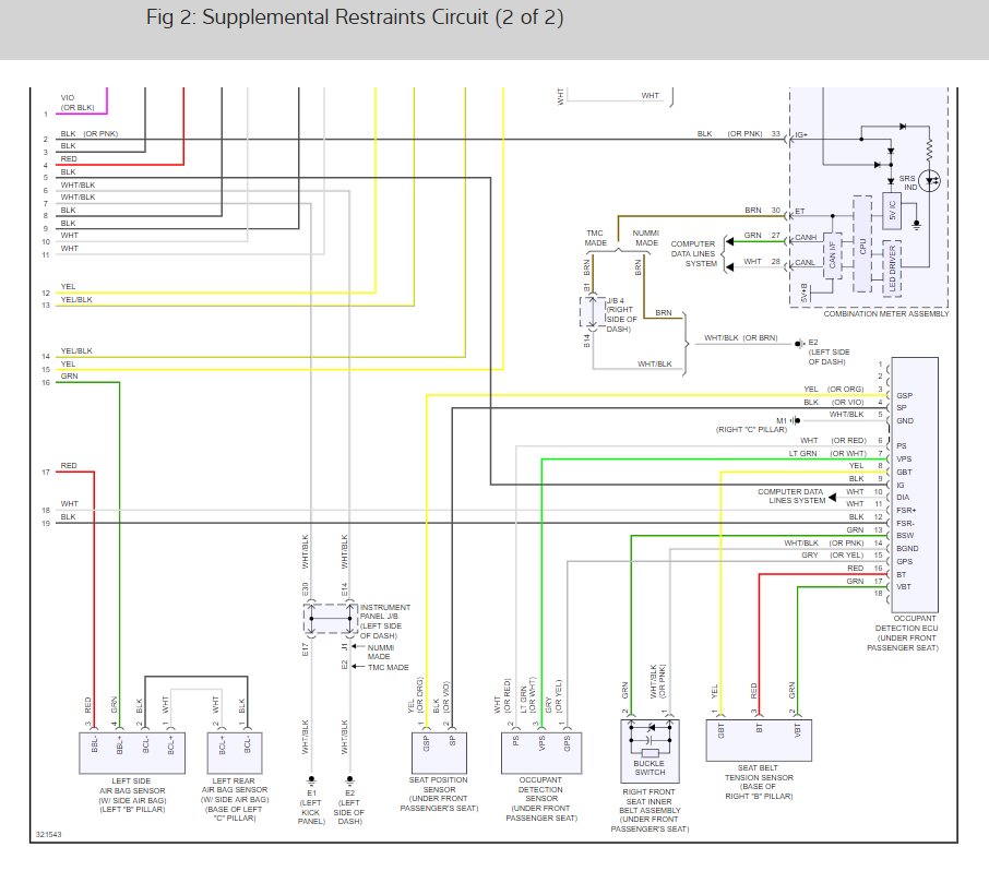

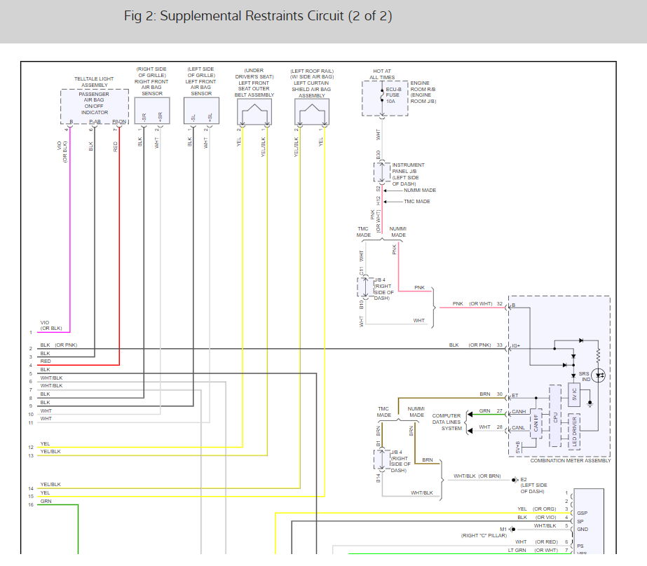

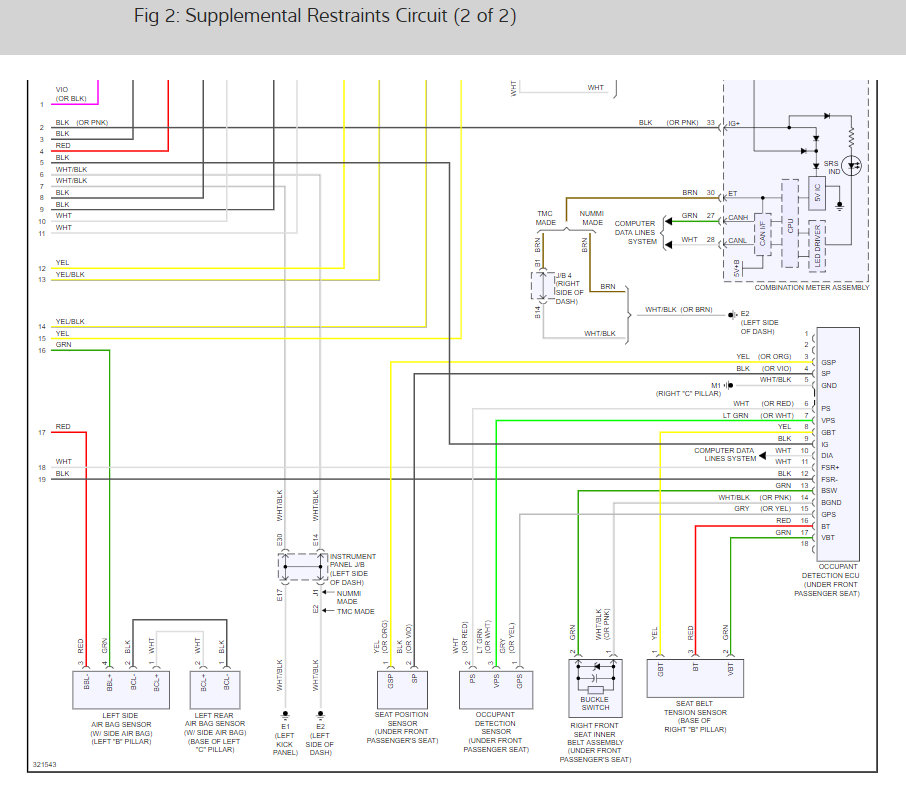

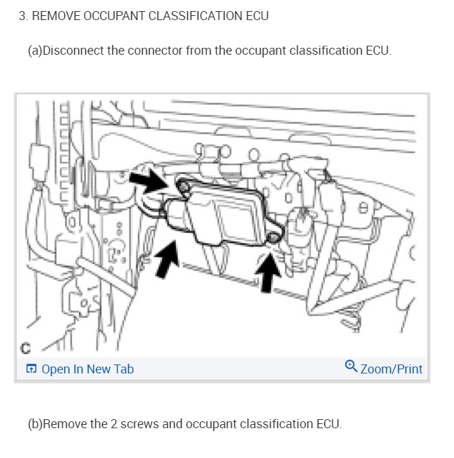

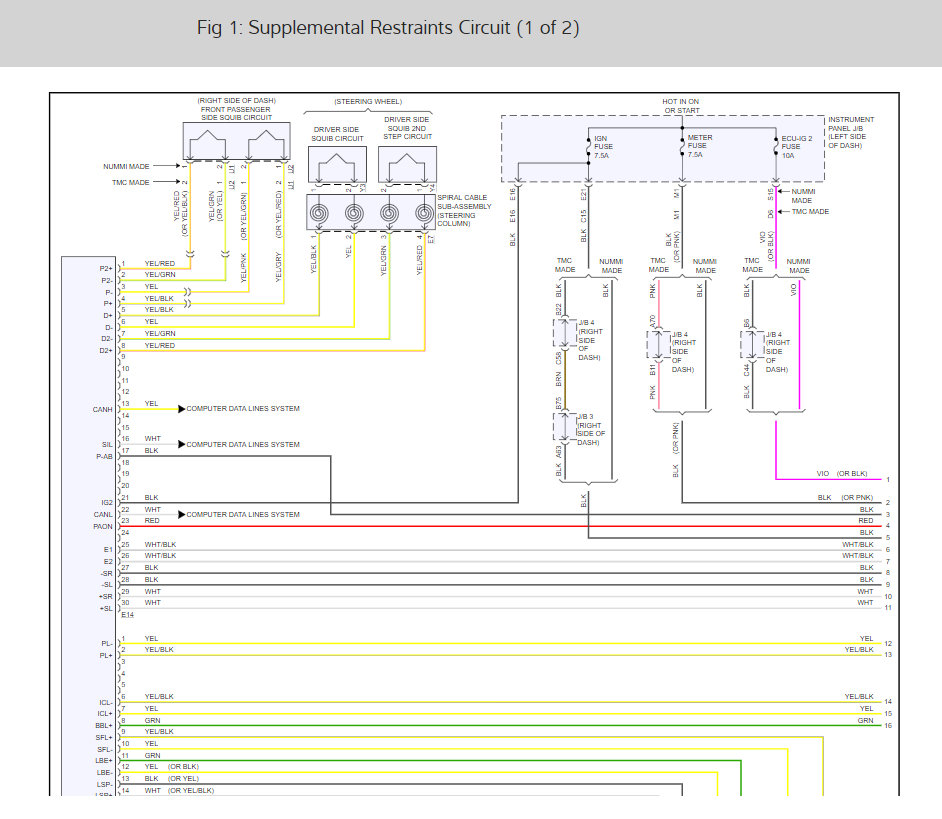

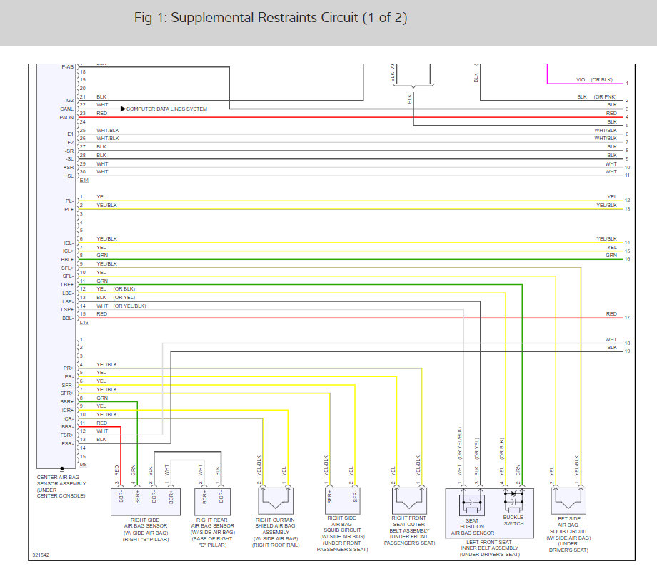

Here is a video that shows how to get the air bag codes, but it sounds like the weight sensor is out in the passages seat.
https://youtu.be/gnSGfEqrf_w
Here is the airbag wiring diagrams so you can see how it works and how to replace the sensor.
