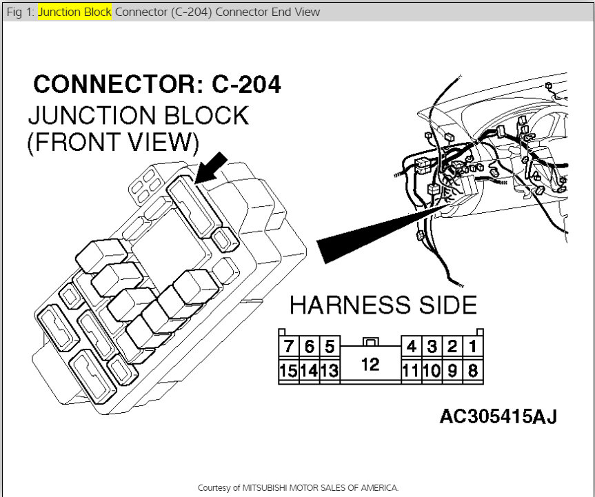

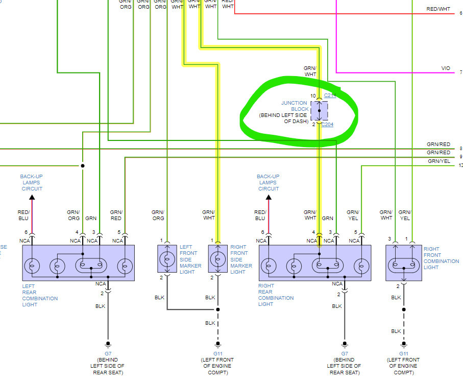

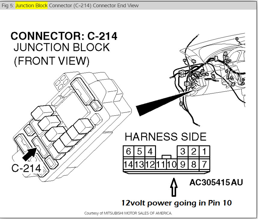

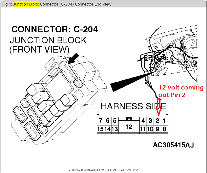

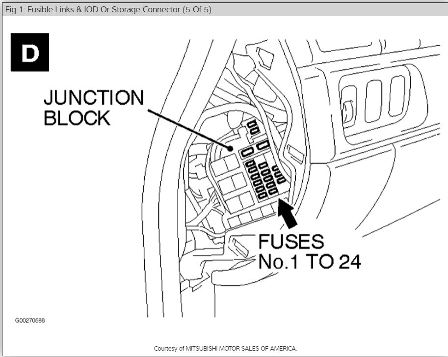

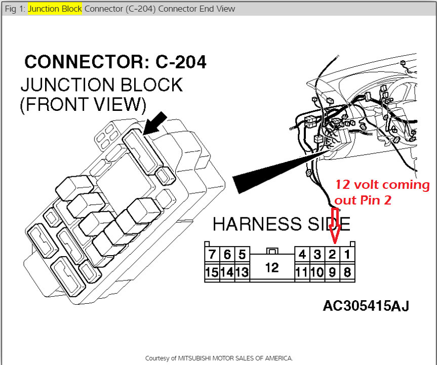

Hello, I'm assuming you put the correct bulb in that socket, it's a 2-filament bulb. One filament is for the Brake light and the other is the taillight. There is a Junction Block that the passenger side taillight bulb circuit has to go through. It goes in C-214 and out C-204, The first diagram is the wiring diagram for the whole lighting circuits. Circled in Green is that Junction Block or connection between the power source and the tail marker bulb. The second diagram is the Junction Block location (on the driver side dash). The third diagram is the tail marker connection C-214 and the last diagram is where it comes out of the Junction Block C-204. These Fuse panel/Junction Blocks sometimes get corroded behind them due to either the window being open while driving, or a slight water leak. But check that location and make sure that connection is okay. You can use a test light to make sure power is going in and coming out.

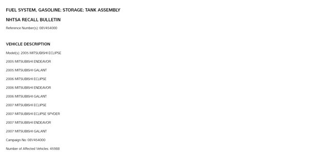

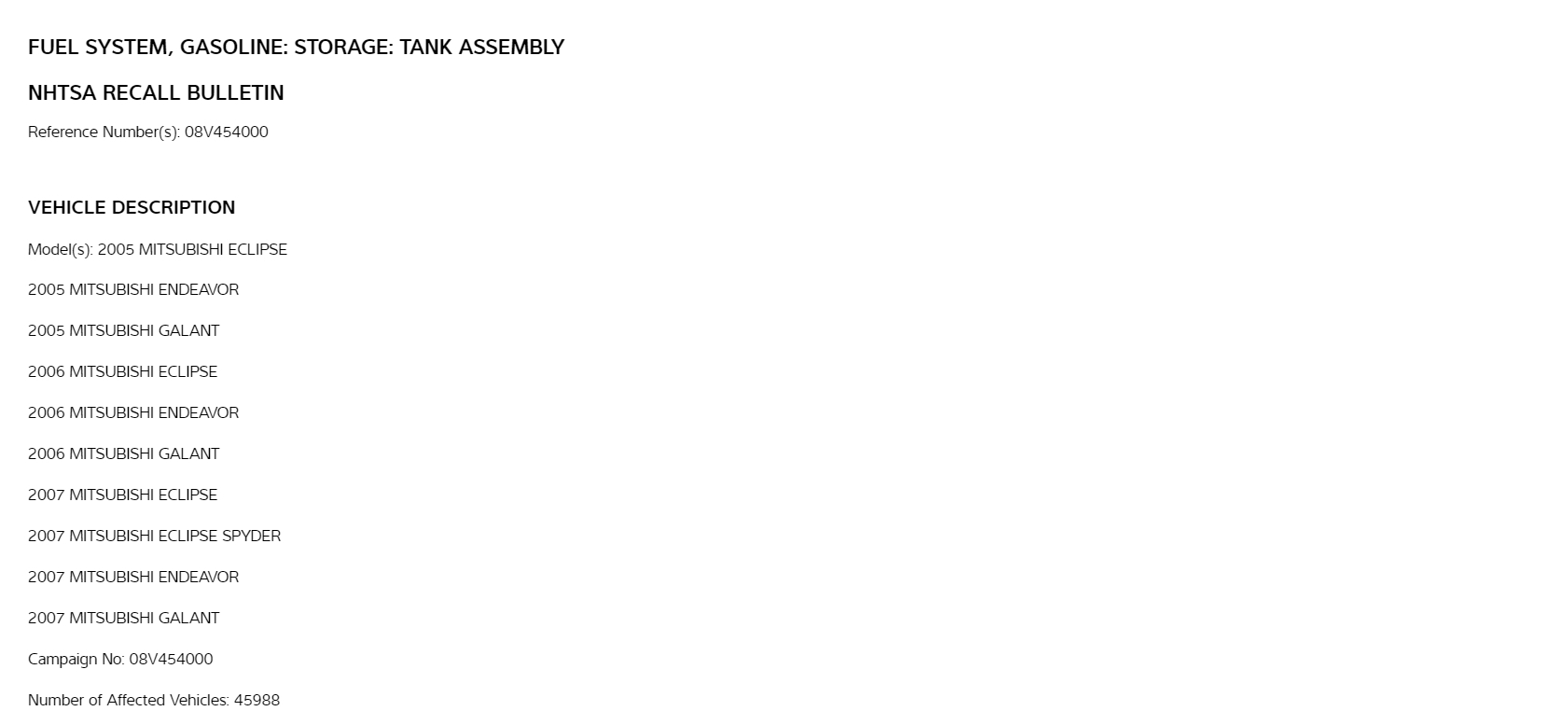

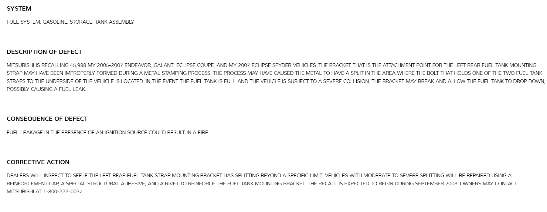

I also wanted to inform you that there is a Recall on this vehicle for the Gas Tank Supporting Strap. I will put the information below. This is a safety concern, if the strap breaks it can cause fuel to leak out of the tank. Since this is a Recall, the dealership must fix it for free. (Pages 1 and 2)

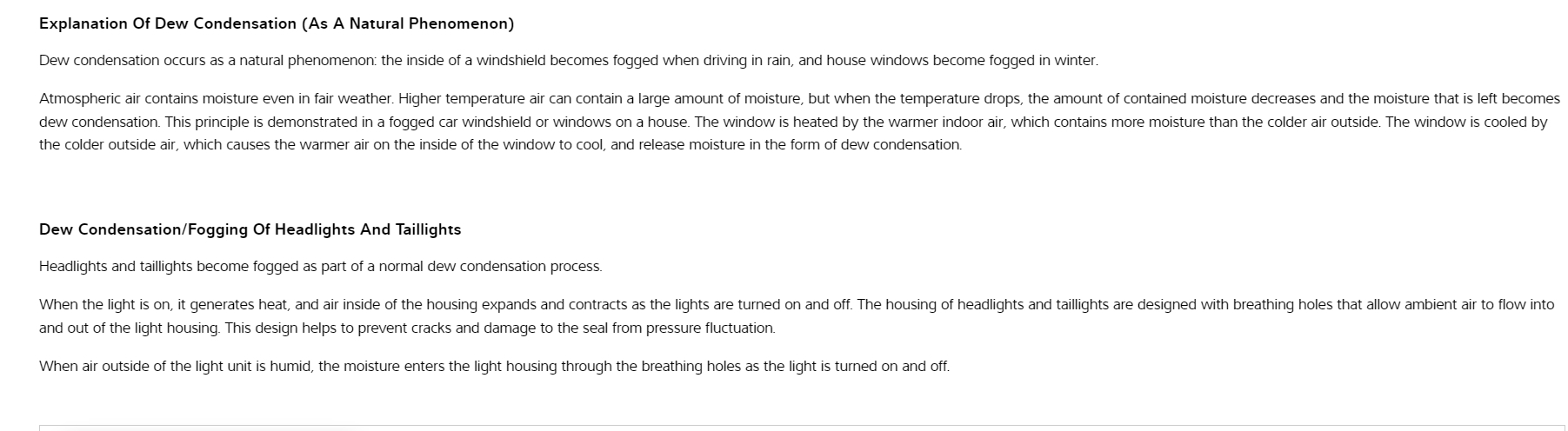

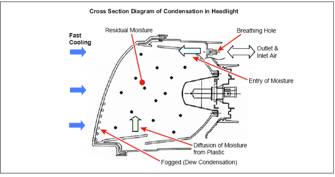

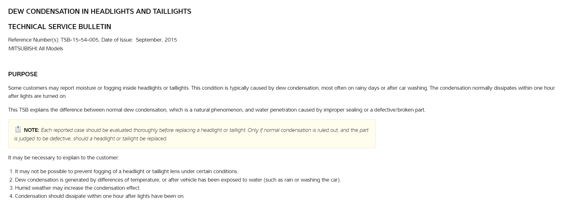

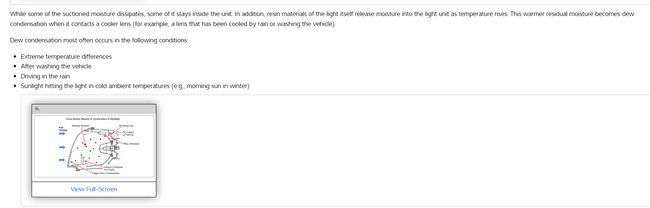

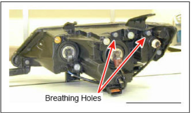

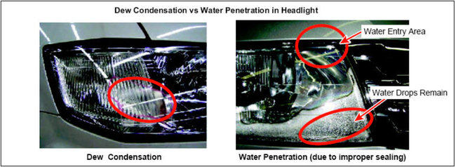

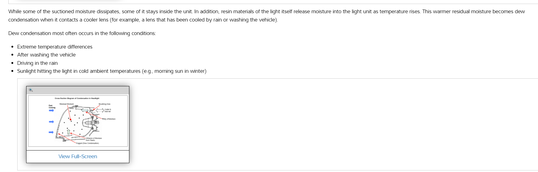

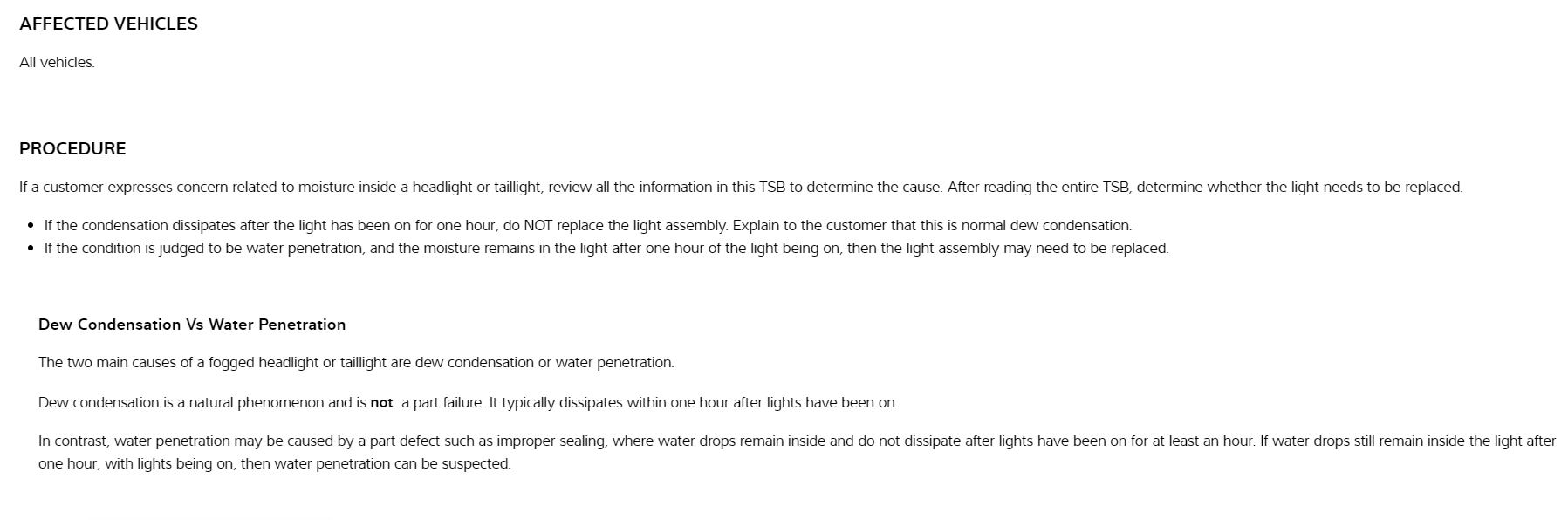

I also found a Technical Service Bulletin about moisture inside the exterior lamp assemblies. This is not a Recall but may be the cause of the blown fuses. (Pages 3-8) Below.
