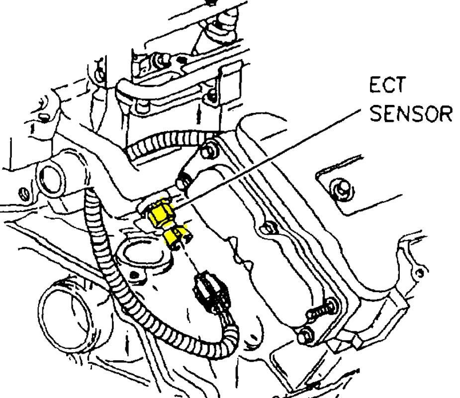

The ECT is located in the rear of the engine in the coolant tube just above the bell housing flange on the block. You can see it if you look in the area between the exhaust crossover the intake manifold and the cylinder head. To get to it for replacement you need to remove the air intake duct then the MAF sensor. Next you may need to remove the exhaust crossover. I have been 50/50 on that, some have enough room to snake an extension and socket in there to get the sensor, others are built with not enough room. Next you need to drain the coolant below the sensors level and disconnect it and remove it. Reverse the process to install a new one.

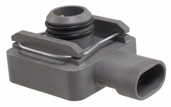

The level sensor is in the tank on the side of the radiator below the area where the radiator cap is attached. With the coolant drained you remove the retainer clip and pull the sensor out, apply a bit of silicone to the o-rings on a new one and press it into the port, then install the retaining clip.

Well that would cause the problem you have. Just need to track down the connector, it should be a two pin connector with a yellow and a black wire. Should come down below the intake toward the back of the engine.
