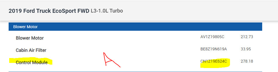

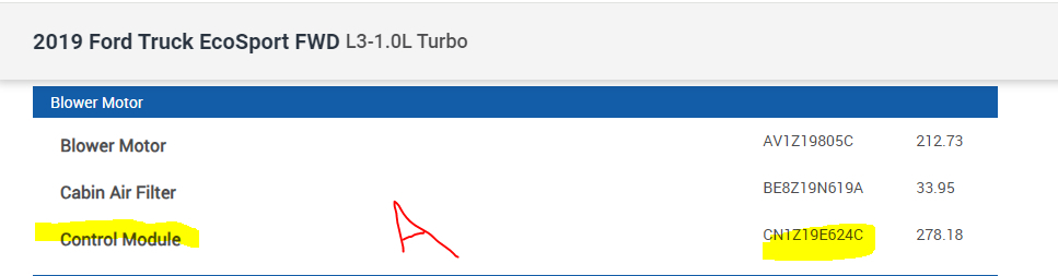

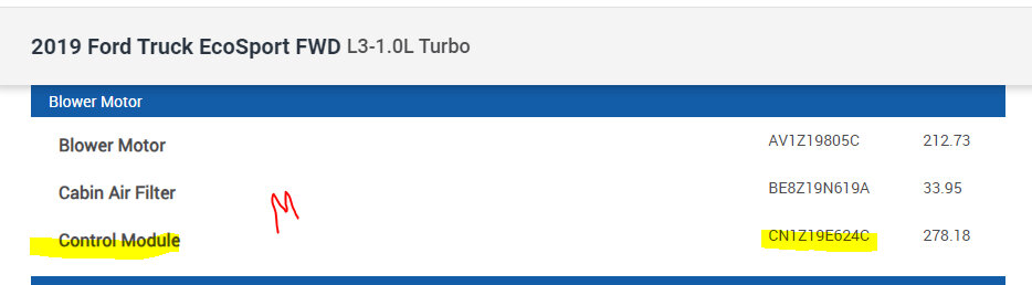

I attached a picture below showing what my manual indicates for this vehicle. I checked both automatic and manual climate control which show the same part number. That doesn't make sense to me.
Does your vehicle have automatic or manual climate control? That may be the difference you are running into. As mentioned, I would expect the part numbers to be different, but they show the same.
joe
See pic below. The A and the M simply identify automatic or manual control.
