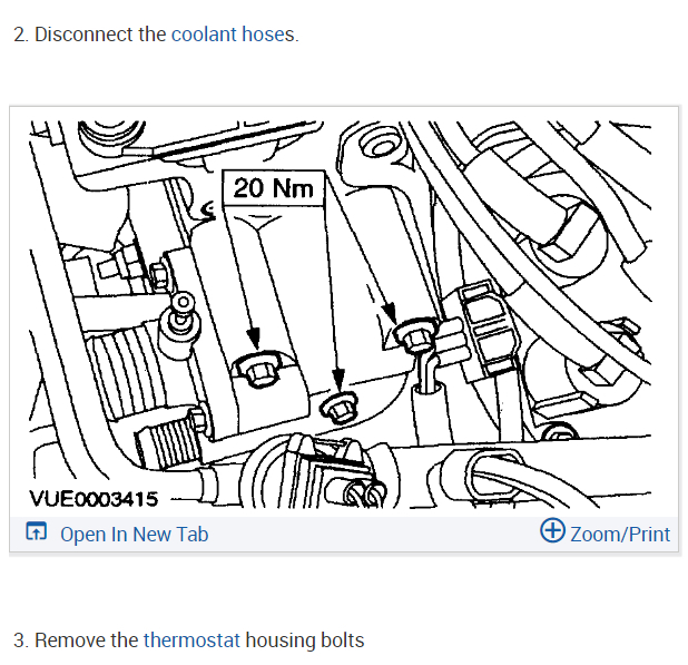

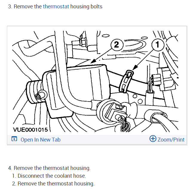

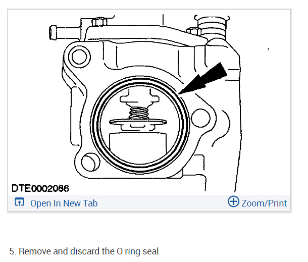

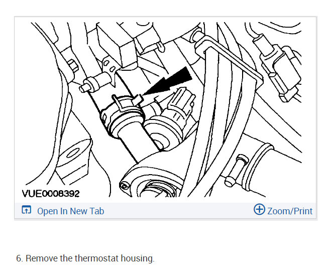

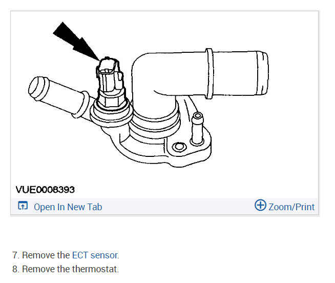

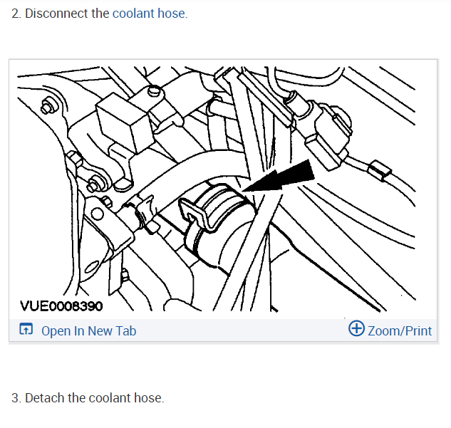

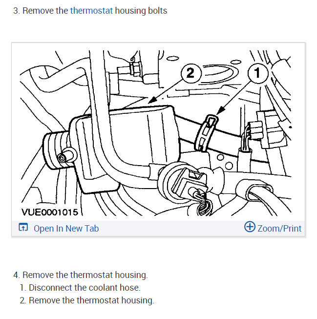

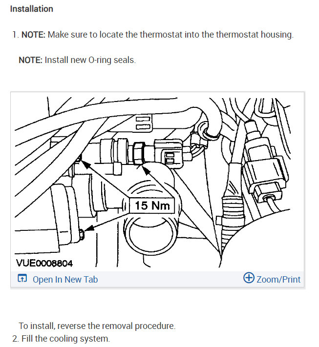

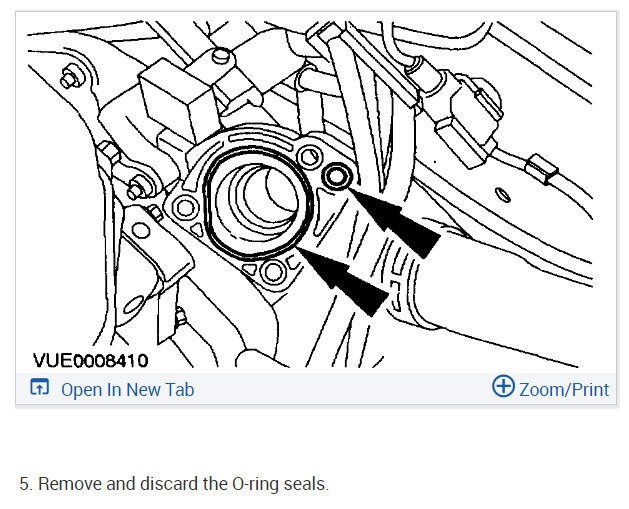

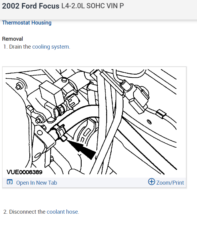

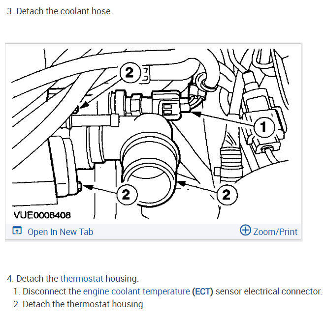

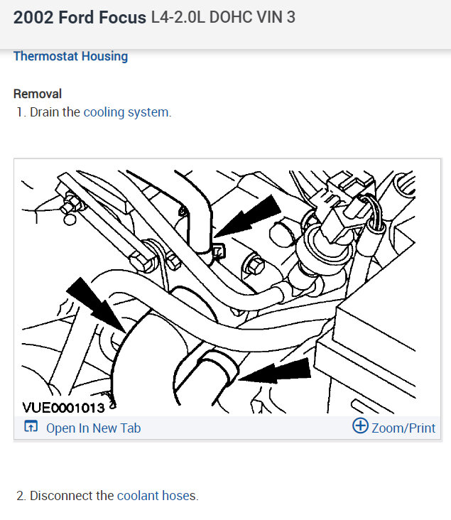

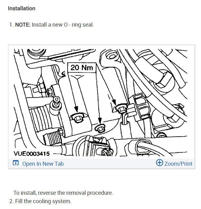

Here is a generic guide to help you step by step with instructions in the diagrams below to show you how on your car. Check out the images (below). Let us know if you need anything else.

I see the problem; this is a signal overhead camshaft which the one above is for the dual overhead camshaft.
Here is how the job is done on your car:

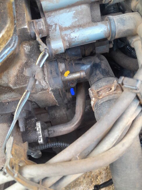

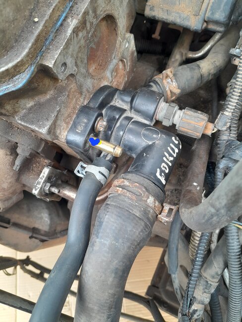

Good morning, sir, it has been a while. I have purchased the thermostat housing and the hoses. Thanks for all the support and guidance. Please, I also want to know. Can you indicate to me where the hose from the metal on the thermostat entered in the firewall? Couldn't locate it in the firewall. Just indicate it. Thanks very much for all you do and God bless you.
May 4, 2024 at 6:58 AM
