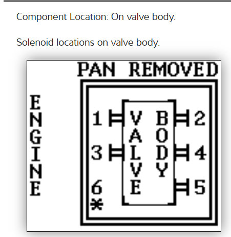

I've attached a picture below of the solenoids that are located on the valve body in your vehicle's transmission. Hope this helps and thanks for using 2CarPros. Happy Holidays.

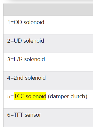

Thank you. So among those 5 solenoids, the torque converter clutch solenoid is amongst? or is the another position for that particular solenoid?

On the picture of the valve body in the prior post it is in location #5. Hope this helps and thanks again for using 2CarPros.
