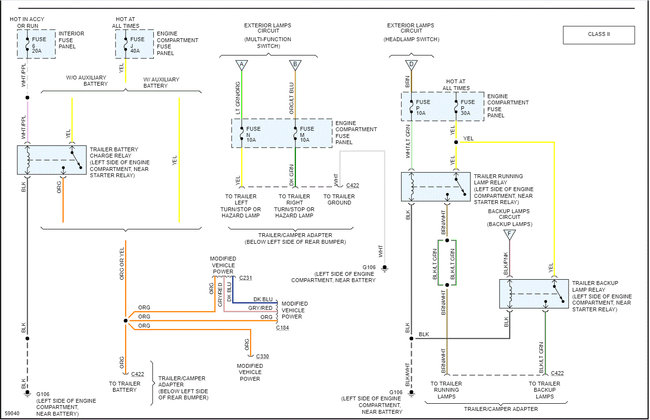

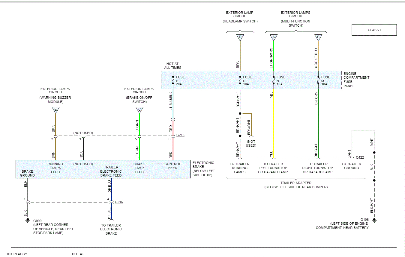

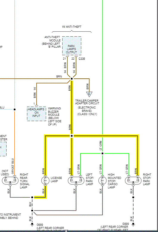

Hi I drive the vehicle listed above e-350, 351 Windsor v8 (5.8L) ~55,000 mi, it is a Tioga Montera Camper.
I've had persistent issues with the parking/running lights remain on unless:
I. The positive or negative power terminal is disconnected.
II. Fuse "K" in the Power Distribution Box labeled Trailer tow running and backup lamps, 20 Amp is removed.
With the key out of the ignition in the off position the lights remained on when:
I. Headlight switch is undone.
II. All fuses are removed from below the steering column.
Any advice about what could be wrong is greatly appreciated.
