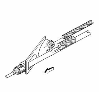

Actually Chilton says that equalizer is at the right rear. Here is a photo of it:
