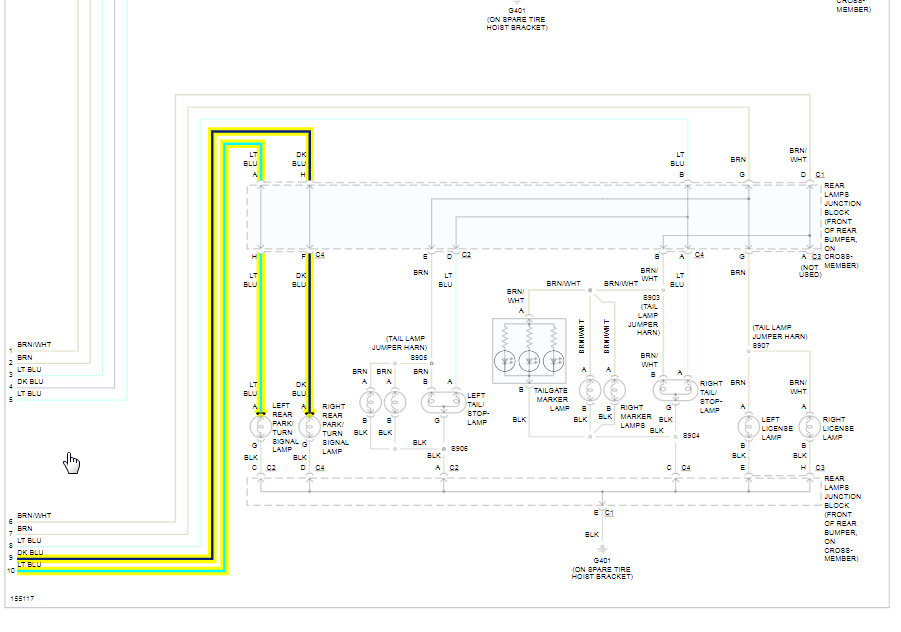

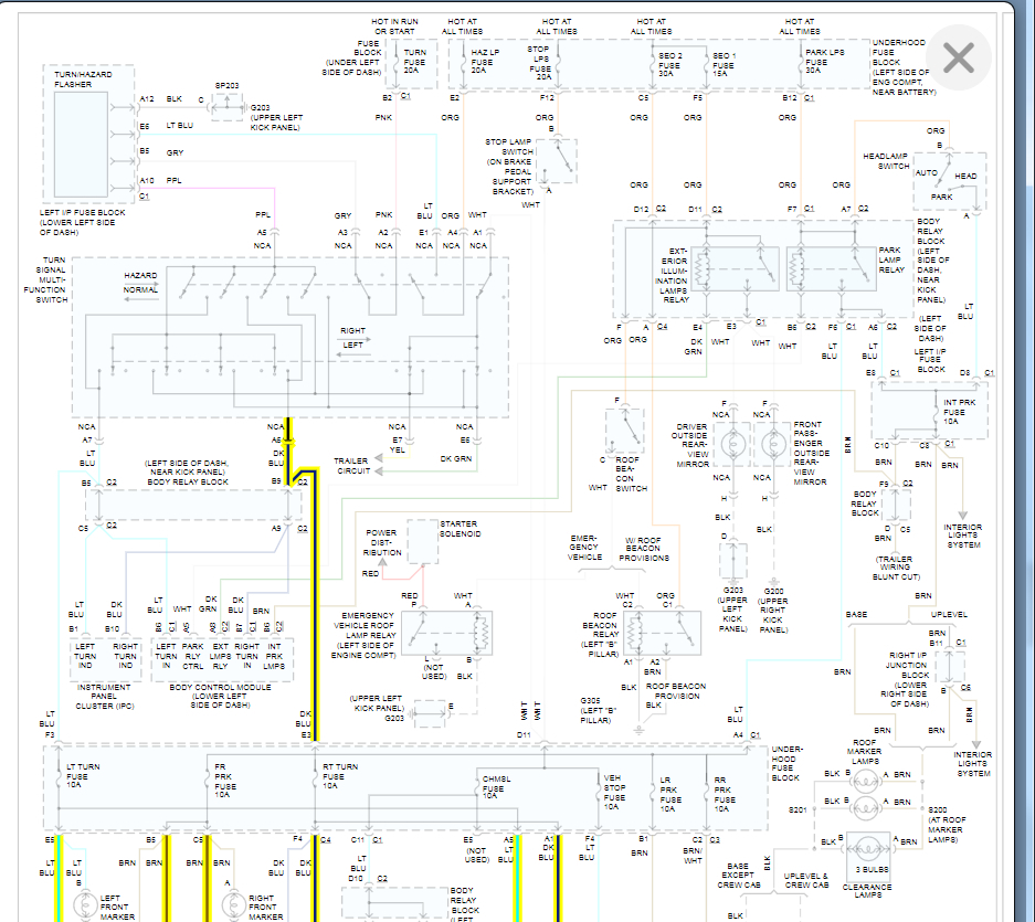

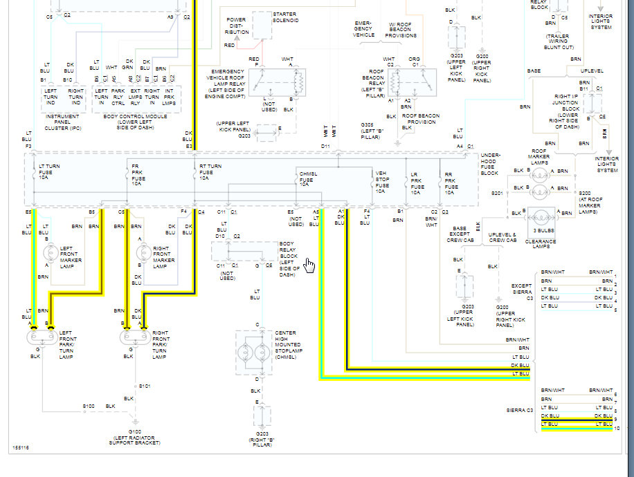

Randomly my blinkers cruise and parking lights starting having issues. I fixed the blinkers which just stayed illuminated instead of flashing that was solved via a new relay. Now my parking lights are stuck on, and while this happens the chime will sporadically go off even though there is no key in the ignition and the headlamp selector is in the off position.
