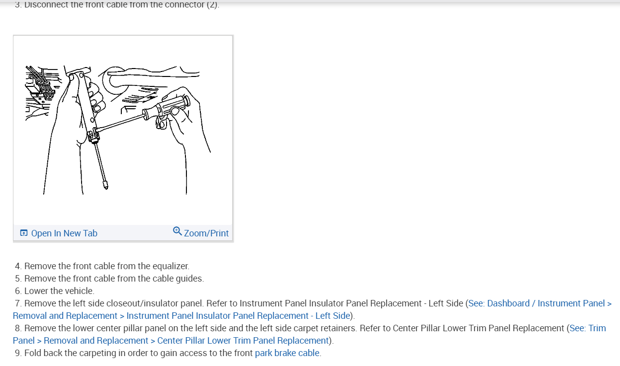

I am trying to remove the front cable. It is pedal actuated. Cable runs under the carpet along the front and rear rocker panels on the left side.
The manual is rather vague how to get to the cable.
Remove lefthand closeout/insulator panel.
8. Remove lower center pillar panel on lefthand side and lefthand side carpet retainers.
9. Fold back carpeting in order to gain access to the front park brake cable.
No clue as to what or where the left hand close out/insulator panel is?

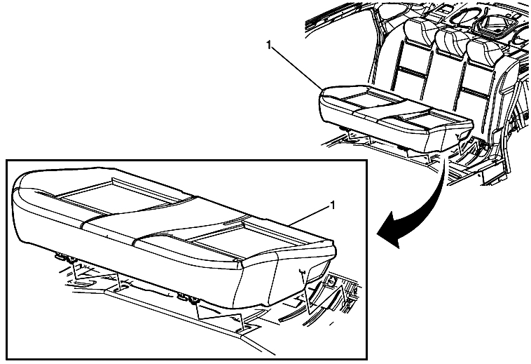

Seat Cushion
1. Pull up on front of seat cushion to disengage retainers and lift rear seat cushion (1) out of vehicle, Fig. 3. A high amount of upward force will be required.
2. After removal of retainers, sheet metal will be slightly deformed outward. Use a small hammer and pound sheet metal back to its original, flat appearance.
3. Remove seat cushion by lifting cushion up and pulling cushion outward from seat back.
4. Reverse procedure to install, note following:
a. Torque retaining bolts and nut to 33 ft. lbs.
b. Hooks at rear of seat must go over and behind mushroom retainers at rear of floor.
c. When installing new plastic retainers on front of seat, only seat retainer to first click, otherwise insertion force into sheet metal will greatly increase

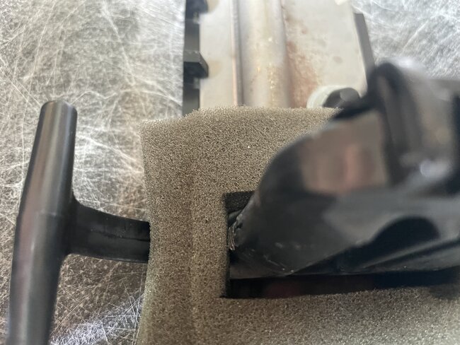

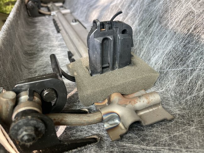

Okay, well, I never did find what or where the left hand close out/insulator panel is. But I did manage to get the rear seat cushion up. Even though the seat cushion folds up towards the front to expose a storage area it should be left down. The fiberglass pan is latched in the front. Two places. There is a pull tether you will find on either side. See photo.
Still might have to remove the driver's seat to gain access to the front brake cable.
Will see tomorrow.

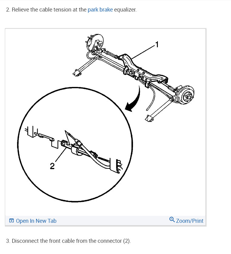

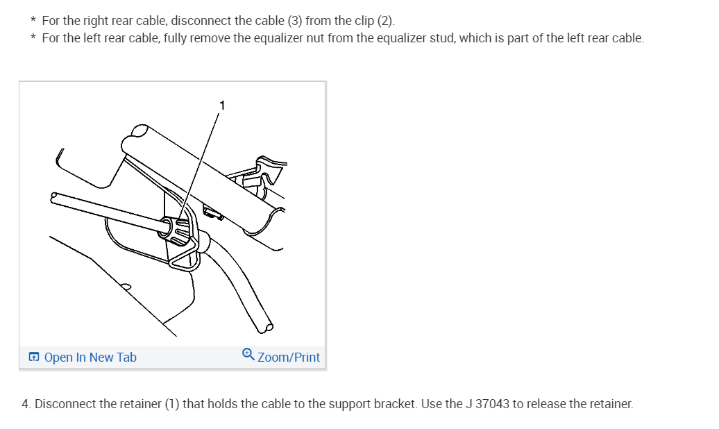

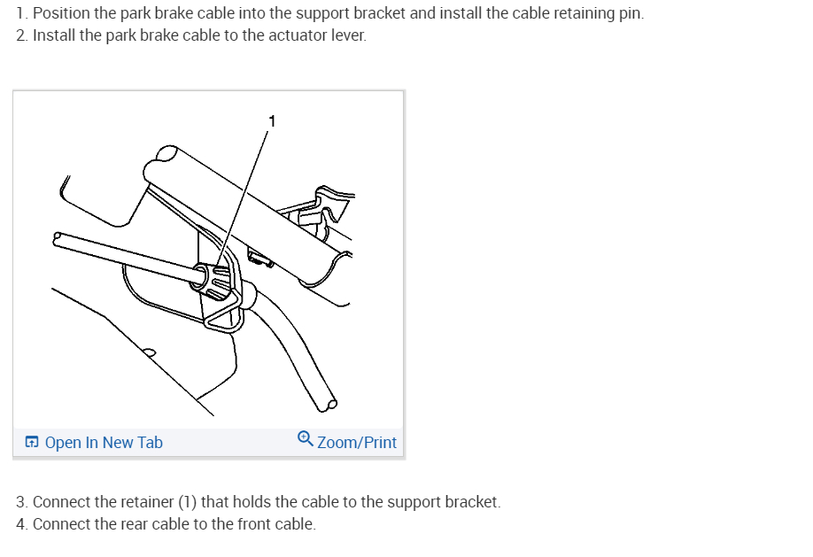

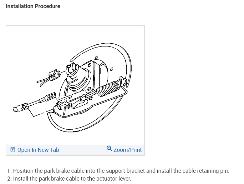

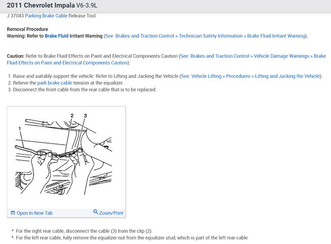

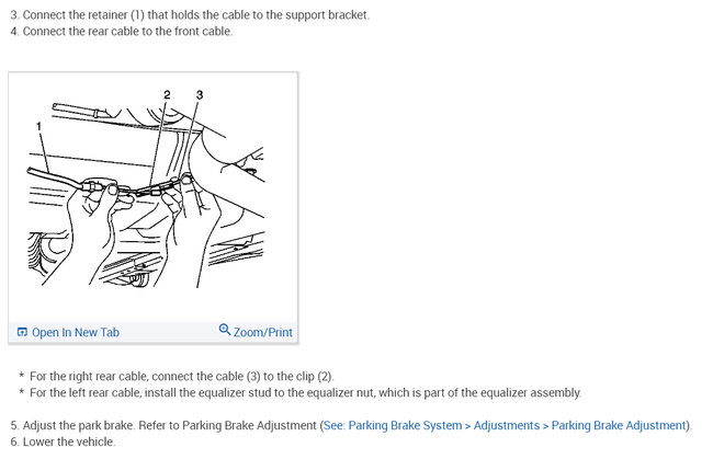

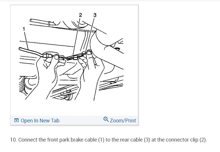

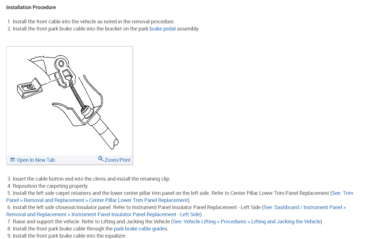

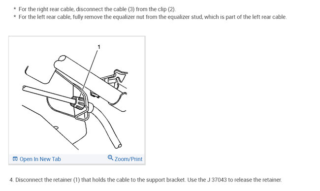

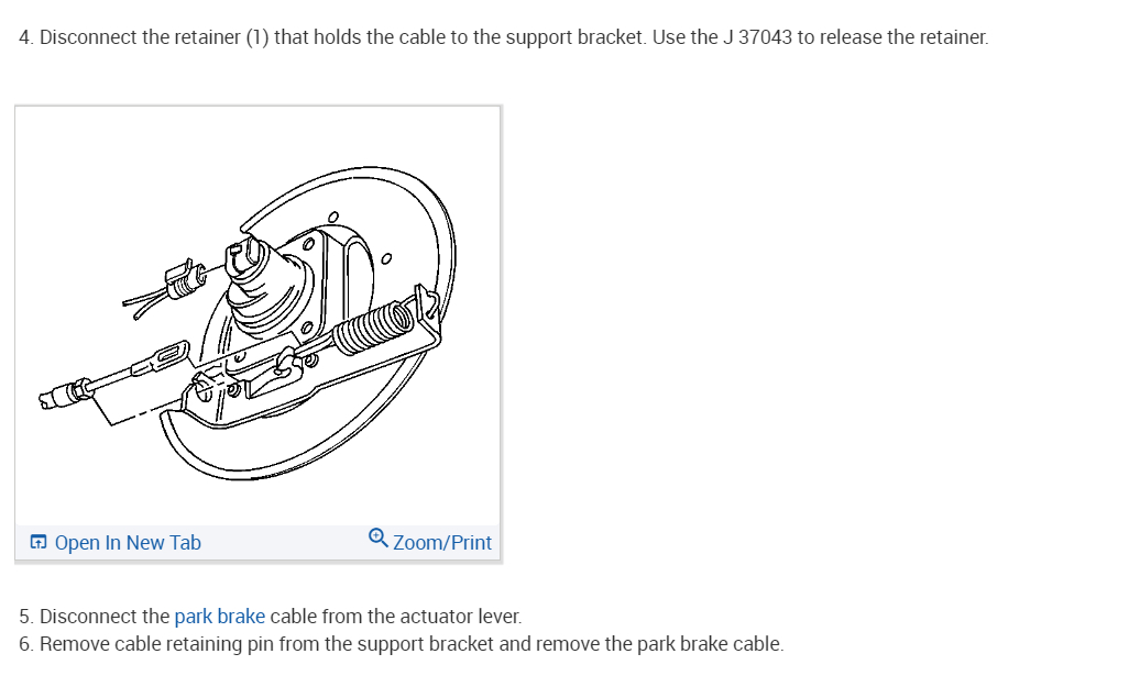

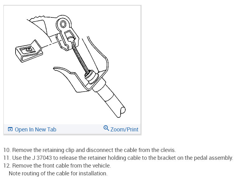

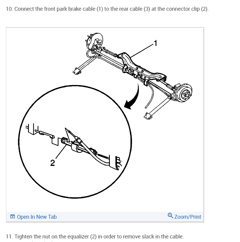

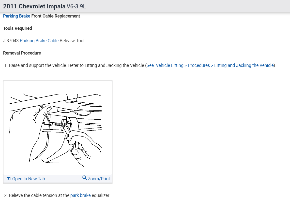

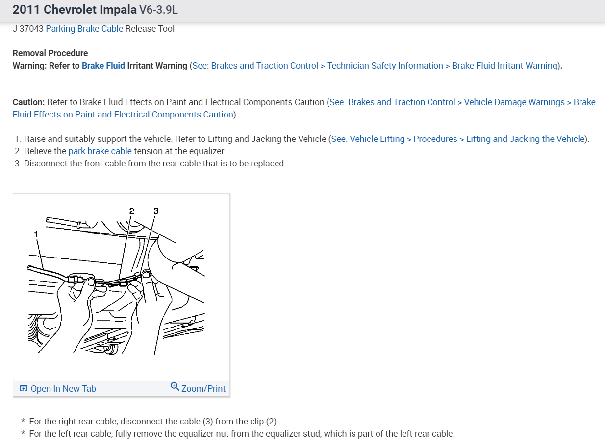

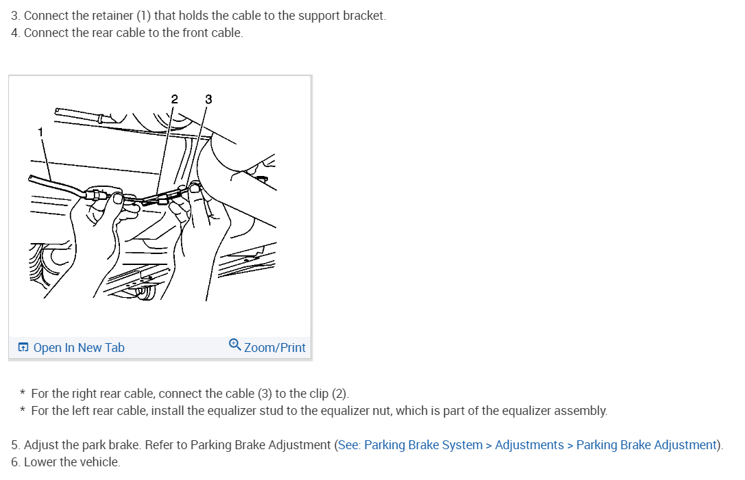

Hey PEPPERMRJ,, long time no see how are things going? Hmm, they don't say anything about removing the seats in AllData. I don't see the cable coming through the in images, here is what they say to change the parking cable out. Check out the images (below). Please let us know how it goes.
Jul 20, 2023 at 10:56 AM
