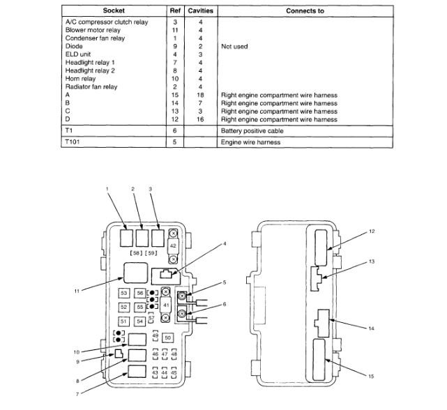

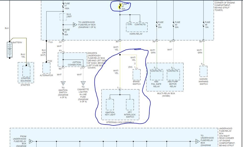

I attached what the fuse controls. You need to disconnect each component until the draw drops down to 50-75 milli amps.
Jul 2, 2020 at 10:31 AM
DAVIDWRIGHTSON
the meter read like 6 amp if i'm not mistaken. after i removed fuse 47 is was down to 50 milli amps.

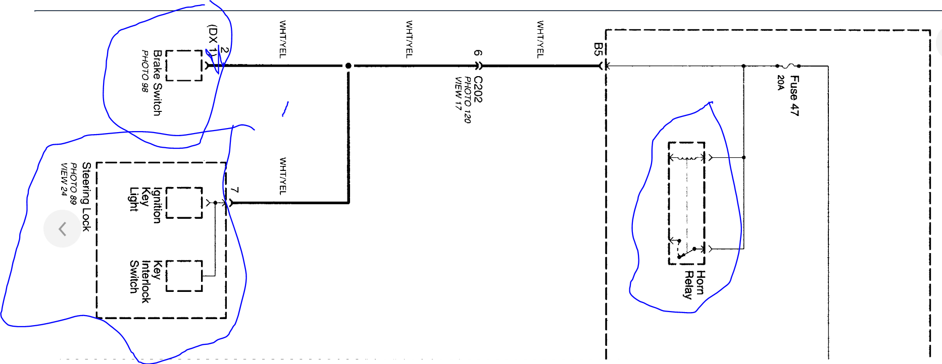

You need to disconnect the horn relay, the brake light switch, ignition key light and the key interlock switch.
Then recheck the draw and see if goes to 50.

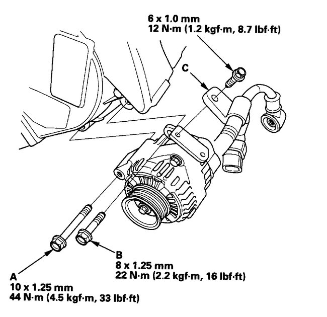

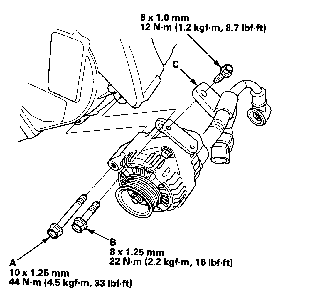

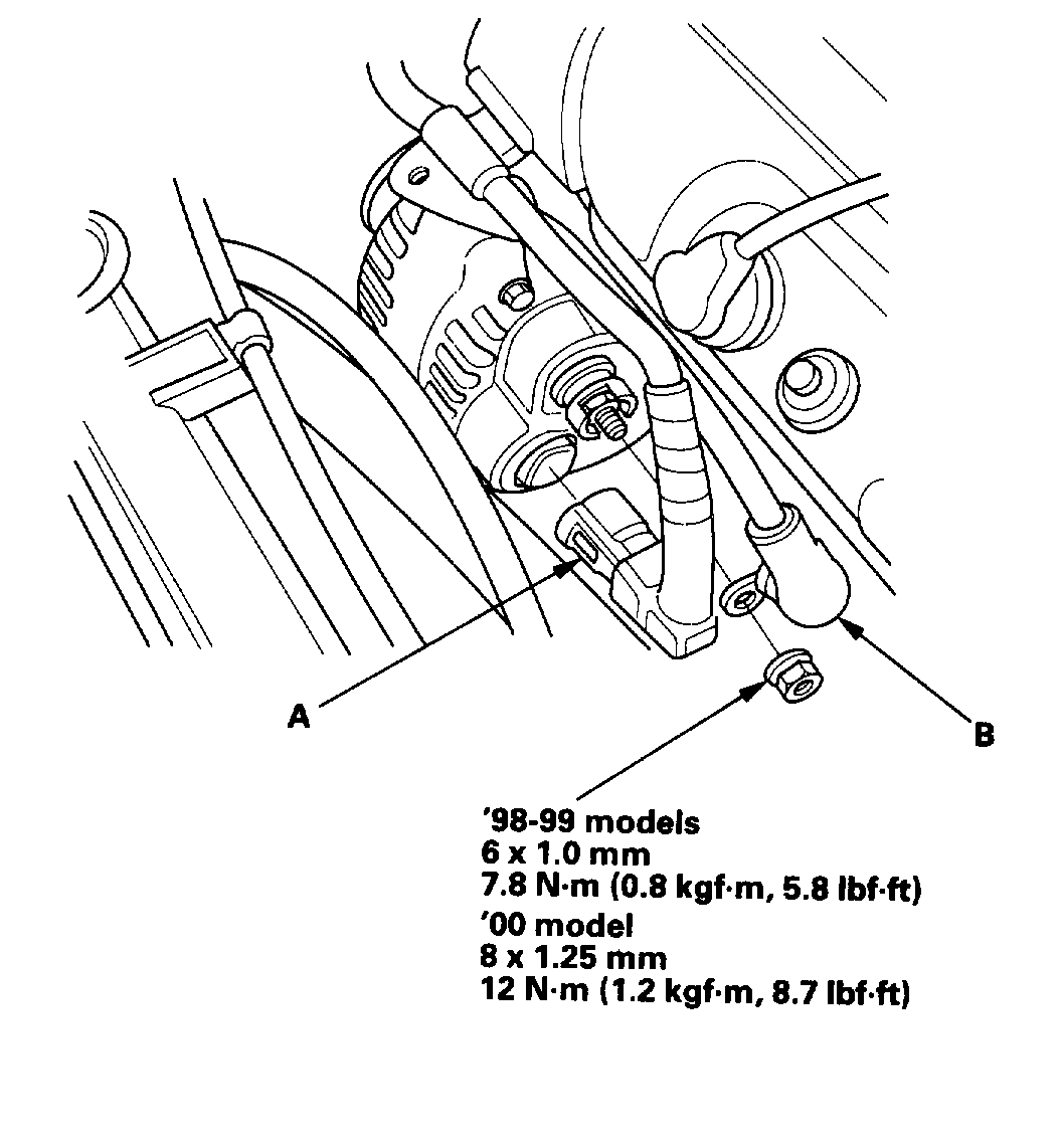

Alternator Replacement
1. Make sure you have the anti-theft code for the radio, then write down the frequencies for the radio's preset buttons.
2. Disconnect the battery negative cable, then disconnect the positive cable.
pic 1

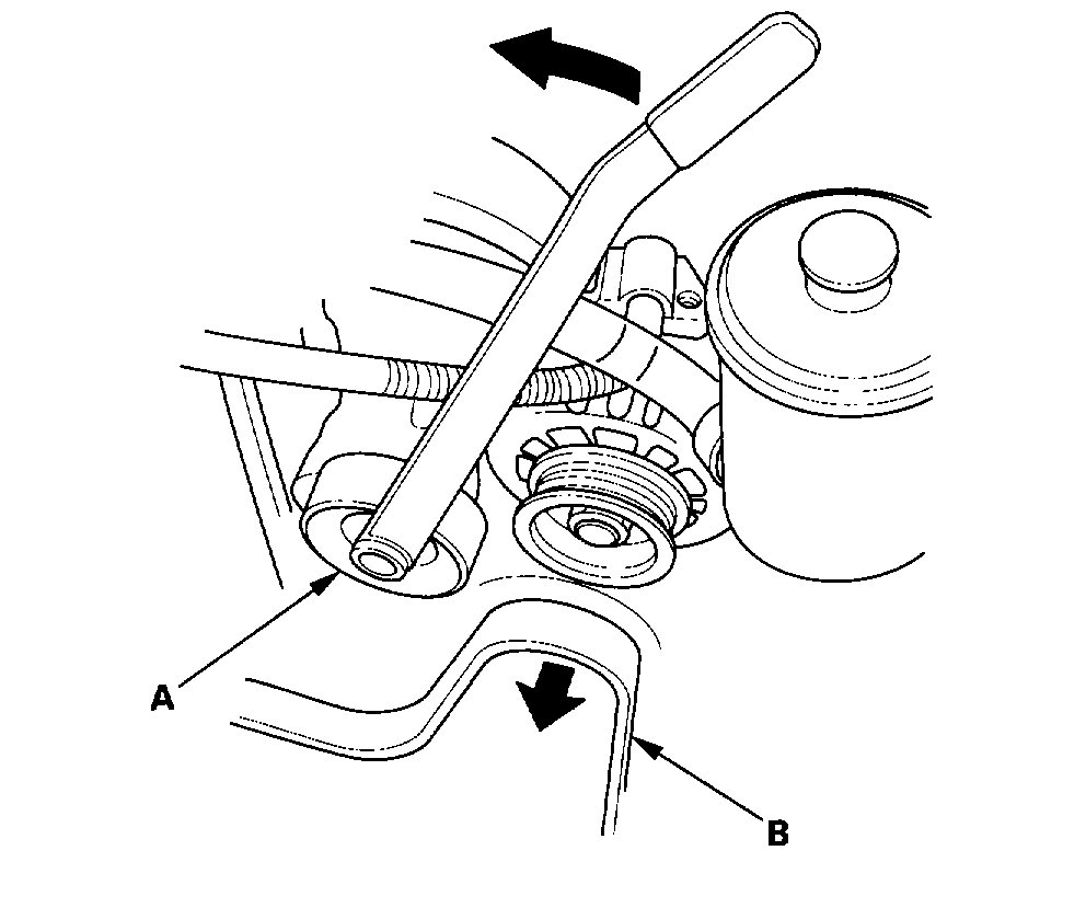

3. Move the auto-tensioner (A) to relieve tension from the alternator belt (B), and remove the alternator belt.
pic 2

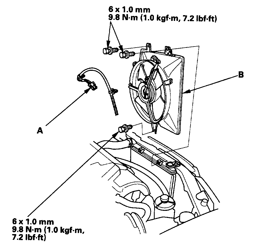

4. Disconnect the condenser fan motor connector (A) from the condenser fan shroud.
5. Remove the condenser fan/shroud assembly (B).
pic 3
6. Disconnect the 4P connector (A) and BLK wire (B) from the alternator.
pic 4
7. Remove the mount bolt (A) and alternator bracket mounting bolt (B), then remove the harness clamp (C) from the alternator bracket.
8. Install in the reverse order of removal.
9. Enter the anti-theft code for the radio, then enter the customer's radio station presets.
