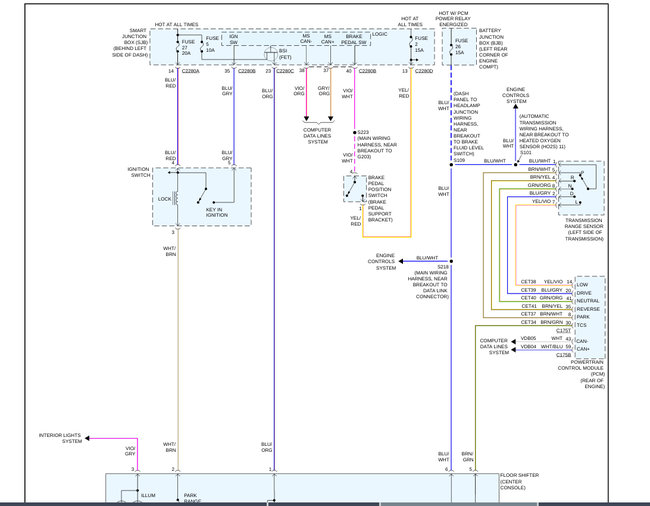

Battery drain caused by something on the circuit protected by fuse #5. Drain is 200 mill amps and drops to 10 when fuse is pulled. That circuit is called the Shift interlock and I have also pulled the power going to that solenoid and the brake pedal switch with no luck.

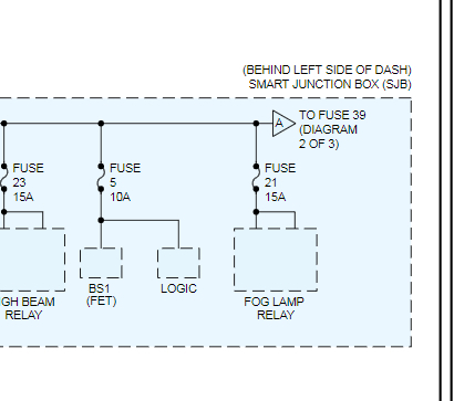

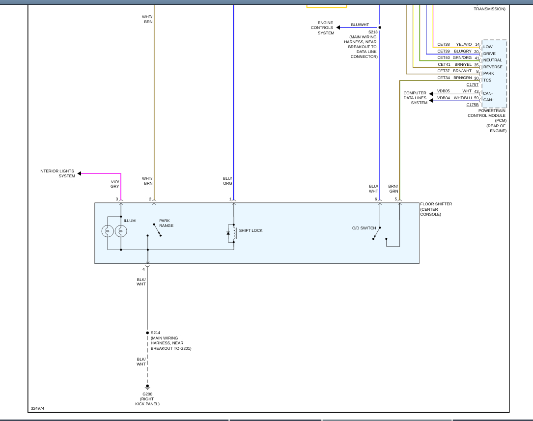

I would check the BSI FET [Field Effect Transistor] in the Smart Junction Box under the left side of the dash. I have included a wiring diagram of the shift interlock circuit in the diagrams down below.
Thanks,
Alex

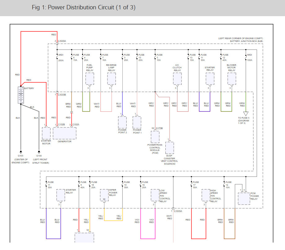

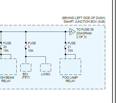

If I can jump in here fuse #5 powers the PCM and the evap purge solenoid. I would unplug the solenoid first to see if the draw stops. Here is a guide to help and the fuse wiring diagrams below so you can see. It could be the PCM is not going to sleep. I simpe CAN scan should tell us more. You can get a scanner from Amazon for about $50.00 no subscription needed.
https://youtu.be/InIlnsjOVFA
and
https://www.2carpros.com/articles/car-battery-dead-overnight

Furthermore, my vehicle is a Manual transmission so I'm not even sure what role the shift interlock plays. Is it utilized in a vehicle with manual transmission?

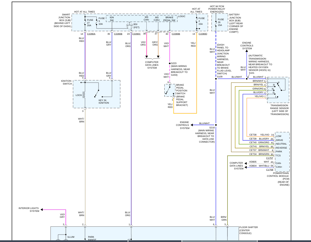

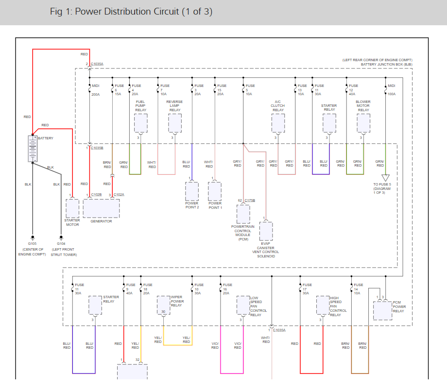

Good afternoon,
I attached the wiring diagram for you of fuse 5. It controls the purge valve and the PCM.
I would disconnect the purge valve first and see if the drain drops. 50 to 75 milliamps is a normal draw.

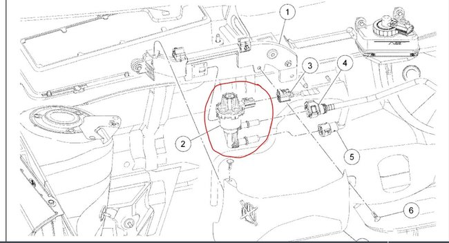

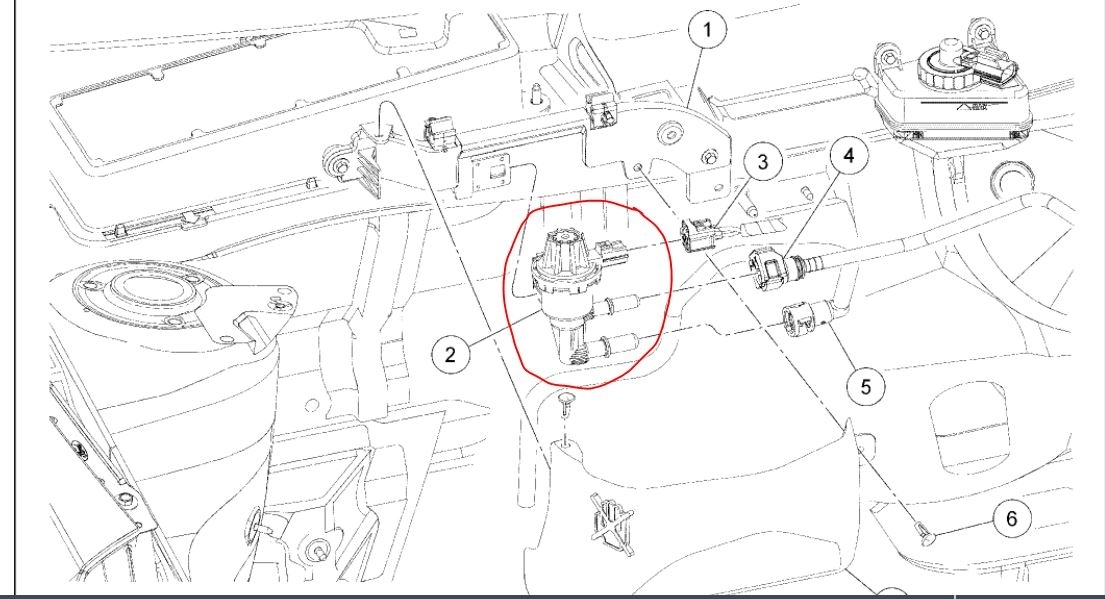

I attached the location of the purge valve for you.

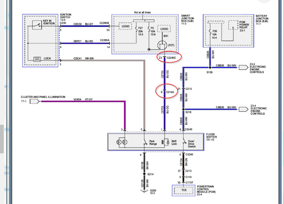

Hopefully they will get back to you but in the mean time lets try this:

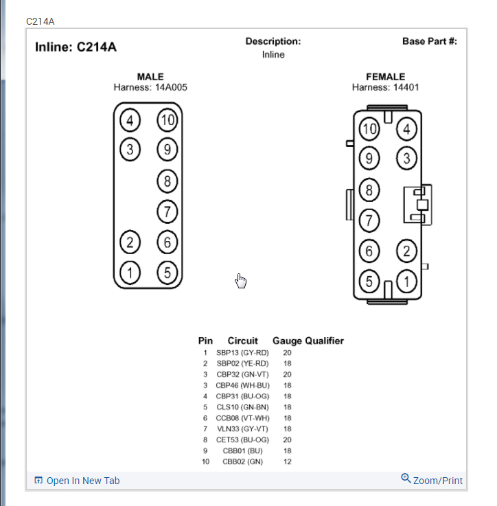

So you are removing the fuse from the smart junction block under the dash and not the one under the hood? If this is the case, you are correct that this vehicle would not have a shift interlock. However, if you look at the wiring diagram this fuse actually feeds the FET and the logic board for the SJB before the interlock. Also, there are two connectors that could have water intrusion in them. We need to go to connector C214A and disconnect it and I bet the draw does not change. If it does not then the SJB is the issue.
Let me know what questions you have.
