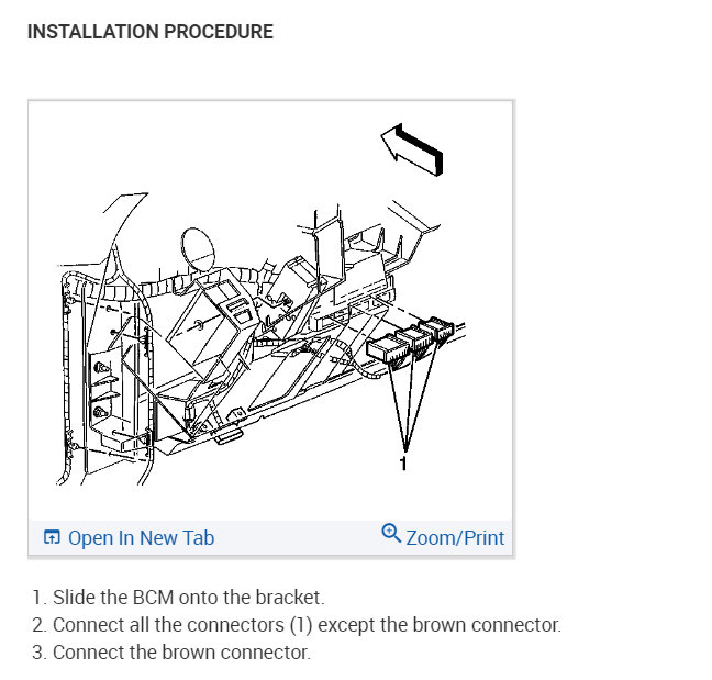

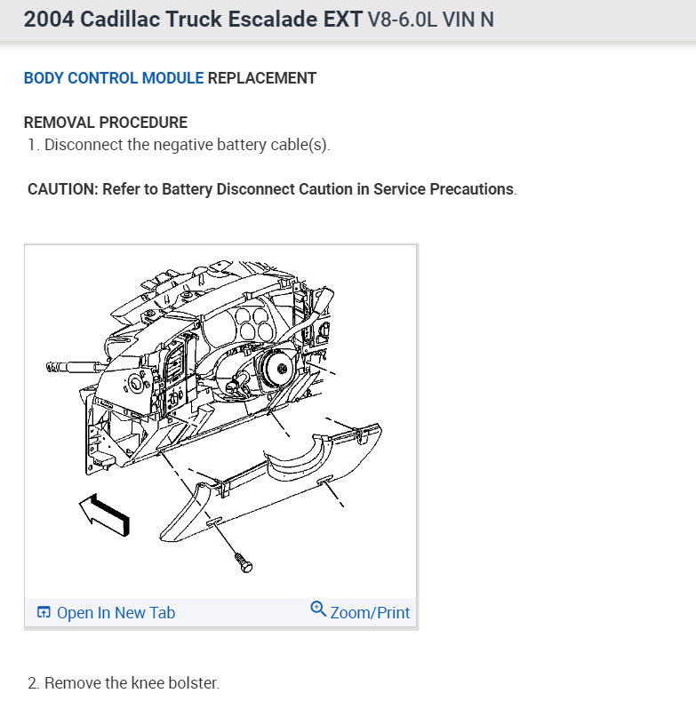

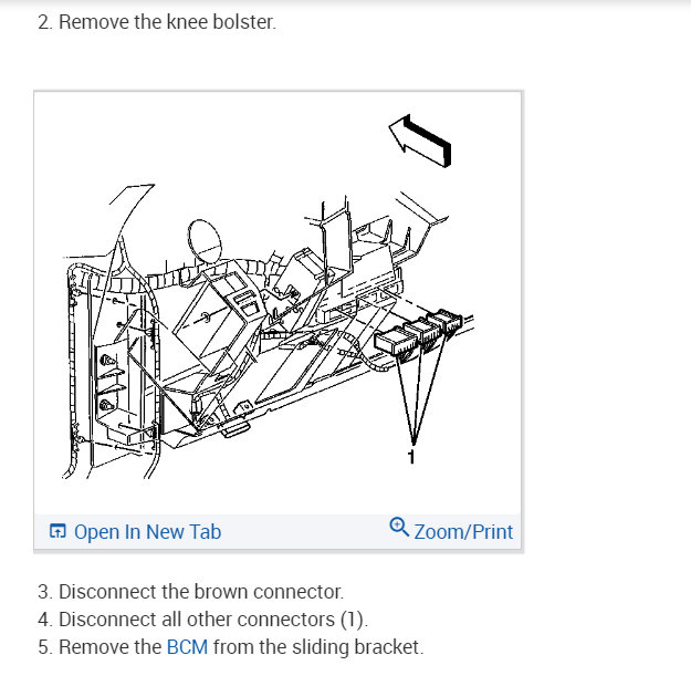

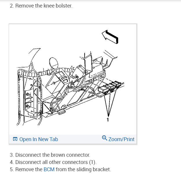

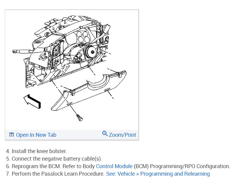

The b1480 code is the Battery Rundown Protection is not working so yes this will cause the battery to run down. You will need to replace the BCM here are the instructions in the images below.
Here is how you set the new BCM up:

Check out the diagrams (below). Please let us know if you need anything else to get the problem fixed.
