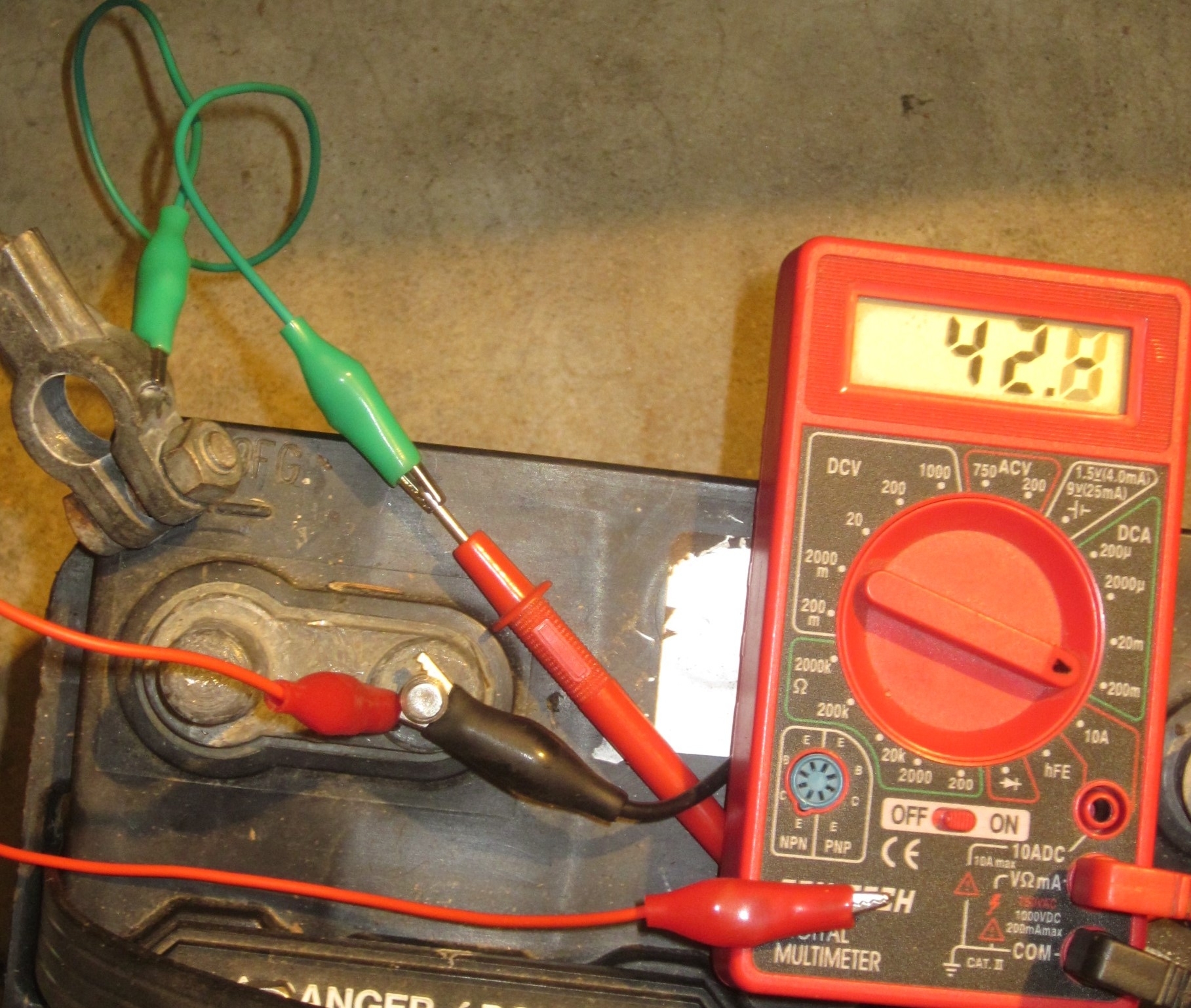

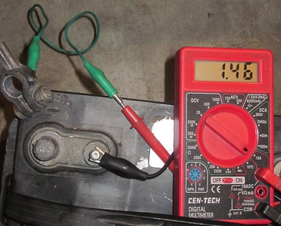

For the benefit of others researching this topic, I put these photos together to explain the procedure better. In the first one, the meter is connected in series with the battery. We normally remove the negative cable from the battery post because if the wrench touches anything metal at the same time, nothing will happen. This can work with the positive cable too, but you must be careful that the wrench never touches the cable and anything metal on the vehicle at the same time. My black meter probe has an alligator clip on it, so it is easy to connect to the extra stud on the battery. The red positive probe needs the green clip lead to keep it connected to the cable clamp. That's just used so I didn't have to stand there and hold it. The meter is set on the ten-amp range. That range is not protected with a fuse, and it requires the red meter lead be moved to the special 10-amp jack. Current drain is 1.46 amps.

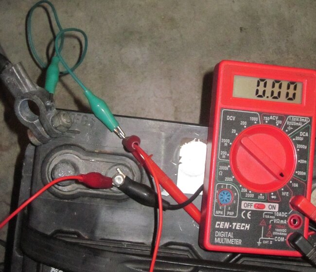

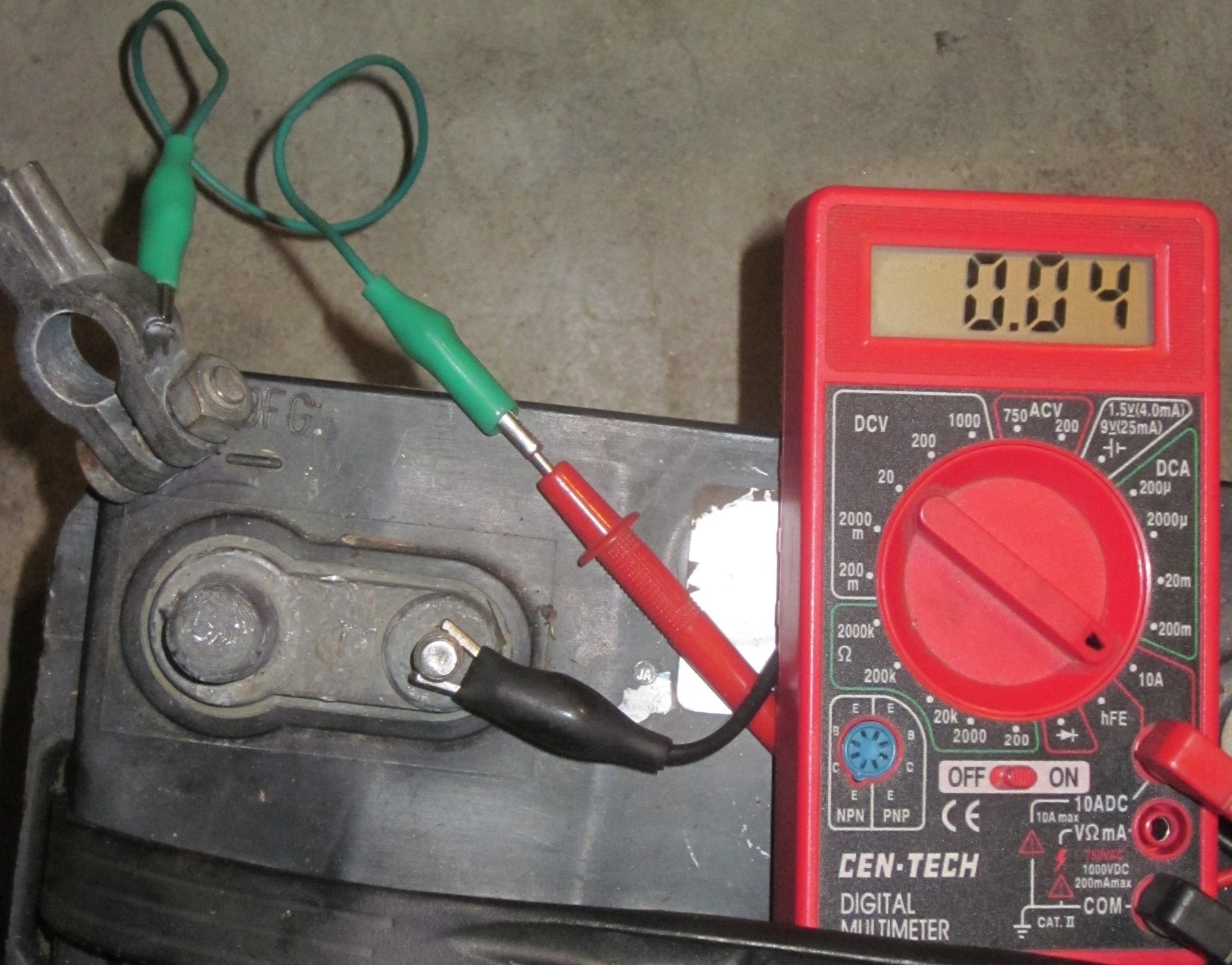

The only thing that has changed in the second photo is current drain dropped to .04 amps, (40 milliamps), after roughly 20 minutes. To get more accuracy, it is necessary to switch to a lower range on the meter. In the third photo, the red jumper wire has been added between the two meter leads. Since current takes the path of least resistance, it goes through the red jumper wire instead of through the meter, so the meter is seeing 0.00 amps.

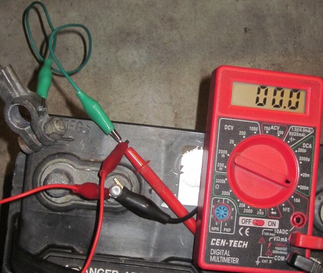

In the fourth photo, the red jumper is still in place, but the meter has been switched to the 200 milliamp range, and its red probe is moved back to the common jack on the meter. That jack is used for all of the meter's functions except for the ten-amp current range that was just used.
As a side note, there's two things the meter can do to start the time-out procedure all over. One is to unplug the red probe to move it from the ten-amp jack to the common jack. Unplugging it breaks the circuit. The less-known issue is all digital meters use a "break-before-make" style rotary switch for selecting ranges. That means as you turn the knob, the internal switch contacts break the connection to one range, then, as you continue turning, it makes the connection to the next range. That momentary break in the connection starts the timeout again. Current can go as high as three amps again for up to another 20 minutes. The meter is capable of handling the over-range condition, however, most of them have 2-amp fuses in line with the common jack. Current can easily exceed two amps and blow the fuse. At that point, no meter functions will work other than the ten-amp range.
In the last photo, the red jumper wire has been removed on one end. Current has to flow through the meter, but the current path has never been interrupted so all the computers have remained in sleep mode. On this lower range with much more accuracy, current is 42.8 milliamps.
