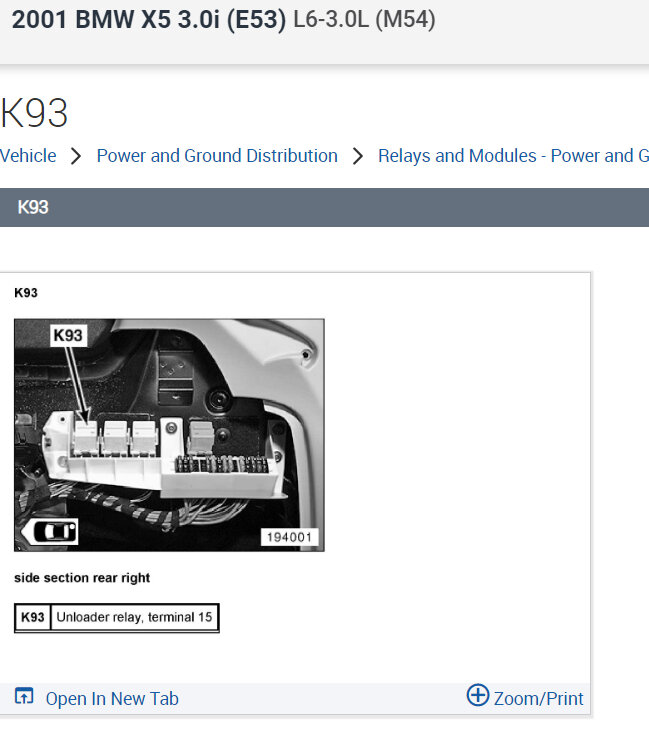

Yep, something is staying on. I have seen the Unloader relay stick on causing this problem in these cars. But you should check to see if anything is warm with the car off like the alternator. Make sure a CD is not stuck in the player as well. Here is a guide to help and I have included the location of the relay so you can remove it to see if anything changes.
https://www.2carpros.com/articles/car-battery-dead-overnight
Check out the images (below). Let us know what you find.
