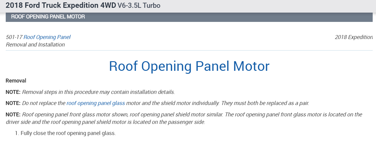

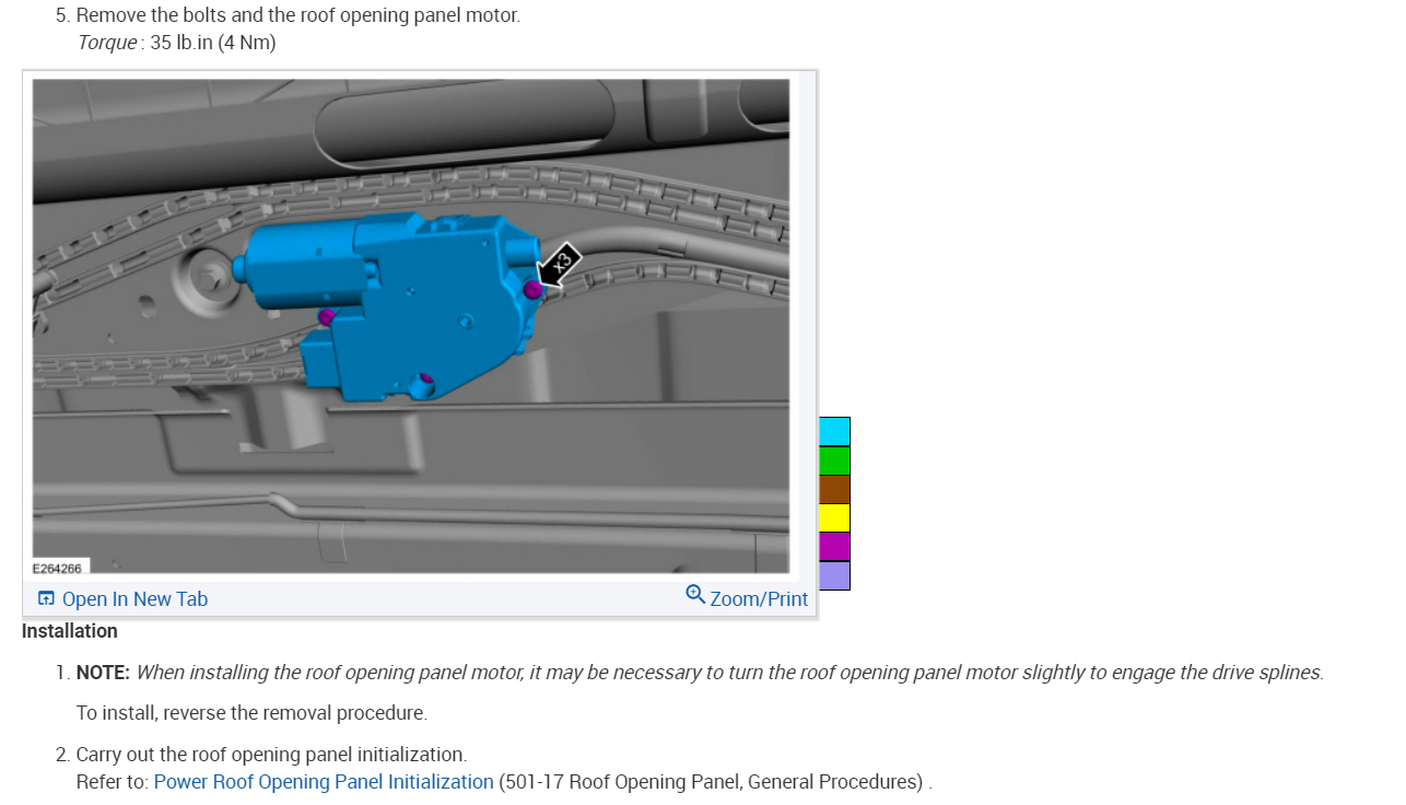

Did the old motors work? If so, there is a startup procedure that must be performed, I have included the sunroof motor replacement instructions as well in the diagrams below.

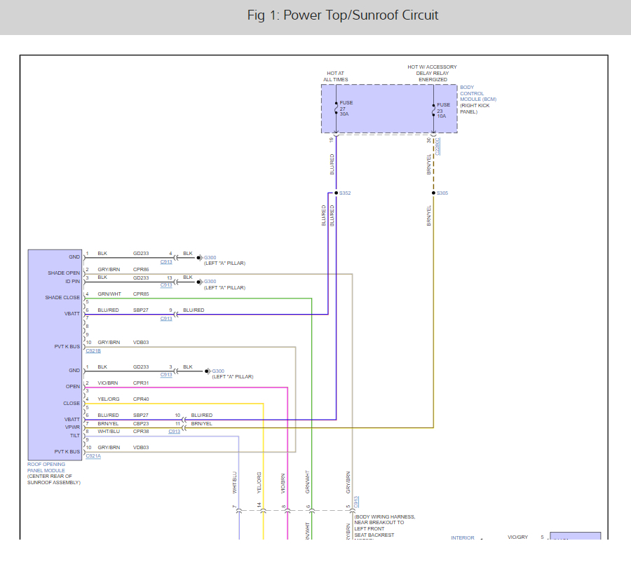

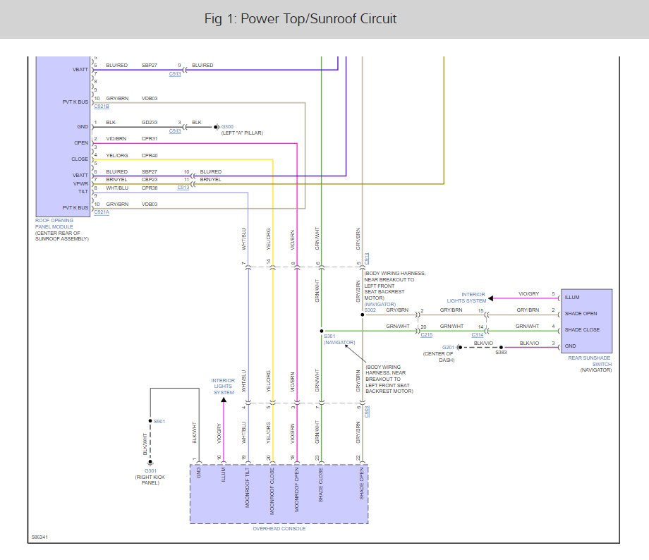

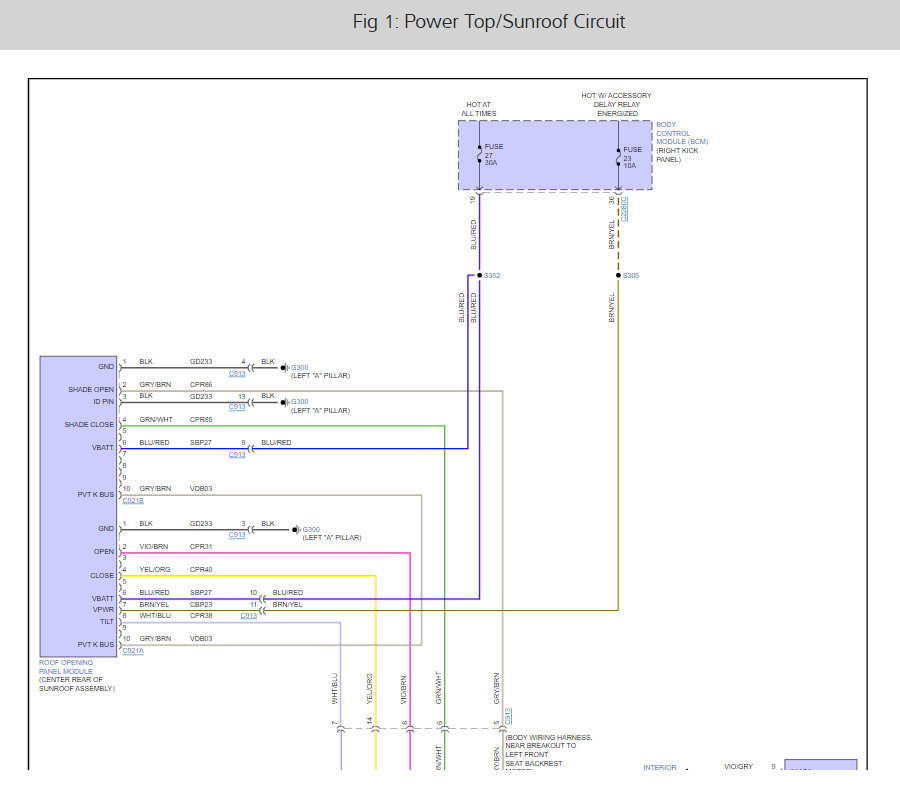

That might be difficult to test the motor because it looks like the controller is interrogated into the motor. Here are the wiring diagrams so you can see how the system works. Check out the diagrams (below). Please let us know what happens.

So, I studied the diagram, and on a whim swapped the glass motor and the shade motor and it works. Thanks for your help.
