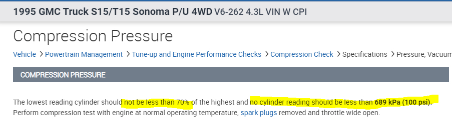

It sounds like you've done a lot already. Since the misfire is consistently cylinder 5, there could be a compression issue. If it exceeds a specific allowable difference, it will cause a misfire.
I looked it up for you. No cylinders should be below 100 psi. Also, the maximum variation between the highest and lowest readings is 30%. Once you go beyond that, chances are you will have a misfire. (See pic below).
If you haven't already, I would recommend trying this. Here is a link showing how to do it. You will need a compression gauge, but most parts stores will lend one to you.

Thank you. I did a compression test. All compression read between 130-135. Still getting code. Not sure if it's gasket now or catalytic converter. I say this because when I scan the code gives me p305 then says EGR, O2 heat sensor and mil. I'm not sure what that is if I have changed out O2 sensors and EGR valve. Anyway, thank you again for the help.
