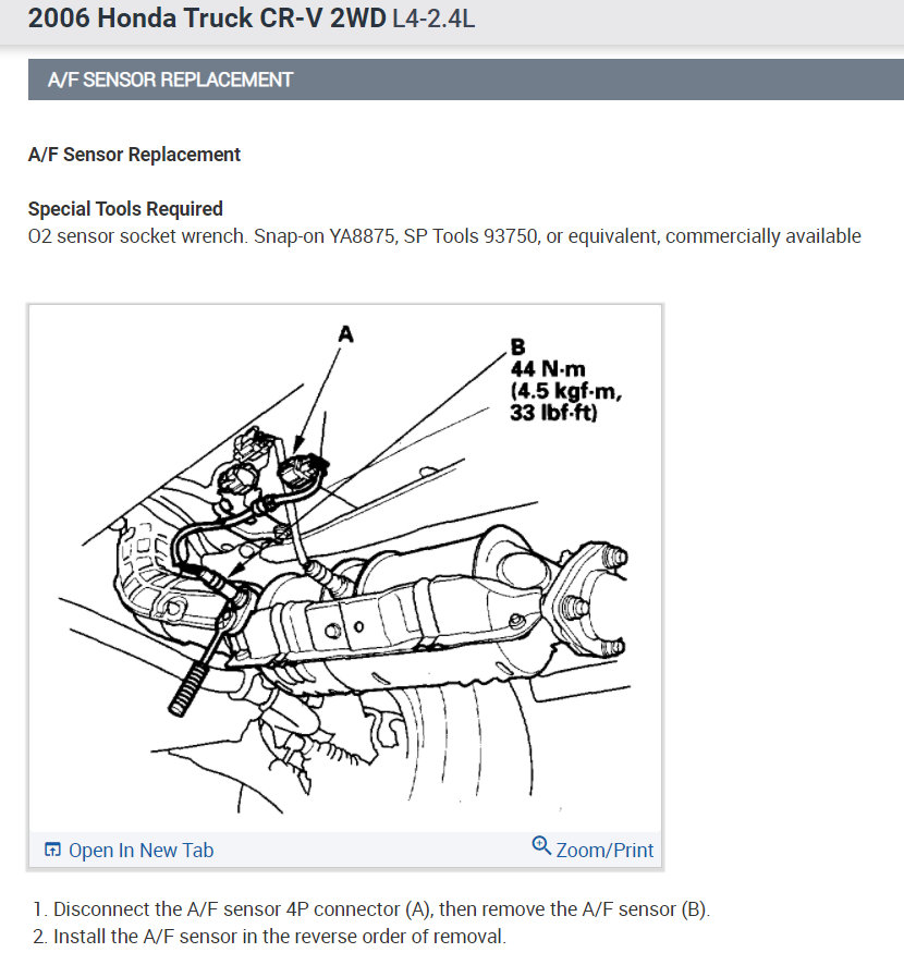

The check engine light is on and the coded read p2a00 and p1172. I have read online that this can indicate the upstream sensor is failing. Is this correct? It also says a software update is required, is this also correct?

Yes, it sounds like the primary oxygen sensor has failed. Here is a guide to help you step by step with instructions in the diagrams below to show you how on your car:
https://www.2carpros.com/articles/how-to-replace-an-oxygen-sensor

I have to order the upstream sensor but the online is recommending ordering the downstream as well. Do I need to replace both if only the upstream is sending the code?
Apr 4, 2021 at 9:49 AM
I would just do the upstream sensor first to see what happens.
