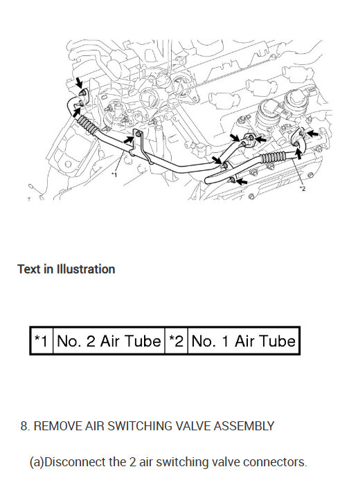

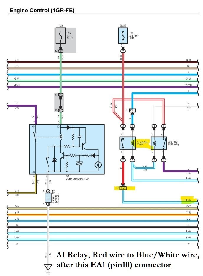

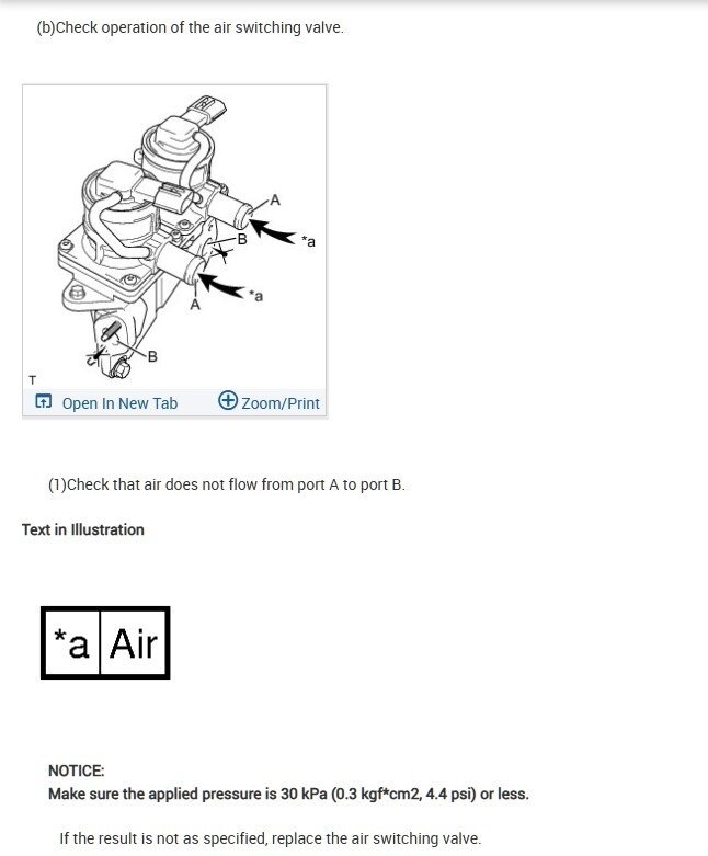

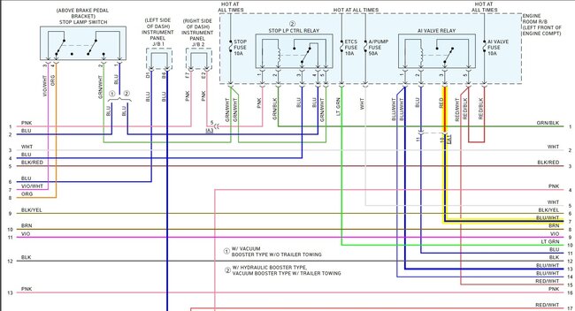

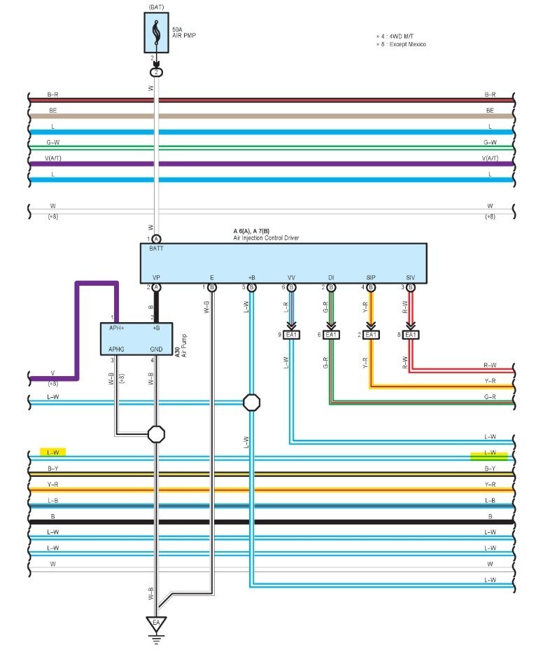

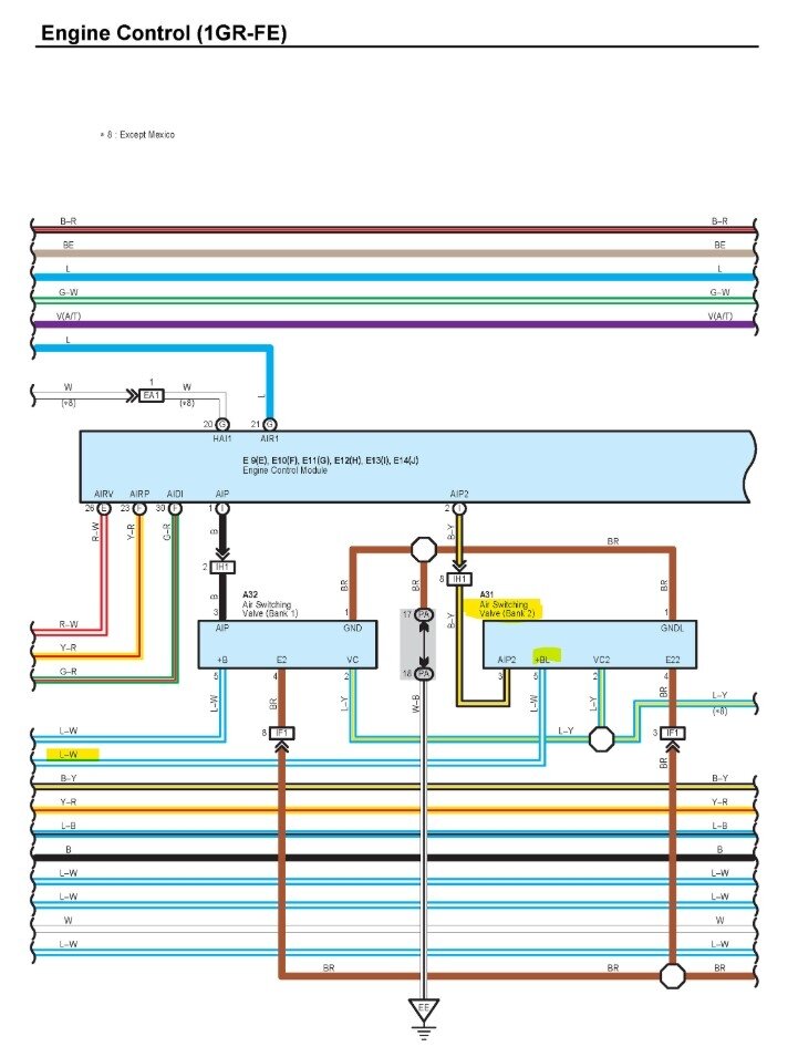

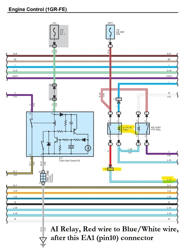

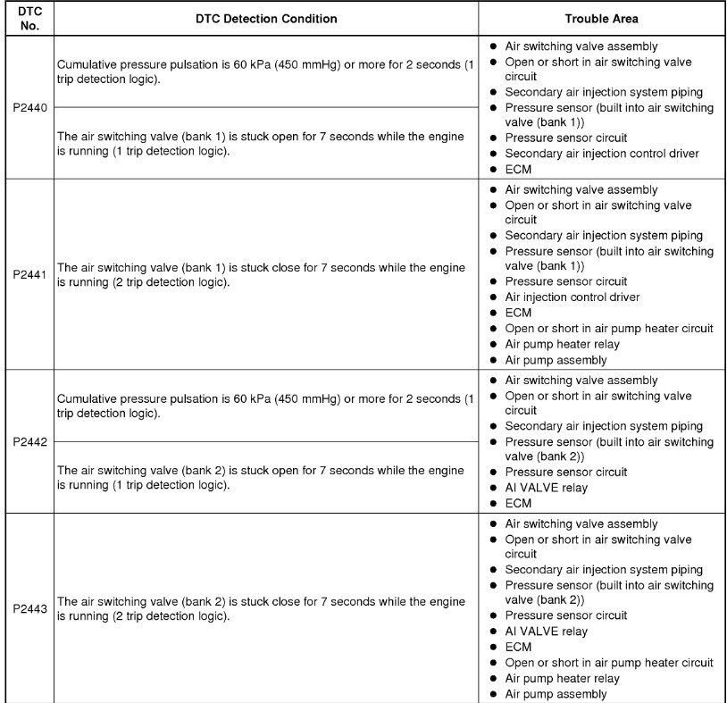

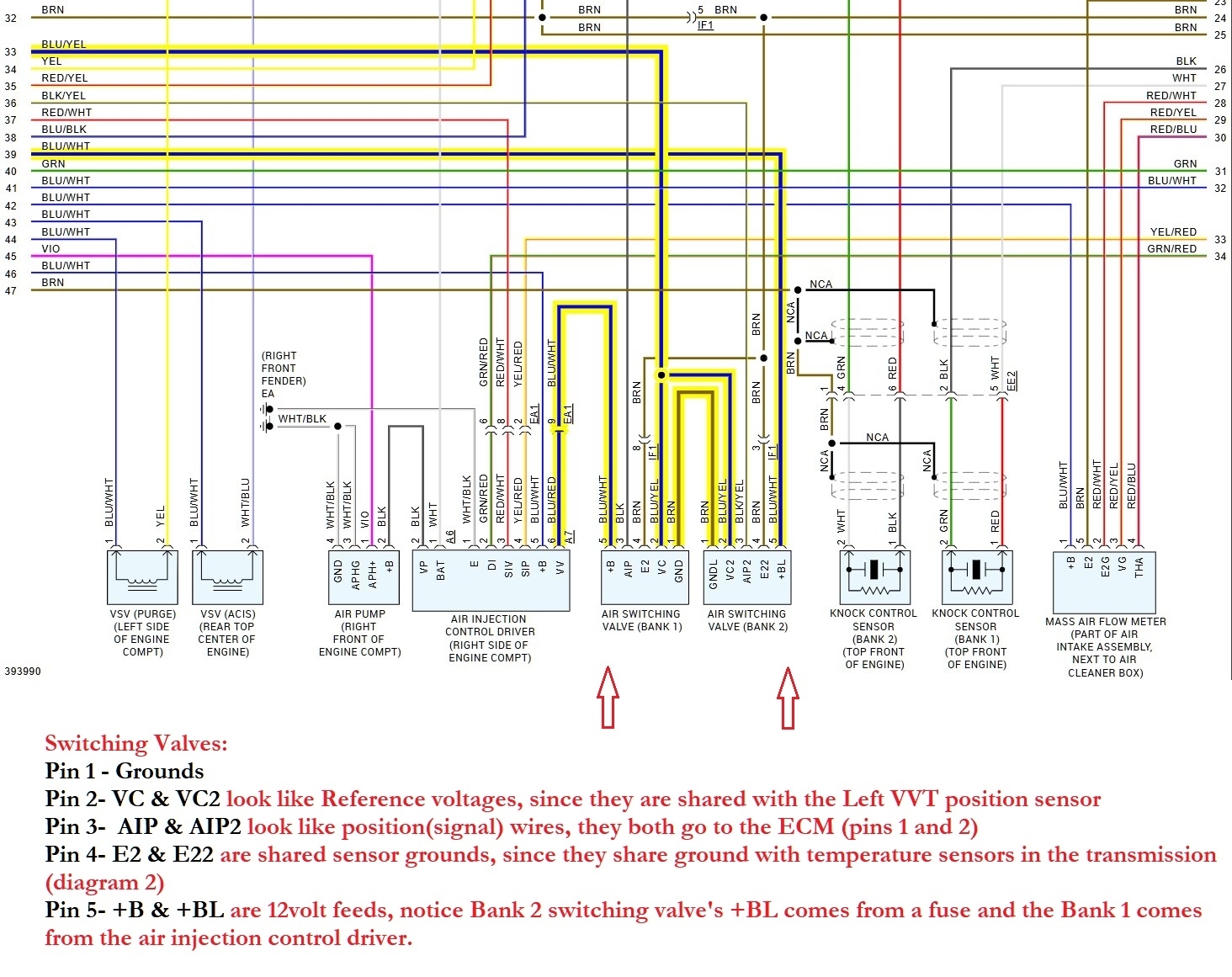

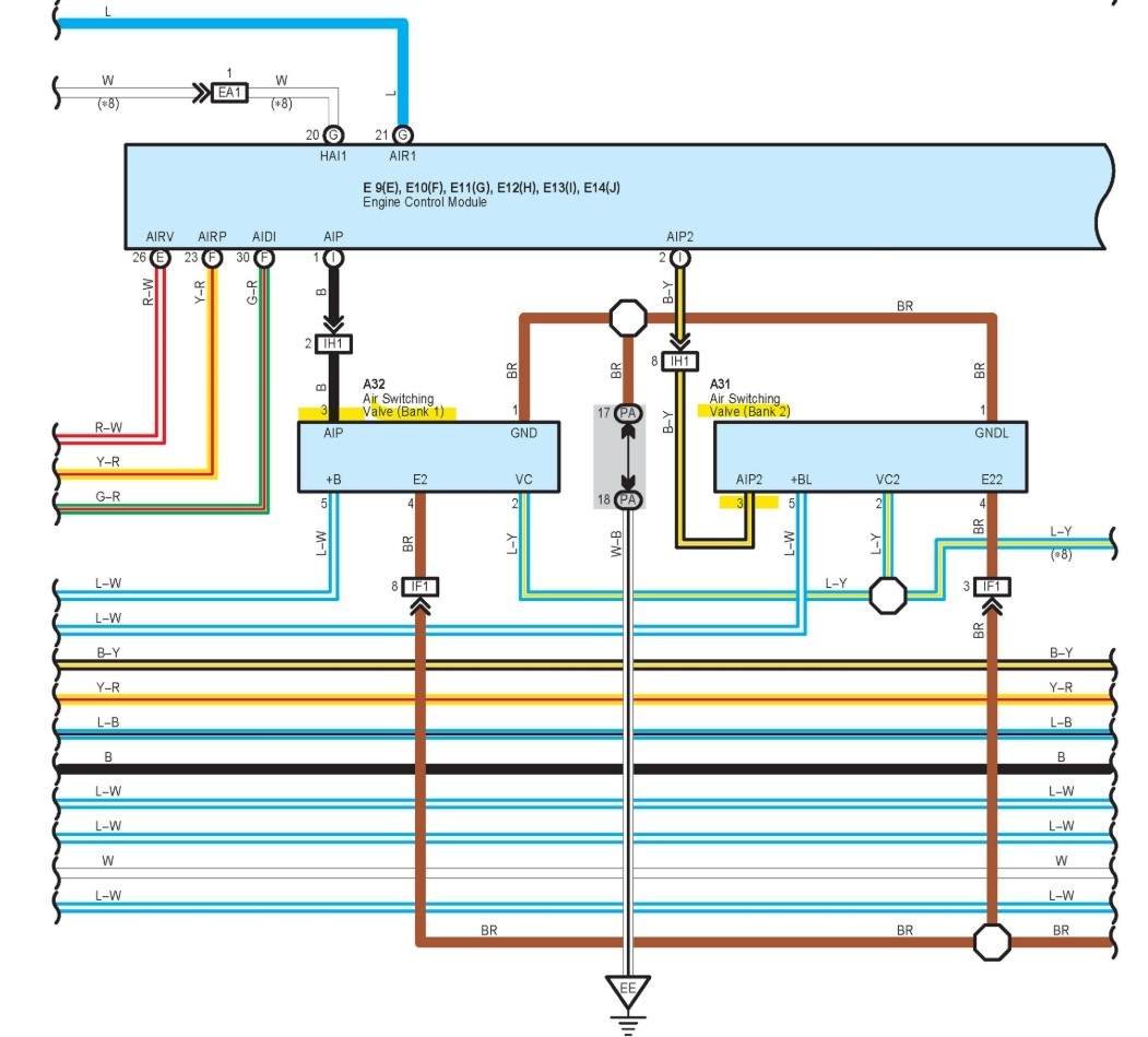

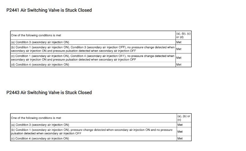

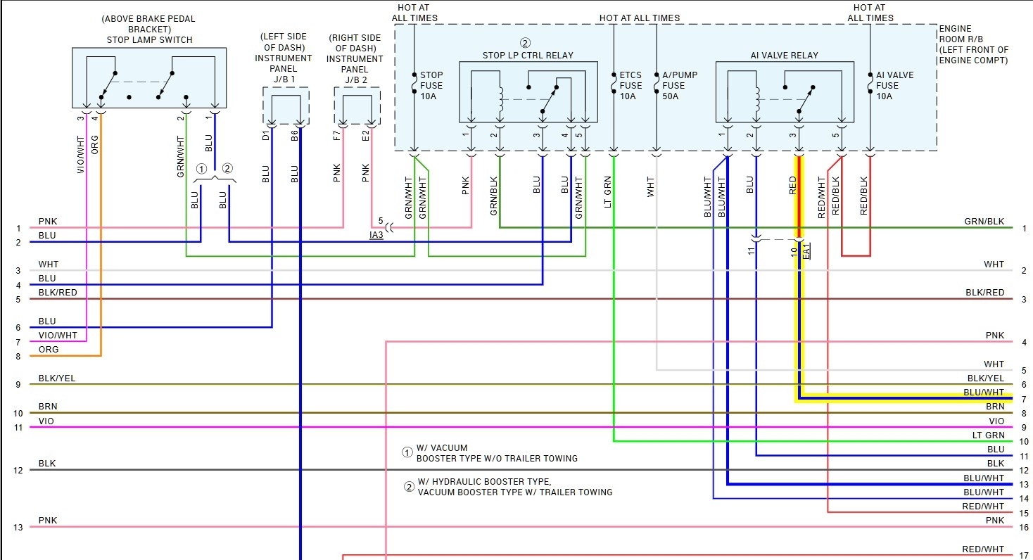

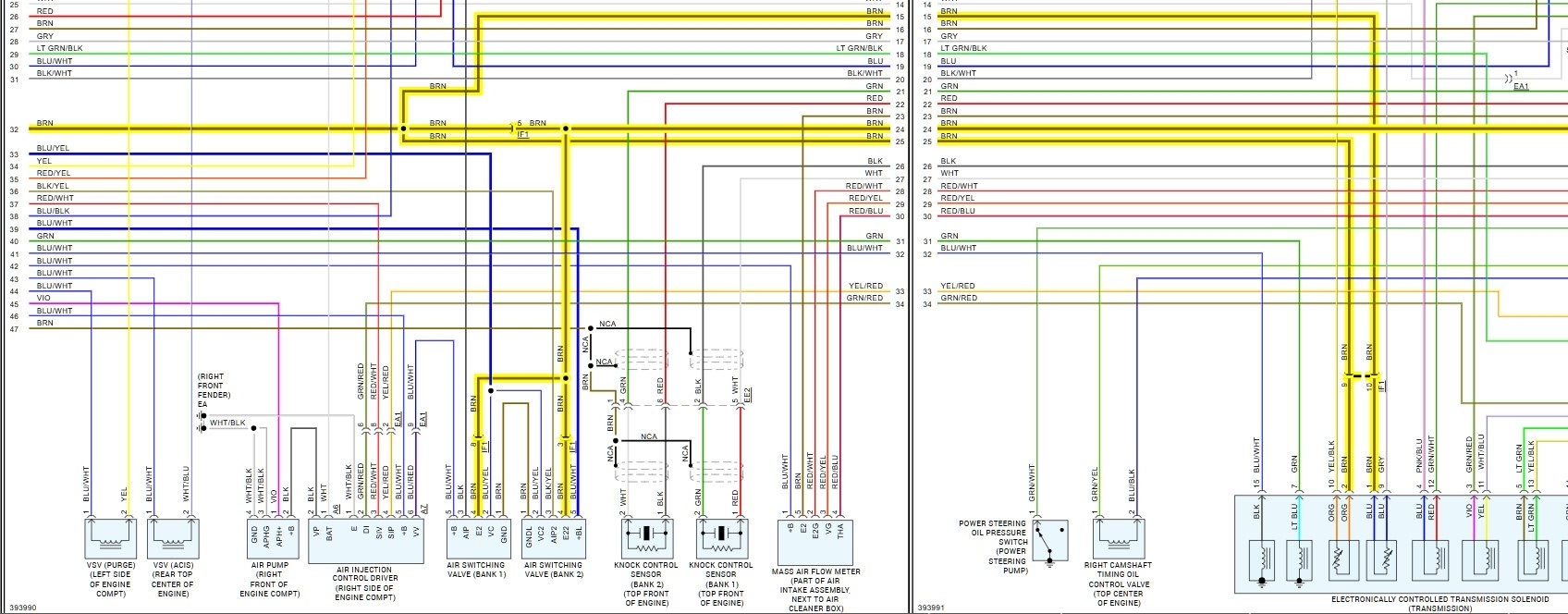

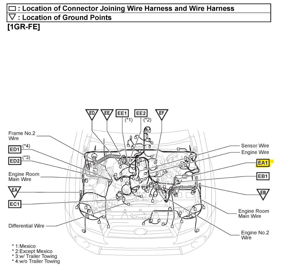

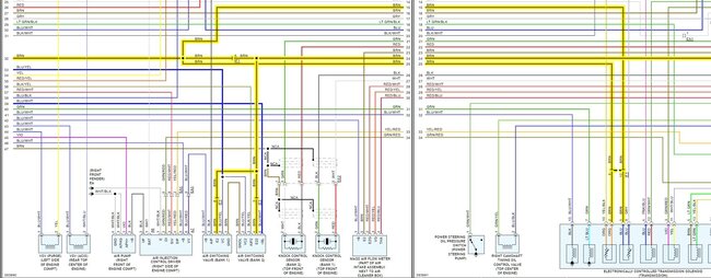

Hello, so obviously there's two switching valves one for each bank and an air pump, I'll put up the wiring diagrams for them both, each has a pressure switch in them for the control module to detect changes when opening or closing each valve, from the diagrams I'm seeing , each switching valve has a B+ and they share a ground, it looks like the bank switching valve gets power from the control module, whereas bank 2 valve might have its own B+, so those are things to check first, since you're getting a stuck closed code and a stuck open code, which take a number of seconds to set, the valve might be not reacting in time before setting codes or its intermittently sticking.
It also looks like each switching valve has a reference voltage for the pressure sensors which would be logical, a Ref voltage, Signal, and Ground for 3 wire sensors, or 2 wire pressure sensors use a Ref voltage as well, somewhere between 5v and 12v. You will see which wires are B+ and ground, etc., on the diagrams.

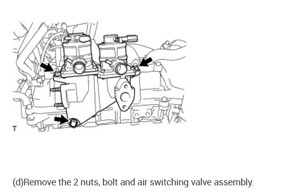

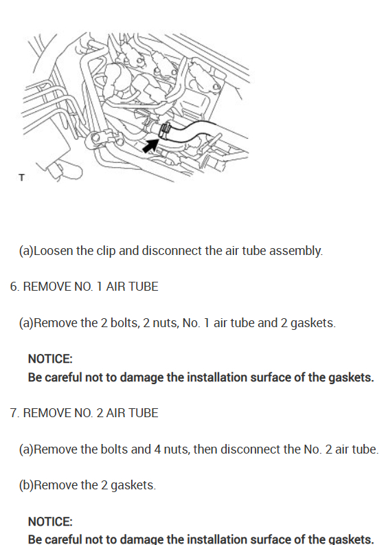

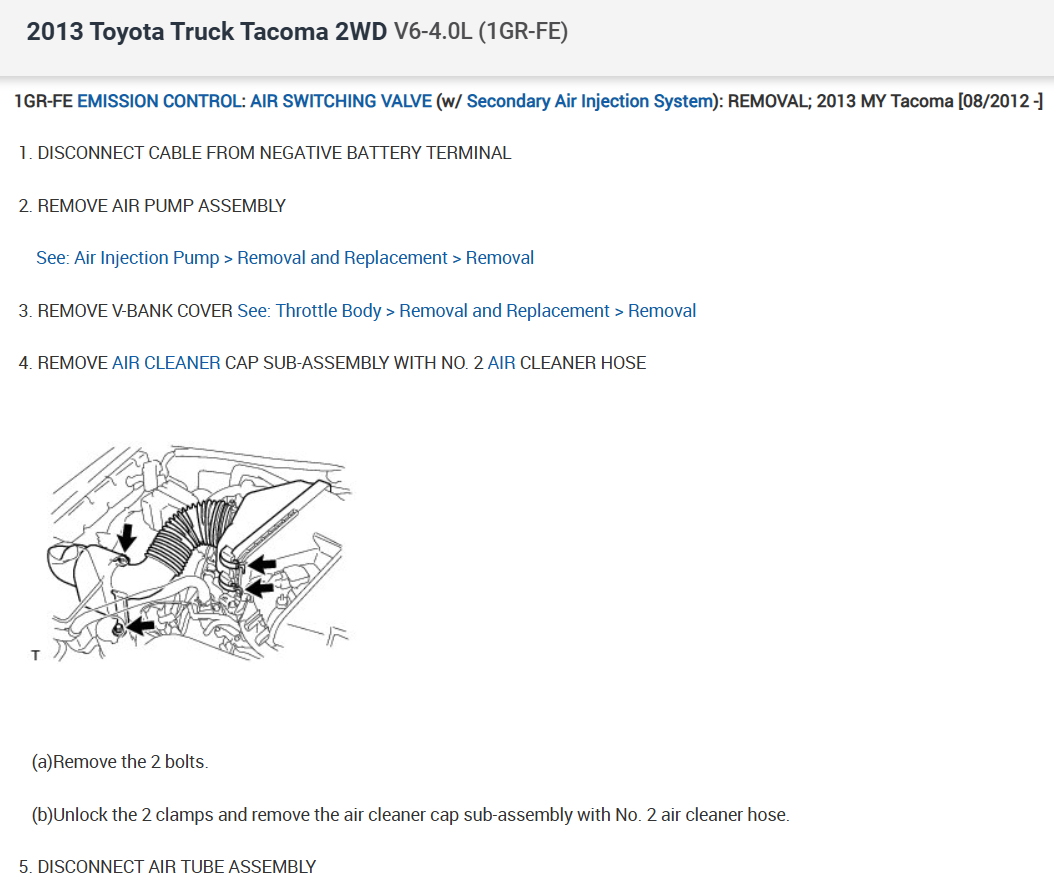

Load testing the B+ and Grounds would be the best place to start, using a higher amperage test light, such as a head lamp bulb, turn signal bulb, something that will pull a few amps. Let me get diagrams together for you but check each switching valves connectors for any possible oil or water intrusion, I find oil in these when the valve cover leaks, oil also effects the rubber hoses going to the air pump or valves when that happens as well.
