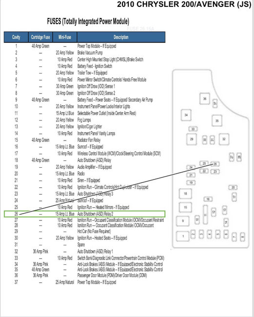

Can you please check fuse 26 in the TIPM?

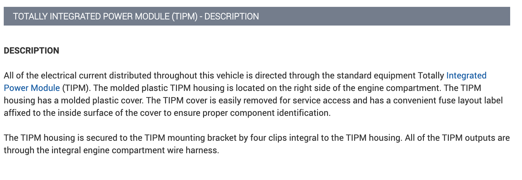

I have attached a fuse diagram and description of TIPM location.
A guide below will run you through testing the fuse.
Let us know how you go and we can run through further testing.
Regards, Joe
