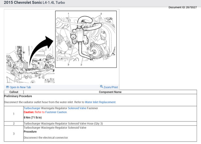

Code p0243? turbocharger wastegate solenoid?
2015 CHEVROLET SONIC
55,000 MILES • 2WD • AUTOMATIC
BHAMDOC1973
  • 2,008 POSTS
Is this a common code that is problematic for these cars and others with 1.4l?
Mar 25, 2023 at 5:56 AM
The diagnostic trouble code (DTC) P0243 refers to a problem with the turbocharger wastegate solenoid "A". Check out the images (below). Please let us know if you need anything else to get the problem fixed.
