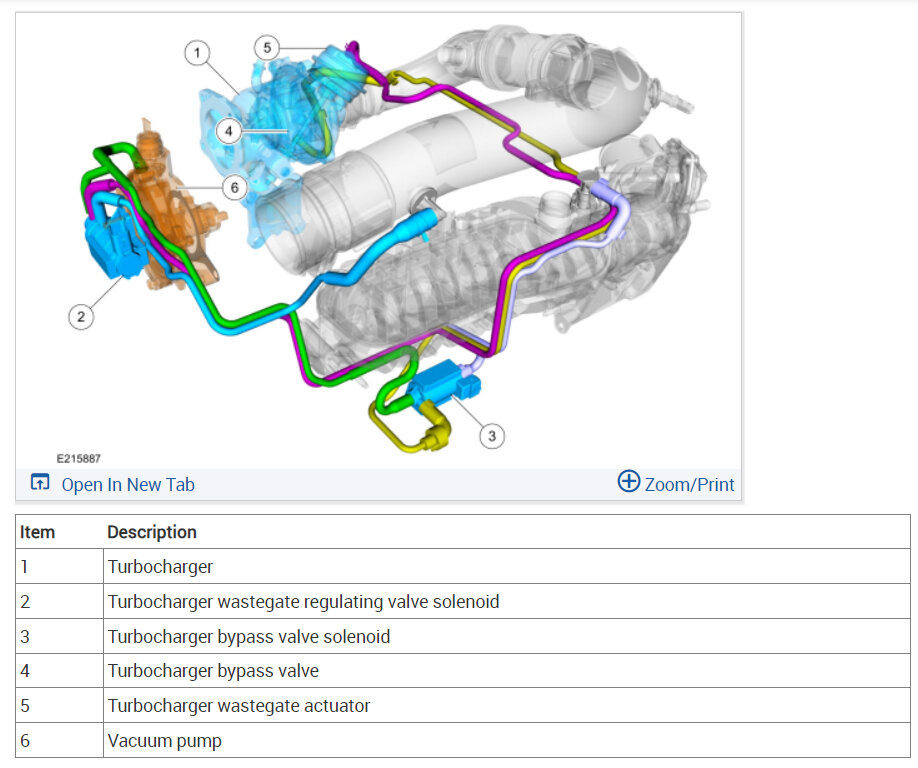

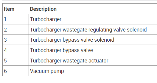

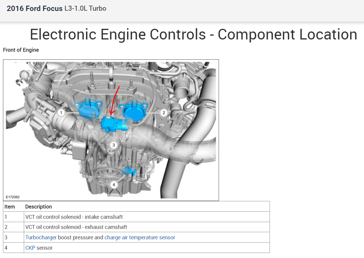

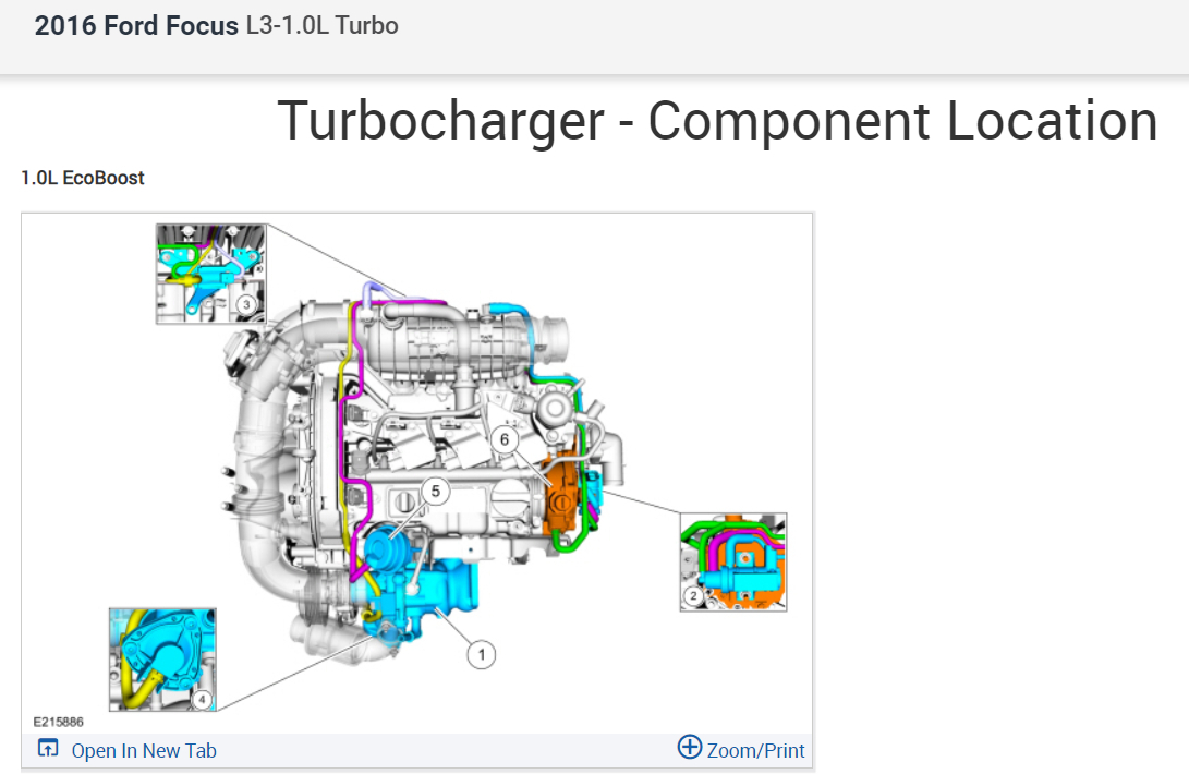

P2227: Barometric Pressure Sensor "A" Circuit Range/Performance. So the stalling has something to do with it and these sensor codes, I would inspect the turbo tubing and boots to see if there is a tear or hole somewhere in the system, this is why these codes keep coming up, also, if the turbo is bad it can leak exhaust into the intake system. The turbocharger wastegate actuator can be stuck open as well, does the engine seem to have good power like before these codes popped up? Check out the images (below). Please let us know what happens.
