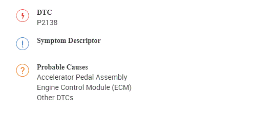

What is the problem and how do I fix it?
Aug 16, 2020 at 1:38 PM
Good afternoon,

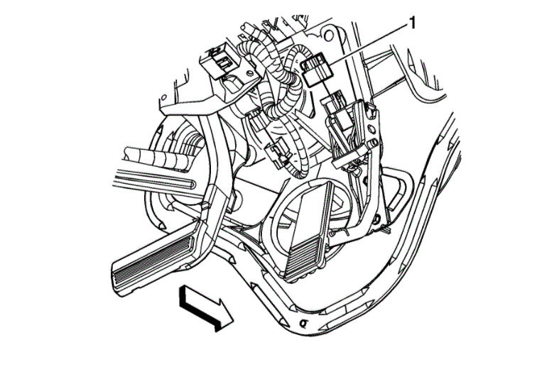

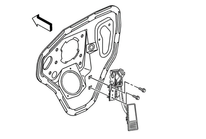

The most common cause the the pedal sensor on the fuel pedal. It is a simple fix and the part is available from your local parts store.
1. Remove the left instrument panel (I/P) sound insulator.
2. Disconnect the accelerator pedal position (APP) sensor electrical connector (1).
3. Remove the APP sensor assembly bolts.
4. Remove the APP sensor assembly from the vehicle.

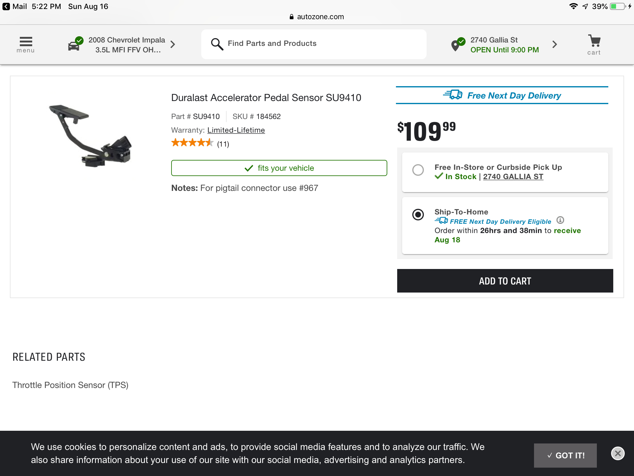

Is this the part here in pic. This is all that shows up?
Aug 16, 2020 at 2:24 PM
That is correct. That is the part.
