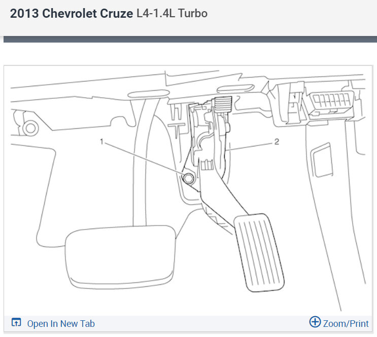

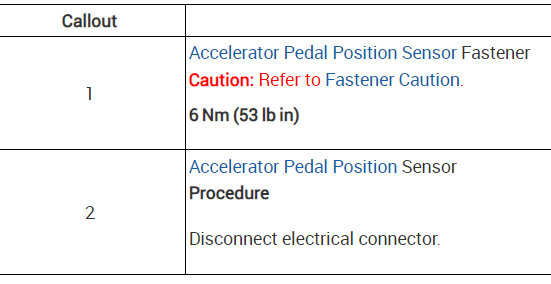

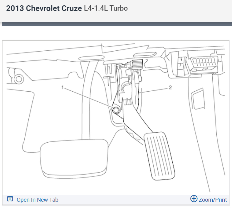

You can try getting the pedal sensor and try it first since it is the easiest. Or you can try testing the output of the sensor which I can show you.
Here is the location of the sensor. Check out the images (below). Please let us know what happens.
