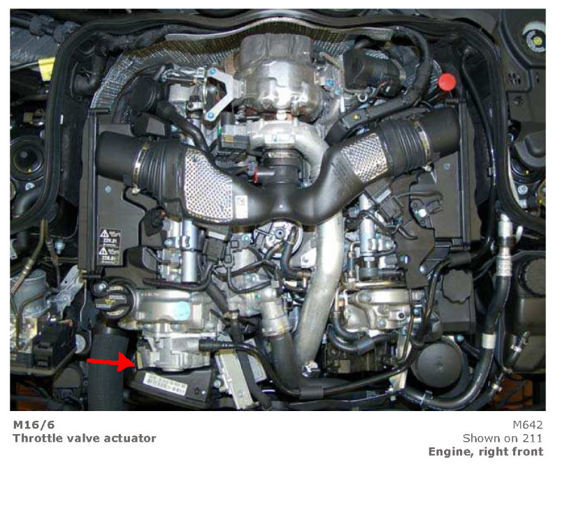

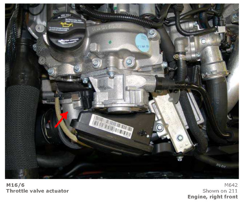

The code P2118 typically gets triggered due to a malfunction in the throttle actuator.
What issues are you having with this vehicle? Runs rough, low power?
Are there any other codes?
Usually when that code comes on the vehicle is in limp mode (low power mode).
