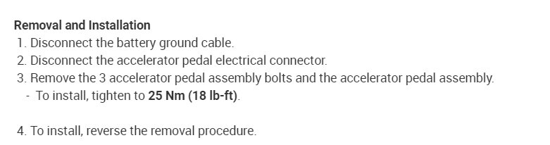

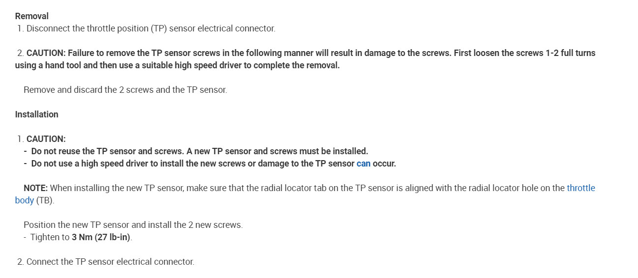

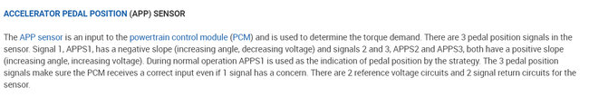

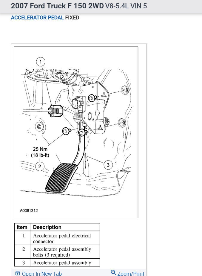

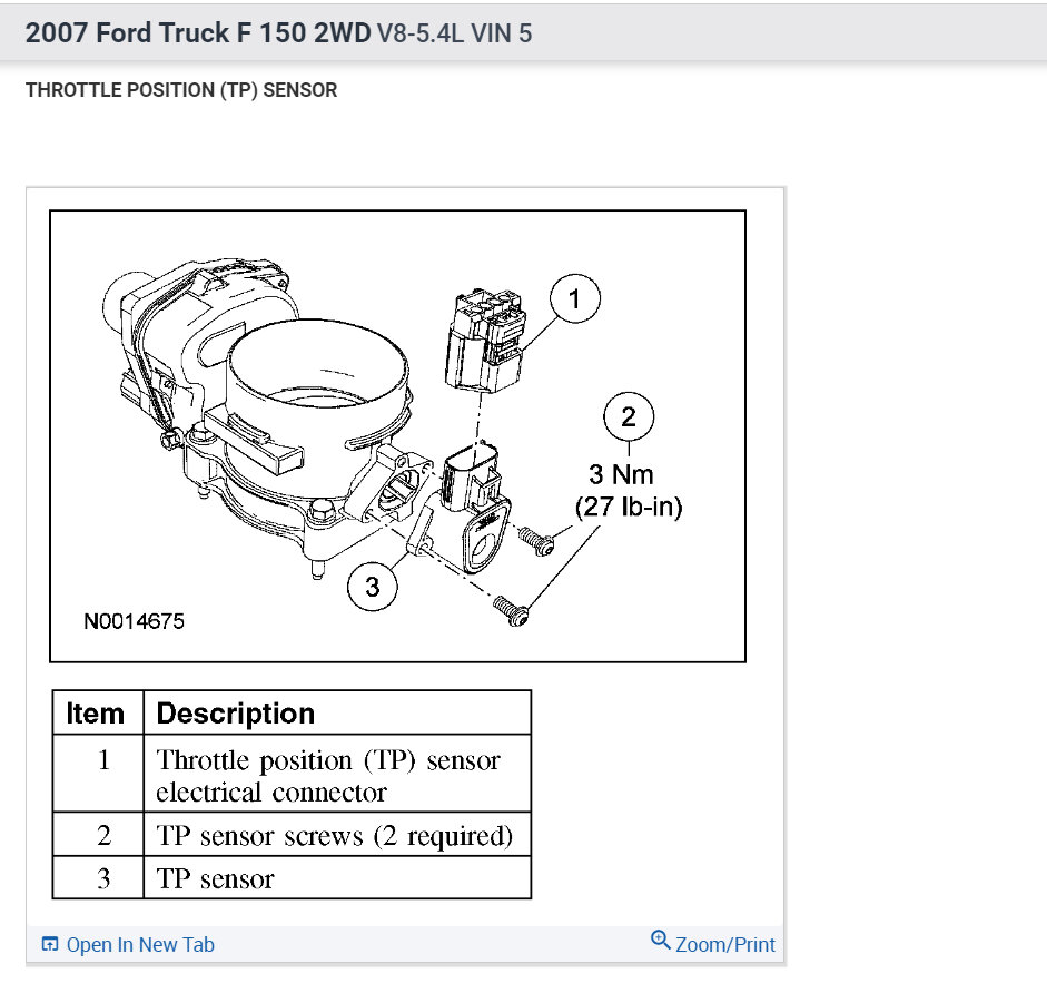

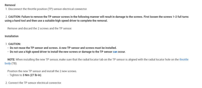

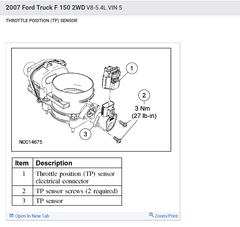

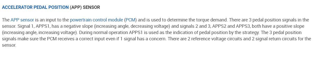

Yep, it sounds like the throttle pedal sensor needs to be replaced. Here is information for the codes and how to change out the sensor in the images below:
P2111 - Throttle Actuator Control System - Stuck Open:
P2104 - Throttle Actuator Control System - Forced Idle:
Did you get a new TP sensor with the throttle body? Check out the images (below). Let us know what happens and please upload pictures or videos of the problem so we can see what's going on.
