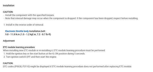

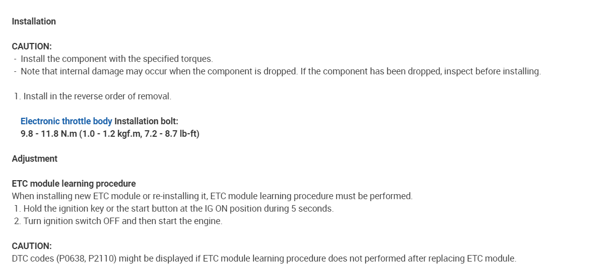

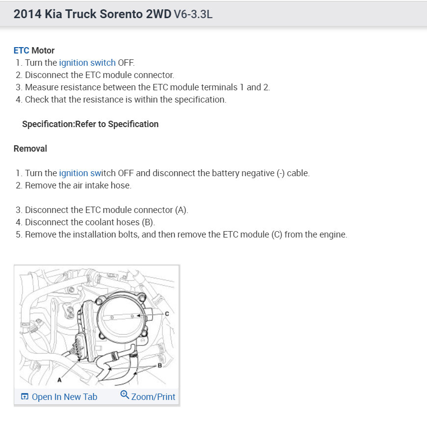

P2110 is a major failure in the throttle actuator control which will make the car not start. I would service the throttle bore first because "coking" can cause the malfunction. This guide will help you and I have included how to do the job on your car in the images below.
Check out the images (below). Let us know what happens and please upload pictures or videos of the problem.
