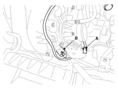

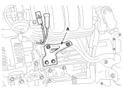

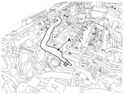

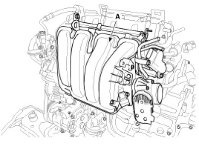

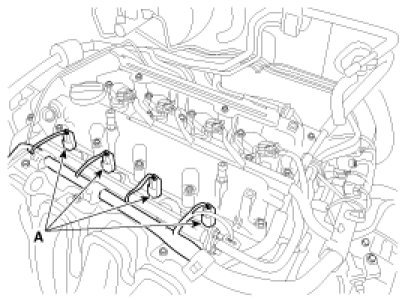

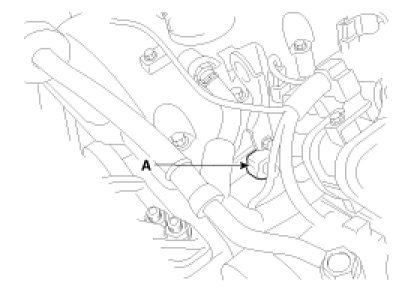

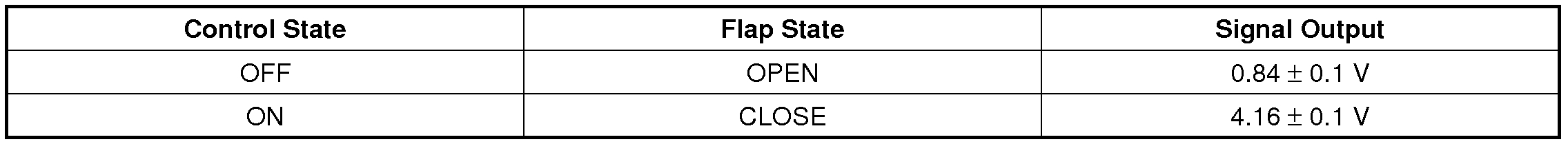

1. IG KEY "ON" and select 'Actuation Test' menu in GDS.
2. Execute 'Variable Charge Motion Actuator'.
3. Confirm the change of VCMA feedback sensor signal and the sound of operation.
Specification
Picture 1

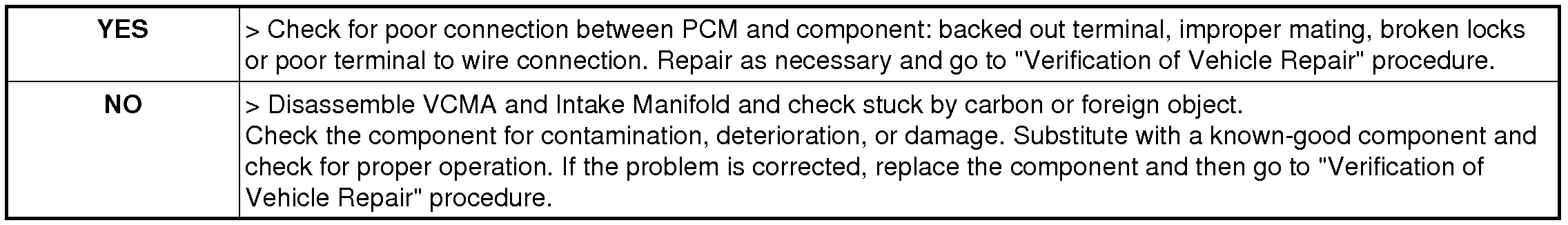

4. Is everything OK?
Picture 2
______________________________________

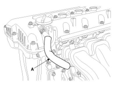

If you find it isn't working, the intake should be removed to clean and inspect the component. Yes, carbon can build up and cause it to stick. However, to fully access the component, it needs taken apart.

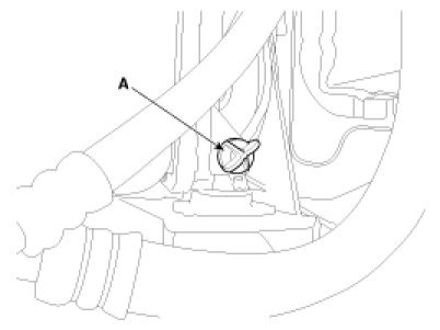

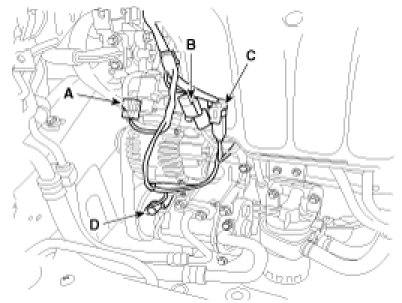

Here are the directions for removing the intake. Starting with picture 3, all pictures correlate with these directions.
_______________________________________________________________
REPAIR PROCEDURES
Removal
1. Disconnect the battery negative terminal.

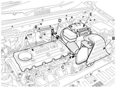

2. Remove the plastic engine cover (A).
3. Remove the air cleaner assembly.
(1)Remove the air duct (B).
(2)Disconnect the breather hose (C) and the intensifier hose (D).
(3)Disconnect the air intake hose and then remove the air cleaner assembly (E).
Tightening torque
Hose clamp bolt:
2.9 - 4.9N.m (0.3 - 0.5kgf.m, 2.2 - 3.6lb-ft)
Air cleaner assembly bolts:
7.8 - 9.8N.m (0.8 - 1.0kgf.m, 5.8 - 7.2lb-ft)
Picture 3

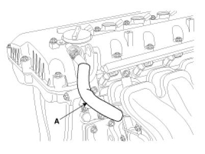

4. Loosen the drain plug (A), and drain the coolant. Remove the radiator cap to speed draining.
Picture 4 imageOpen In New TabZoom/Print

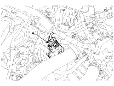

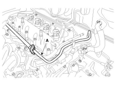

5. Remove the radiator upper hose (A).
Picture 5

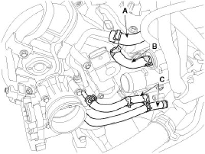

6. Disconnect the intake OCV (Oil control valve) connector (A).
Picture 6

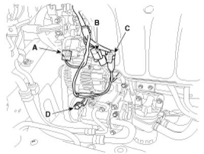

7. Disconnect the VIS (Variable intake system) connector (A), oil pressure switch connector (B), knock sensor connector (C) and the air compressor connector (D).
Picture 7
