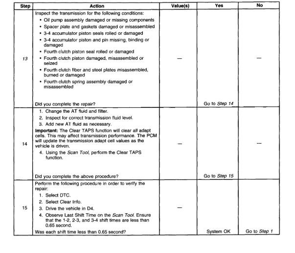

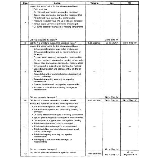

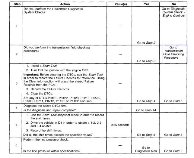

The description is below and the flow chart is there to follow.

Test Description
The numbers below refer to the step numbers on the diagnostic table.
7. This step inspects components that may cause low line pressure.
9. This step inspects or repairs components that may cause a maximum adapt and long 1-2 upshift.
11. This step inspects or repairs components that may cause a maximum adapt and long 2-3 upshift.
13. This step inspects or repairs components that may cause a maximum adapt and long 3-4 upshift.
