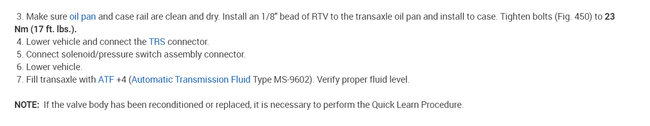

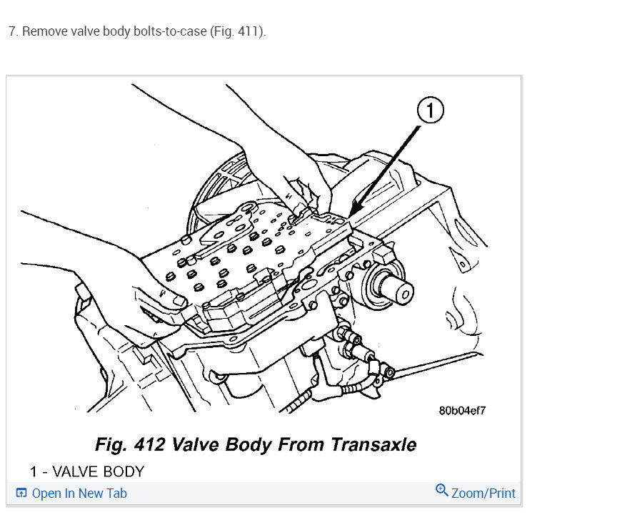

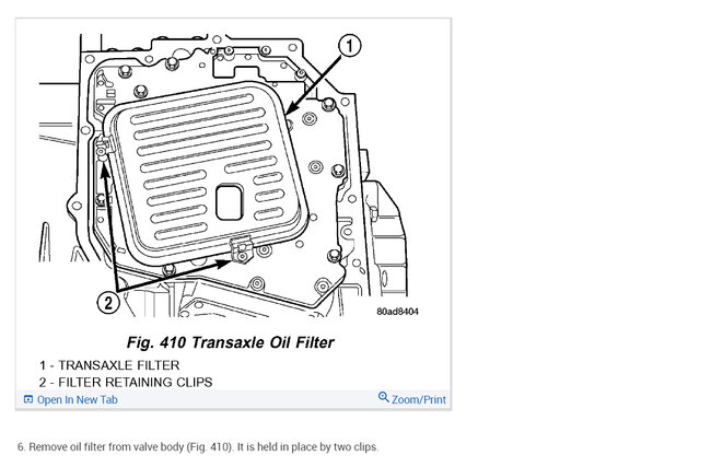

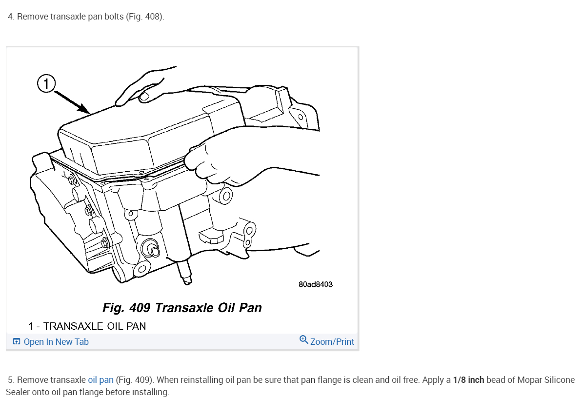

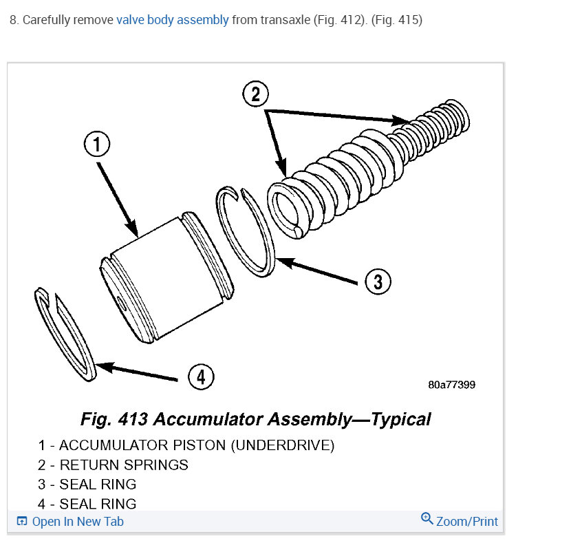

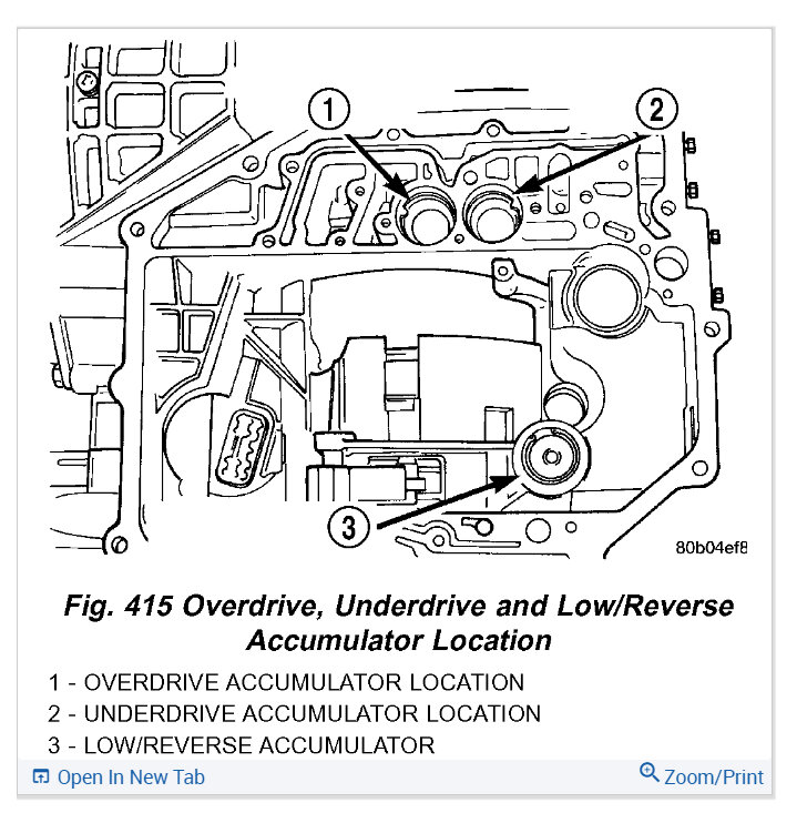

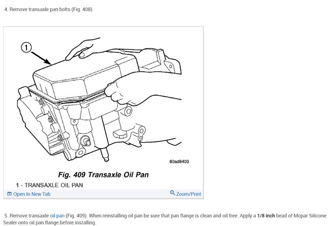

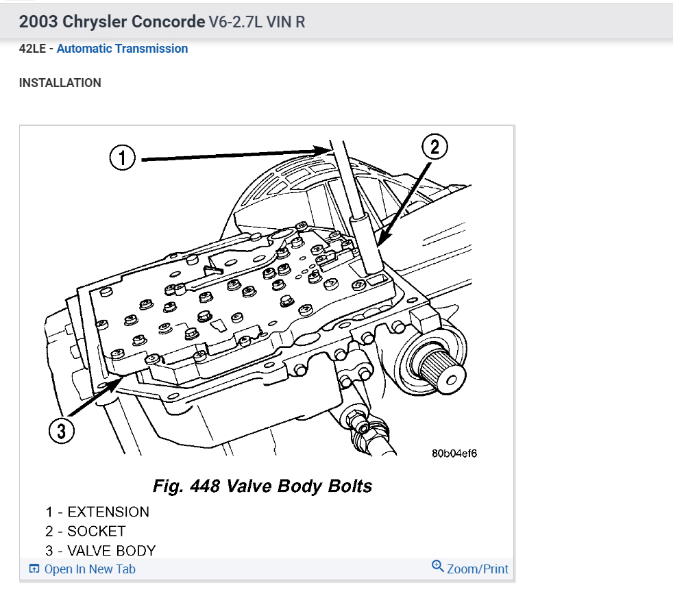

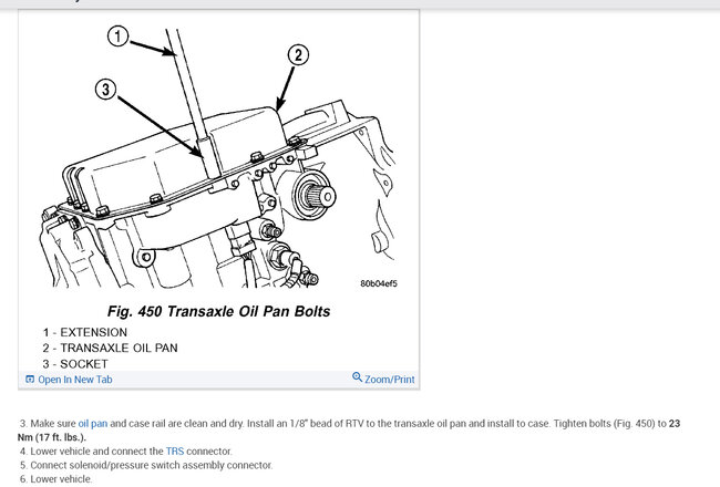

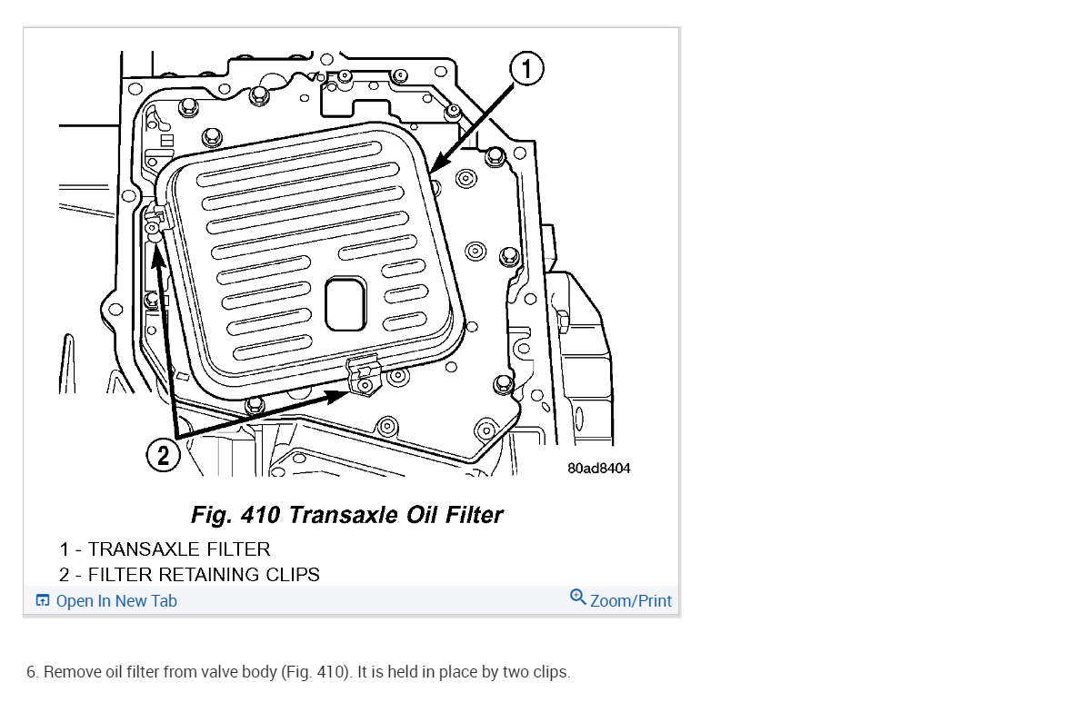

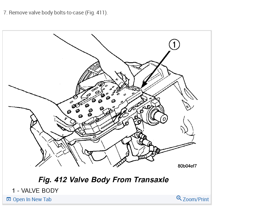

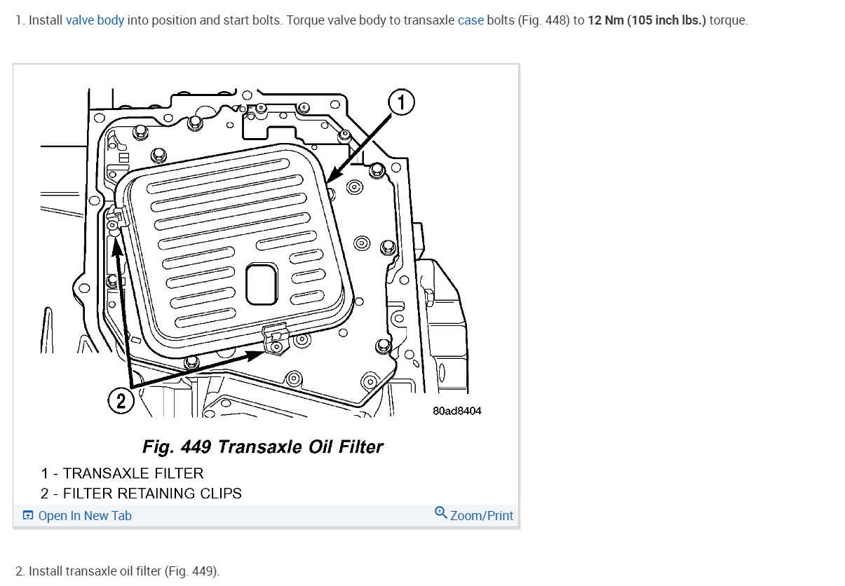

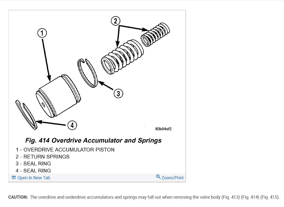

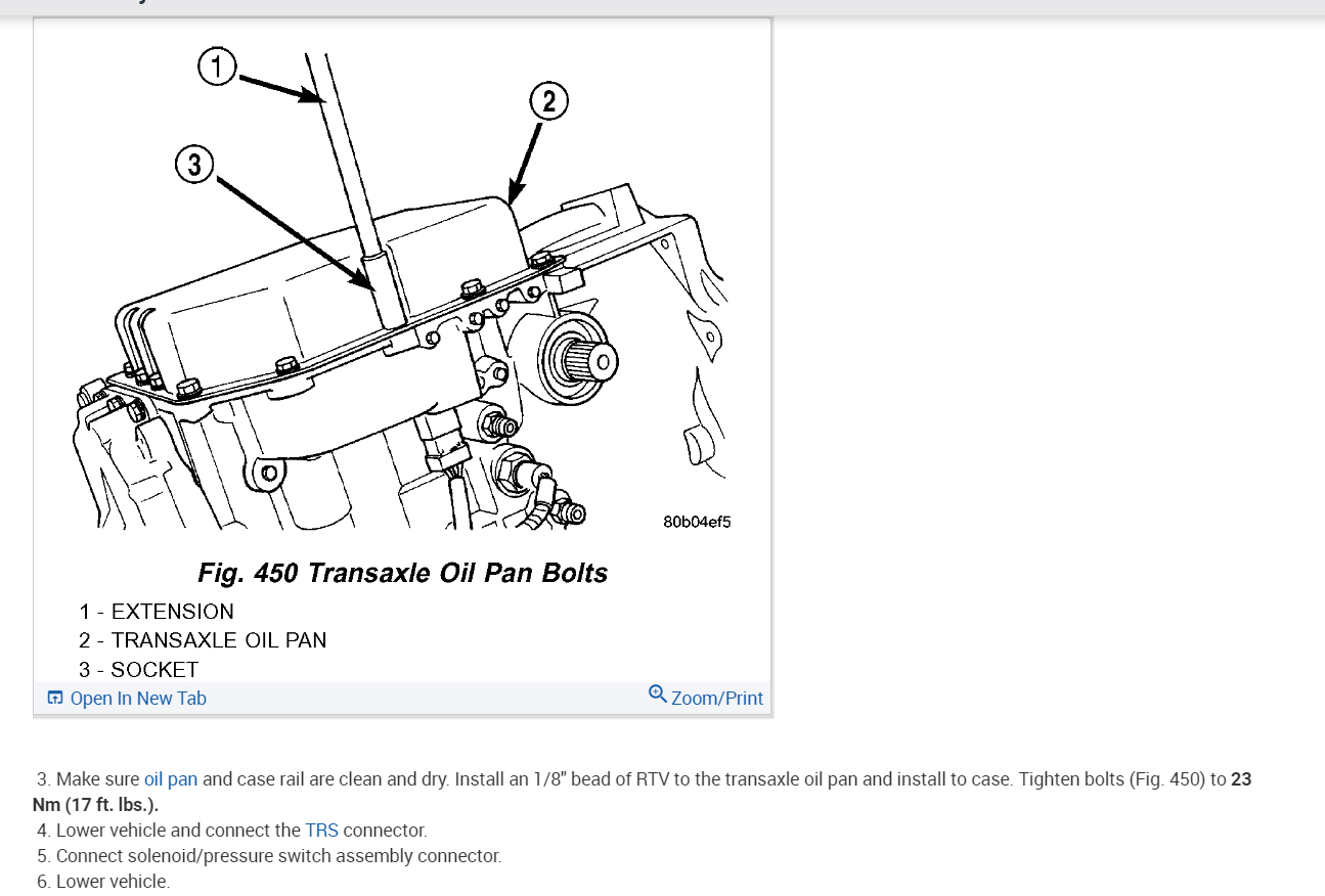

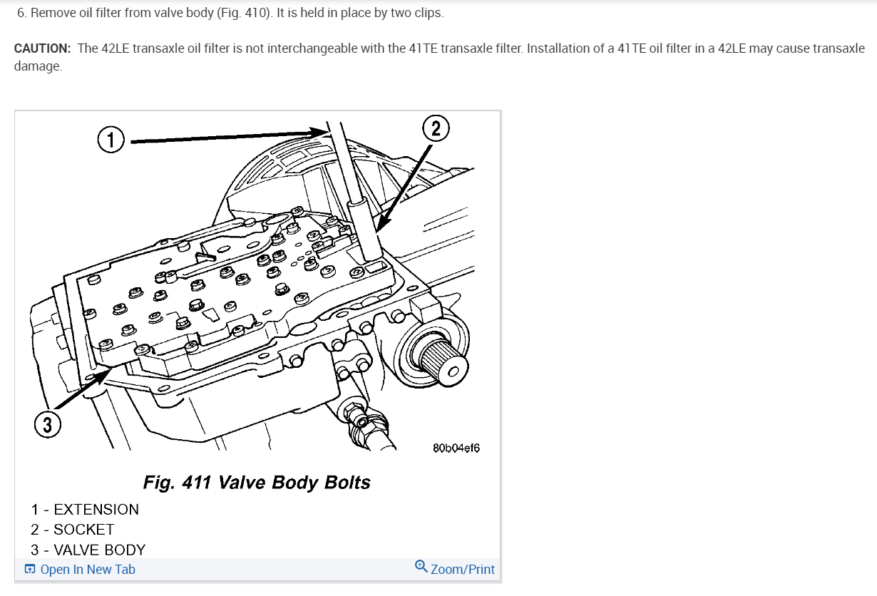

I would check the wiring and connectors and if they are okay, I would replace the valve body with a rebuilt unit. Here is how in the images below. Let us know what happens and please upload pictures or videos of the problem so we can see what's going on.

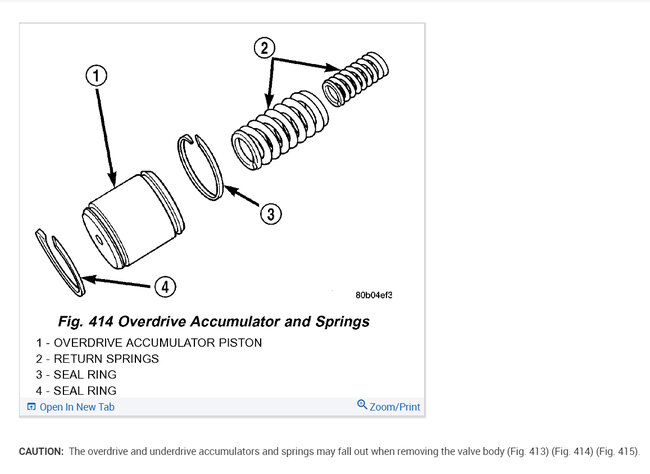

Are the springs and accumulator different sizes? Does it matter which hole of the tranny I put them back into. I don't know if the accumulator goes 1st and then the springs. Is there anywhere on the valve body those springs are supposed to sit? I've had the valve body down to replace the solenoid pack so I'm already familiar with them. I just want to double check and make sure I didn't put them back incorrectly.
Apr 30, 2023 at 5:30 PM
Yes, it does matter the springs need to not be mixed up and they need to be put back where they came out of.
