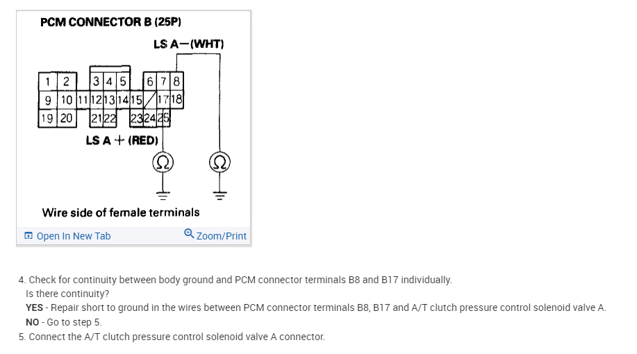

Car has slow acceleration and jerks, runs rough i would say. Transmission oil and filter/new coils/new spark plug/new MAP sensor. After installing MAP sensor P1768 came up At pressure control valve. Will changing the part fix it?
Jul 15, 2022 at 8:23 PM
Does the transmission feel as though it is slipping or shifting hard?

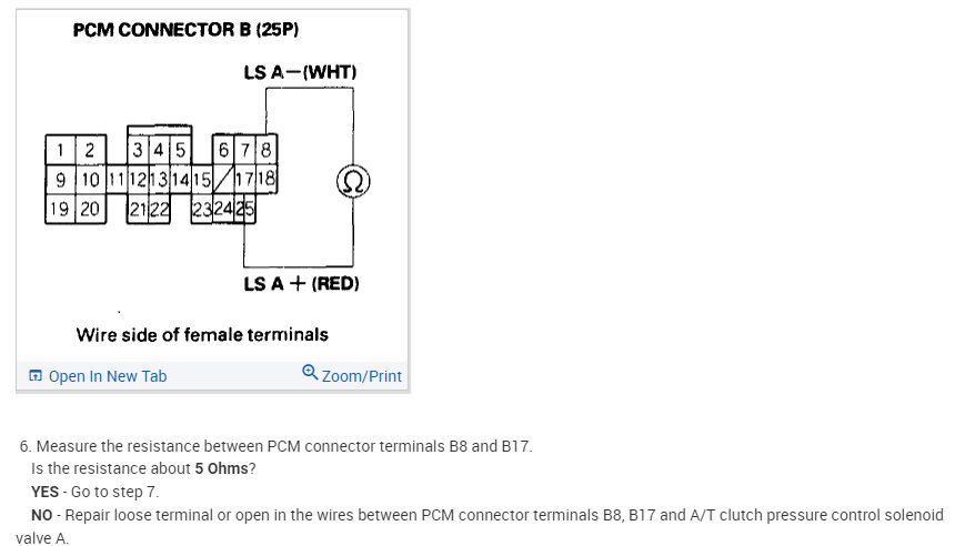

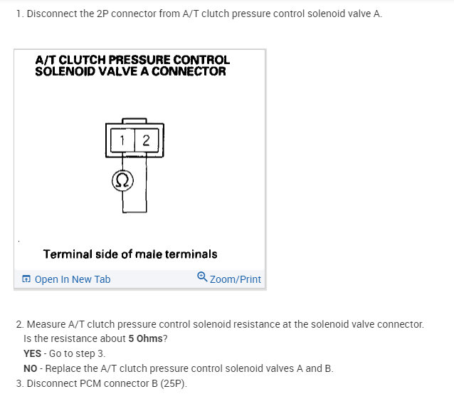

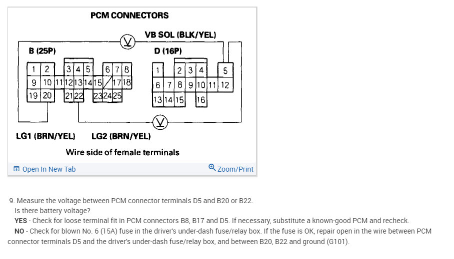

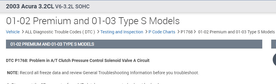

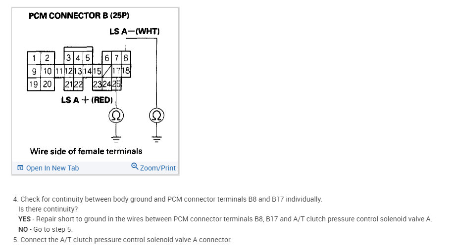

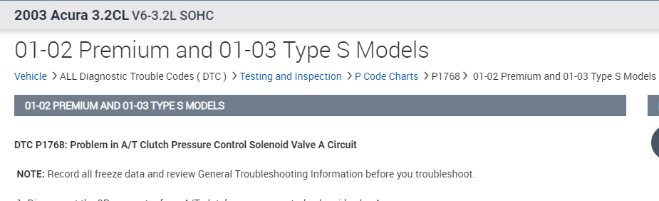

As far as your question, the only way to confirm the pressure control solenoid valve will fix it is to do a few checks. I attached the diagnostics below for you to review. Take a look through them and let me know if you are comfortable performing them.
Let me know your thoughts.
See pics below.
